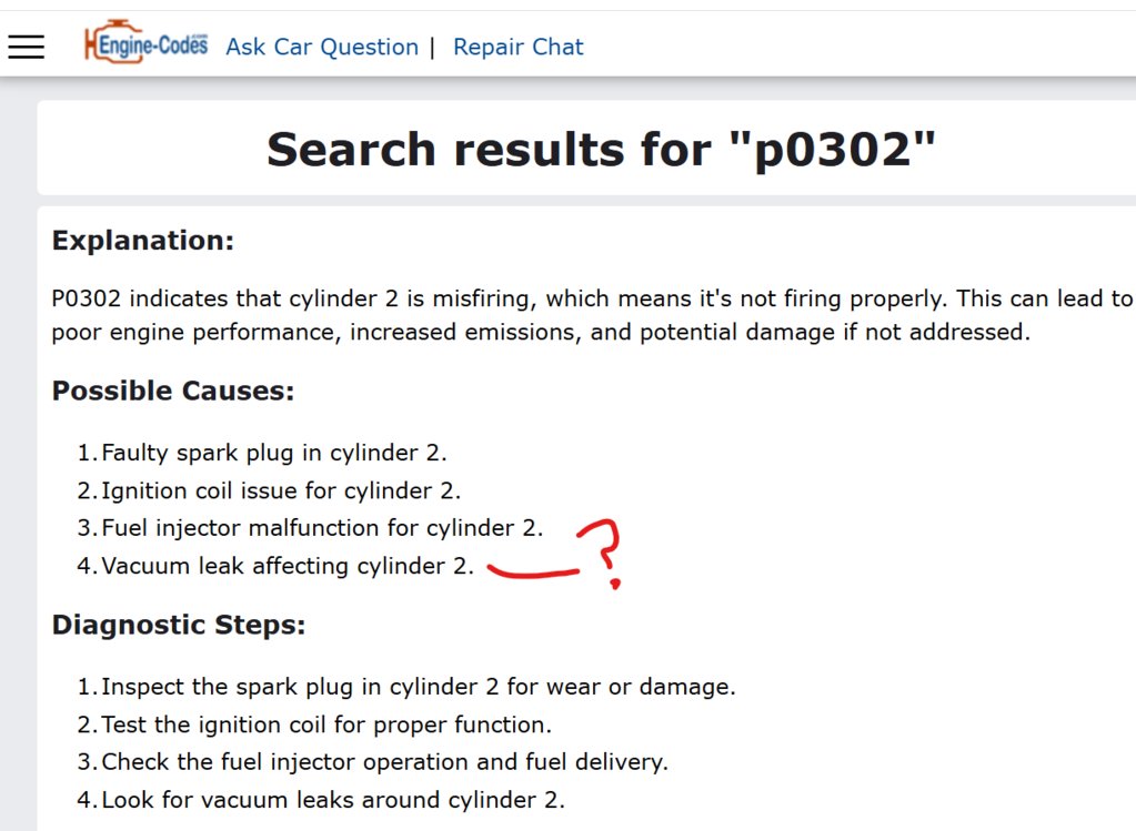

    P0302 was code?

    manifold/plenum gaskets could be checked with chlorinated brake cleaner while engine running
    (surge up or down with idle would show u leak)
    Old Silver told me about another member struggling with V leak for weeks....turned out to be a cracked injector cup
    (that was enough for me to RR all my injector cups.....when i was in there)
