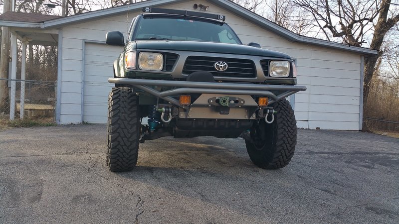

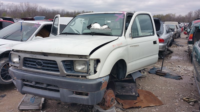

    I just took the front end off a 97 4x4 4cyl at a junkyard to do another conversion as those are my favorite grill/light on a 1st gen. I thought ony 95-97 4x4's had that front grill with the v6's getting the chrome and 4cyl getting the argent colored paint.But clearly that 5 lug in your second pic has it so ???
    The headlights are 5x7 H4's not 6x7 and don't use sealed beam as IPF http://store.arbusa.com/IPF-H4-Rectangular-Headlight-Insert-820H-P3634.aspx and Hella to name a few make great non sealed headlamps with modern optics. Literally night and day better then other 1st gen lights.
    97 in junk yard and the one I already did with IPF's on my 00

    Danny's pick and pull...lol $20 for the grill and all the headlight parts and there are a lot of small parts involved as I bought them new for my green truck.
    These from the junkyard are going on another truck.
    2 headlight buckets
    4 adjusters
    2 trim rings
    8 trim ring screws
    4 springs
    8 nylon spacers for the headlight bucket to sit on against the core support.
    The core support where the headlights sit for these are completely different so I bought left and right core support repair panels for a 95-97 4x4 on mine. Tried to do it like that write up but they sat in too far and weren't stable.
