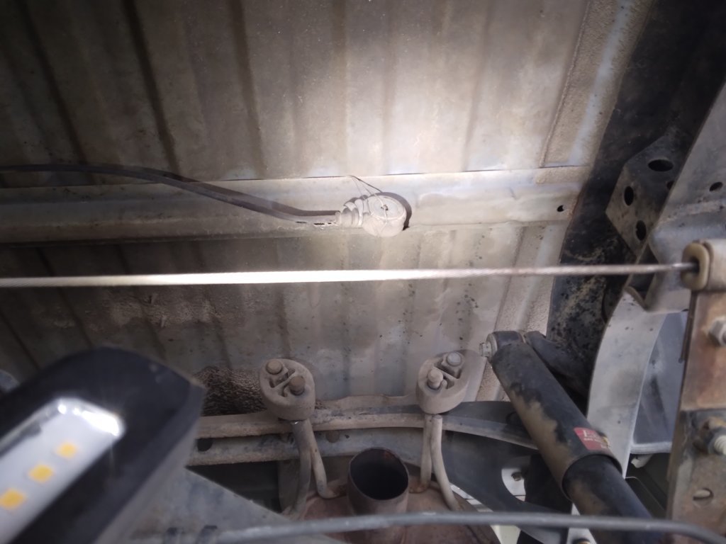

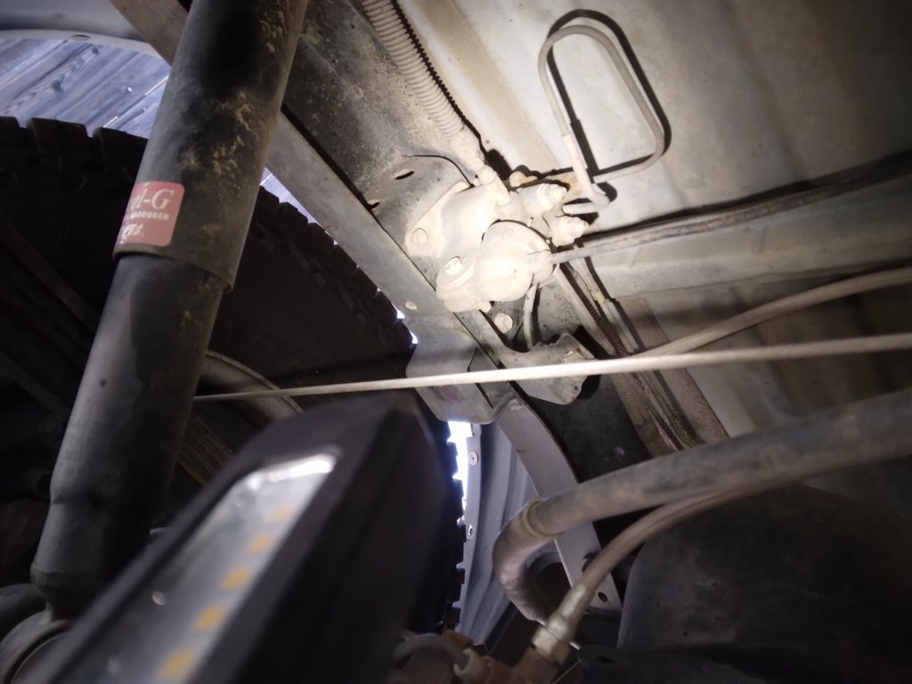

    I just picked her up ...haven't owned a 1st gen in decades ..what in heck is this piece hangning tied off for ...my rear brake lines are all hooked up ..and same with e brake ...
    Rear above axle ..hanging
    Rear above axle .. attached to frame with plumbing to rear brakes

    LSPV, that end attach to the axle housing

    Proportioning valve?

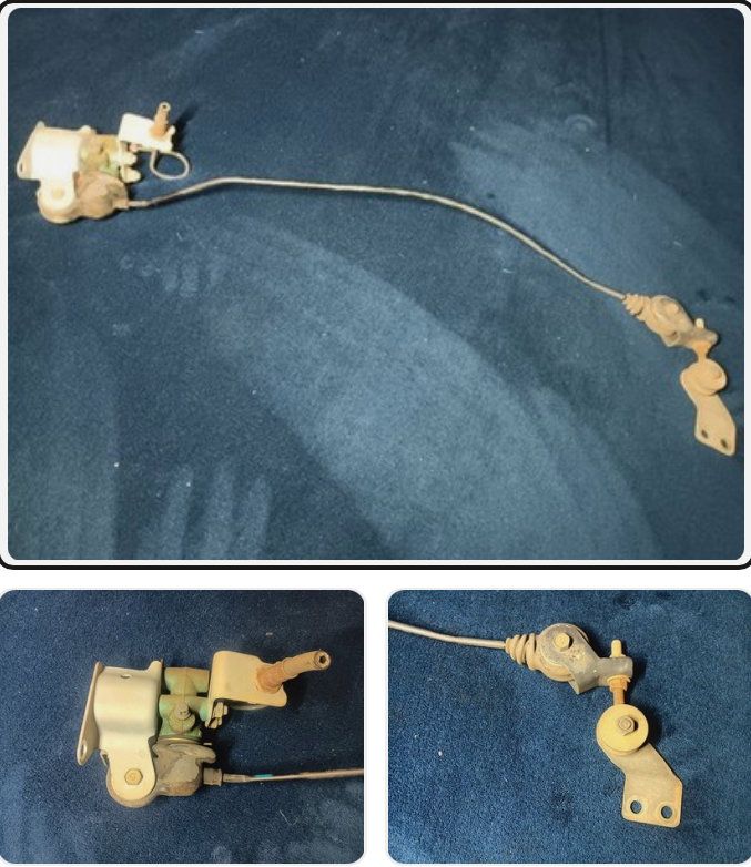

    Here’s what it looks like in its entirety. And the previous posts are correct in it being a load sensing proportioning valve
