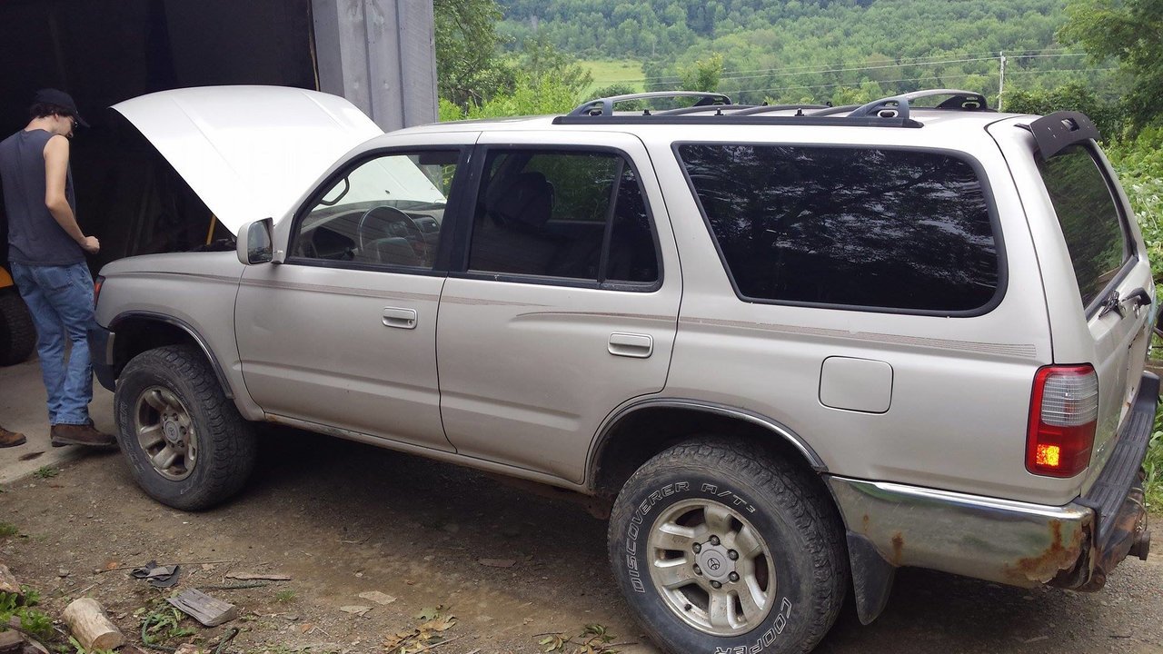

    Took a load of scrap to the junk yard and came back with this. The guy that dropped it off drove it there and said he just didnt want it anymore. We got it for $350 and drove it home that day. It has a couple misfire codes, needs tires, and shocks/struts. It has 200,000 on the 3.4 and minimal rust for NY. Hopefully the misfire codes are an easy fix, should make a good 1st vehicle for my brother.

    Sweet score...looks like ya gots a place to work/play with it!
    Well done

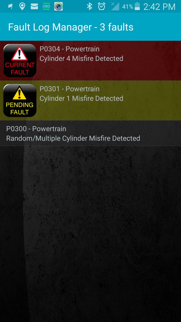

    Tried a different scanner, I think this narrows it down a little more than just a p0300 code.
  9. Aug 5, 2017 at 12:55 PM
    TeecoTaco
    TeecoTaco Liberty Biberty
    Feb 26, 2017
    #211739
    10,991
    SW Ontario
    16 Taco DCSB TRD Sport 6MT
    Modified the level of gas in the tank
    Well there ya go...pull 1 and 4 injectors and ohm test. Cool
