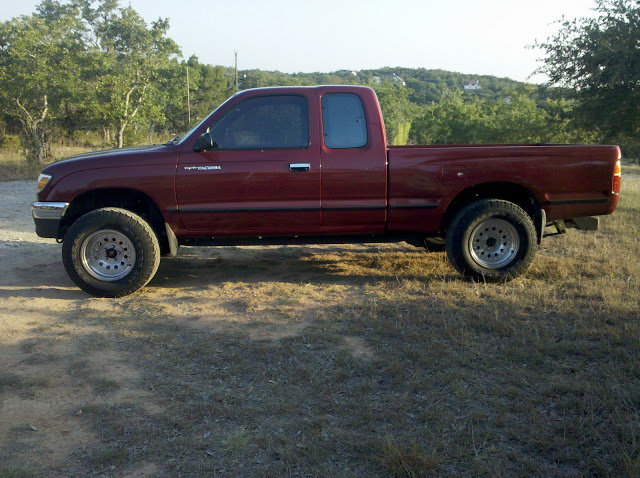

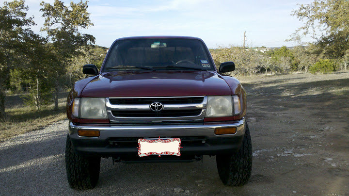

    Hey guys, so here is my 2wd 5 lug build. The background, this was my FIRST car, my dad bought it for me back in 1997, I had it for 6 months when he gave it to my sister. Until June of 2011, it has been driven very little and garage kept by my sister and dad, and after building up a chevy long travel for the past 10 yrs, I thought it would be nice to have a smaller, less aggressive truck to get around town in. Some of the complaints we had with this truck was, with the V6 motor, and 215/70/14 tires, it would spin out on wet or dry pavement, and around every corner. So the project plan was so give it some lift, to clear some tires big enough to keep this thing from sliding around in bad weather, and stop getting compliments like, "cute truck". :eek:
    I mainly took progress photos to answer a lot of the common questions I found people asking about lifting a 5 lug, so I hope this helps.
    here's me when I was 17 and the truck was brand new.

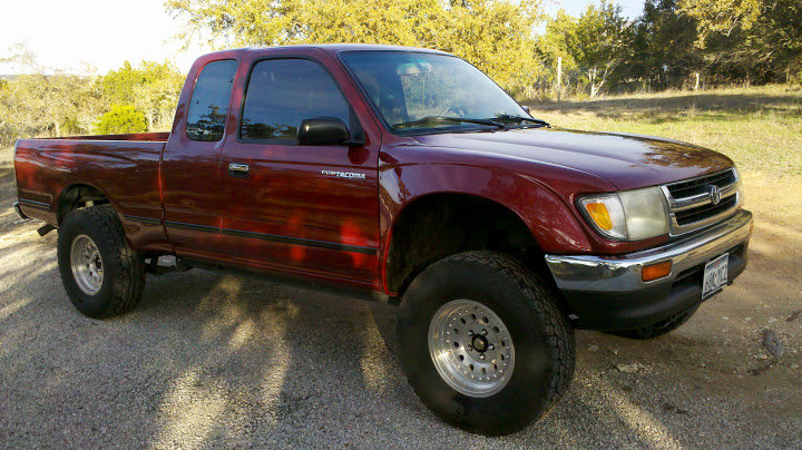

    Skip the build, this is the project currently:
    Current build includes:
    3" Fabtech Spindles
    Fabtech Add-a-Leaf
    Bilstein Heavy Duty Shocks
    Glassworx fenders
    2" body lift from 4crawler
    31x10.5 Falken on 15x7 wheels w/3.75 backspacing

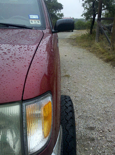

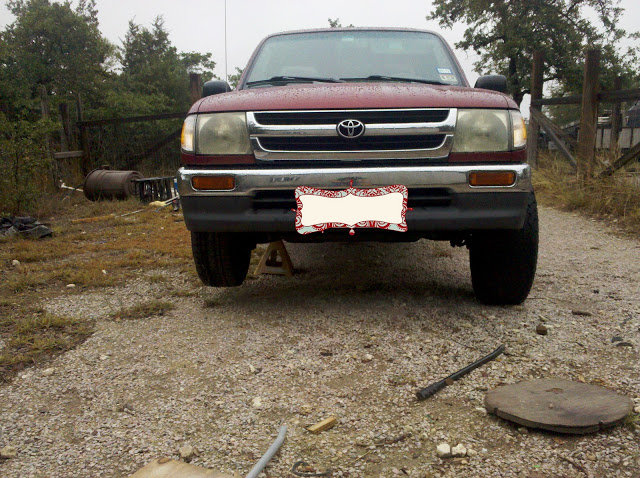

    My first set of tires were a used set of 30x9.5 General Grabbers that I found on Craigslist already mounted to 15x7 rims. Here is the spindle lift with the 30's compared to the stock spindle with 215/70/14
    Here's how much wider the spindle + 3.5" backspacing is.

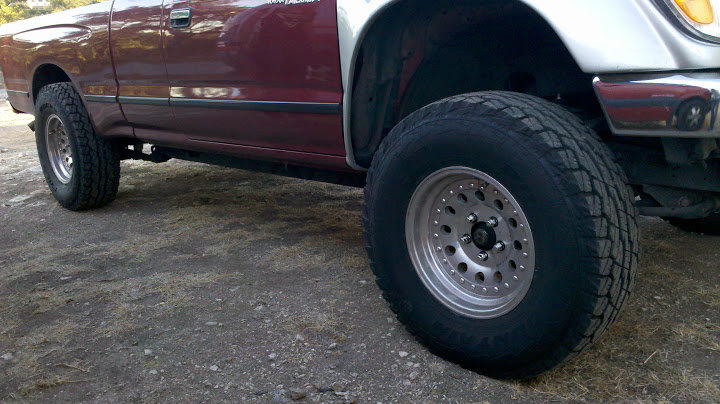

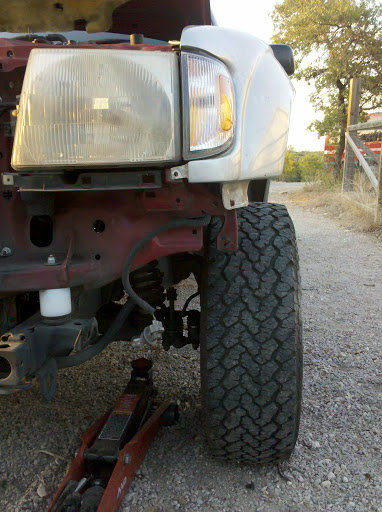

    I started with a rear shackle lift, here is the finished spindle + shackles + 30x9.5. Rear shackles was straight forward, the tailpipe did not get in the way like some other threads posted, but this seems to vary. Clearance was ok, tires would not rub at full turn, but hitting a bump and turning did rub. I did trim the plastic off the bumper. I think the rubbing came from the mud flap on the front fenders. I could have taken them off and done the pinch weld mod, but then there'd be no excuse to keep lifting!

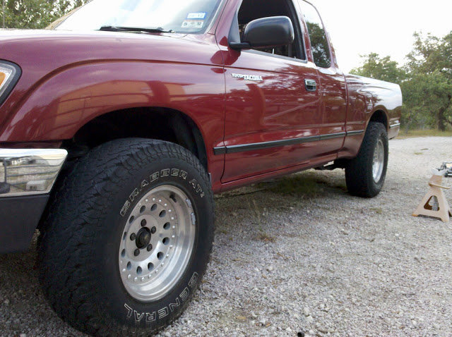

    So to get a little more wheel travel without rubbing, and I liked the look of a slightly exposed frame, I put a 2" body lift on it. Here's a progress shot to see the diff from the front to rear, and finished. With the body lift the 30x9.5's cleared with no problem, even with the mud flaps and no pinch weld mods. I think because of the backspacing, I needed more room, with a stock backspacing, this would have not been an issue with just the spindle lift. The negative offset of the wheels makes the tire move slightly more forward and backward when at full steer.
    At this point I thought I was done, but then I came across a pair of fiberworx fenders for my year model on craigslist. I have seen zero fiberglass fenders driving around town, and the odds of one for sale that fit my body is rare, so I jumped on the occasion, and the price was cheaper than a set of fender flares. Here's how much the fenders cover up the track width.
    I also been mocking up a tube bumper, but that is not finished
    With the fiberglass in, I realized I could go a little bigger on tires. 31's fit great no rubbing, 32's might have been running it close again with the hard bump at full steer, so I decided on the 31's and help my mpgs. I ended up spraying undercoating where the stock fenders and plastic liners covered up the inner fenders and pulling all the mud flaps off. Also, for the bumper to fit the new fender width, I pulled the bumper out to fit the flare by notching the inside corner a bit.
    In the end I swapped out the shackles for an add-a-leaf, the rear was too soft, with 2 dog crates and 2 labs, it looked like I was hauling bricks. I installed the AAL with the shackle still on, and my shock was too short, so I took out the shackle for now. It looks like a perfectly level ride. With the shackle + AAL, it was sitting a tad tall in the rear. If the springs sag, I'll add it back in and do something about longer shocks.
