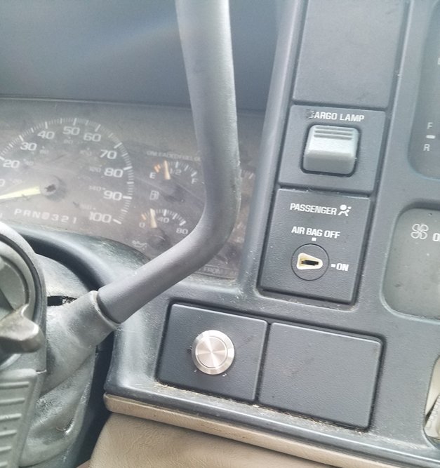

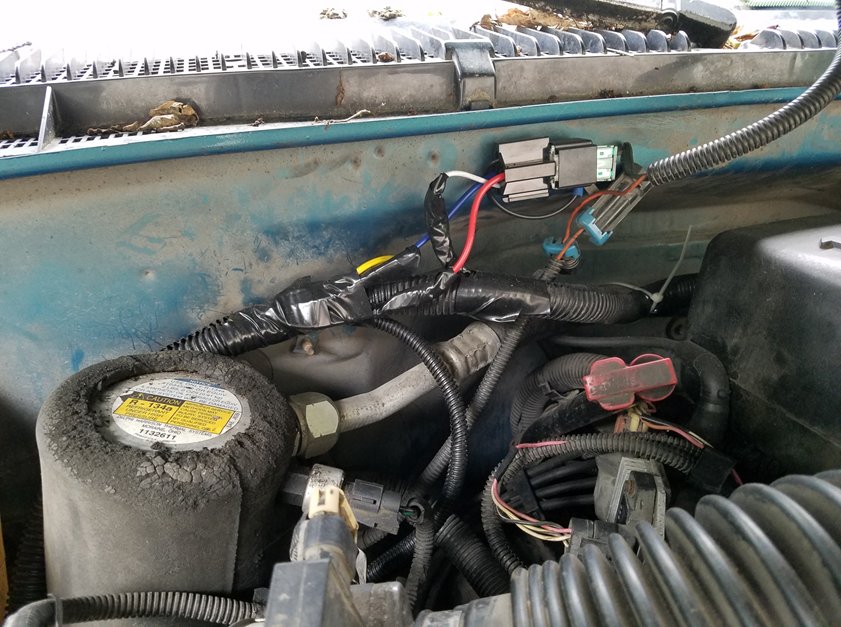

    I decided to try to McGuiver it instead of buying the harness. Long story short, I ran a few new wires and added a push button start. I have about $20 in materials in it and it works fine. If you do this type repair, make sure to use a momentary style switch. Standard fused relay from a box of 10 of them I bought off Amazon.
    I tapped a wire in the steering column since I had it open. It is only +12v when the key is set to run. Don't use a wire that's always energized, in case the starter solenoid malfunctioned and would not disengage. You'd be unable to cut power. I ran a new trigger and a high amp wires off the relay down to the starter.
    Just wanted to pass this along since it may be applicable to other vehicles with such a condition. Hey, all the new vehicles are going "Push to Start", so I'll just call this an upgrade, not a "cheap alternative"!
