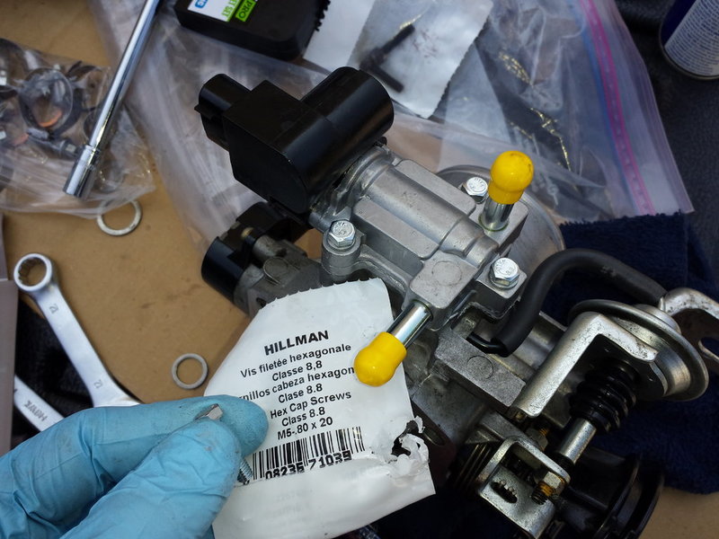

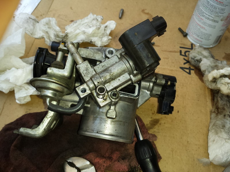

    I dealt with this exact issue with the IAC. I used some channellocks to get the two i could grip off. The last one that you cant grip, just turn the whole housing to get to it. I replaced them with M5x20 screws, as well as a lock washer.
