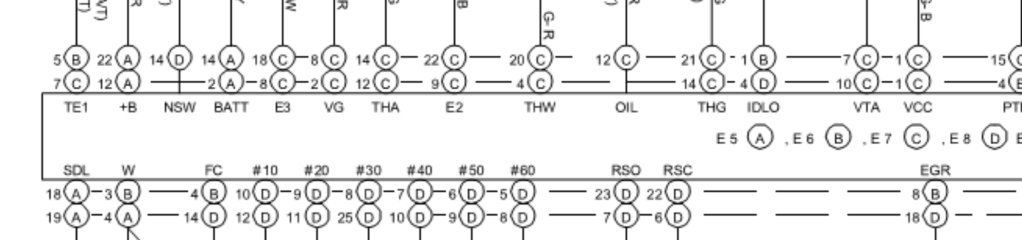

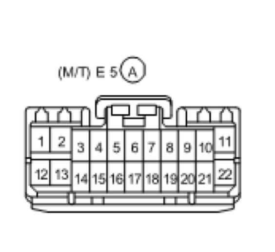

    You need to see if you have power to the E5 connector.
    Pins 2 (black/yellow) and 12 (White/Red)
    Just because you can, check that EFI fuse again.
    Male sure it hasn’t blown again.
    @Glamisman can confirm.

    there is no no power and the efi fuse blew again. does this mean there are wires touching eachother somewhere? before this i put the old tps back in to take away variables.

    update: i was using the new meter wrong, yes i am reading a solid 12 volts from those 2 pins
  13. Feb 16, 2025 at 10:08 AM
    TnShooter
    TnShooter The TacomaWorld Stray
    Sep 2, 2010
    #42625
    21,358
    Deogee
    07' TRD Off-Road, Auto
    STOCK
    The pins at the ECU?
  14. Feb 16, 2025 at 10:11 AM
    407andy
    407andy [OP] Active Member
    Oct 20, 2024
    #459089
    28
    yes sir.

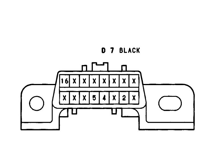

    Ok. Lets check the OBDII connector.
    Just to get a couple power/grounds out of the way.
    On your meter.
    Check between pins:
    16 and 4
    And 16 and 5
    You should see 12v with the key ON.
    So, Red lead on pin 16.
    And Black on 4 and then 5.
    Be careful. Don't jam the leads in to hard or far.
    We don't want to bend the pins. You might use a small piece of wire to help if needed. (paper clip...)
  19. Feb 16, 2025 at 4:00 PM
    #19
    407andy
    Oct 20, 2024
    #459089
    28
    both 4 and 5 read 12 volts
    TnShooter[QUOTED] likes this.
