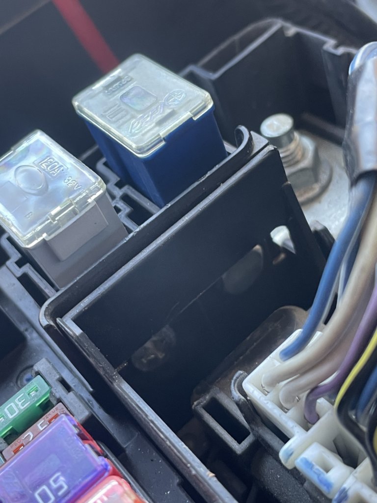

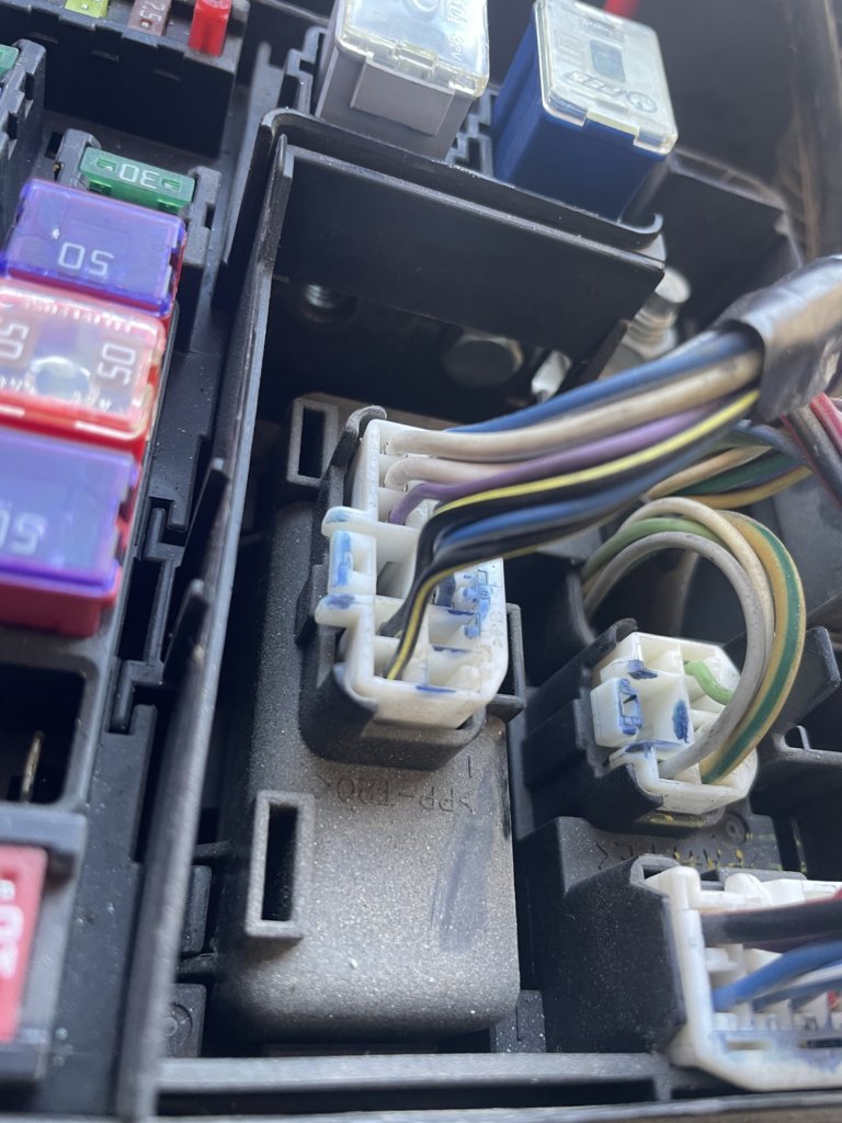

    I was getting same issues and was looking for months first I fixed a ground right by the box on the side wall and that solved issue but then out of nowhere it wouldn't start again... I looked all weekend and figured out it was a bolt missing on main power hope this helps picture is with new bolt and other is missing :)
