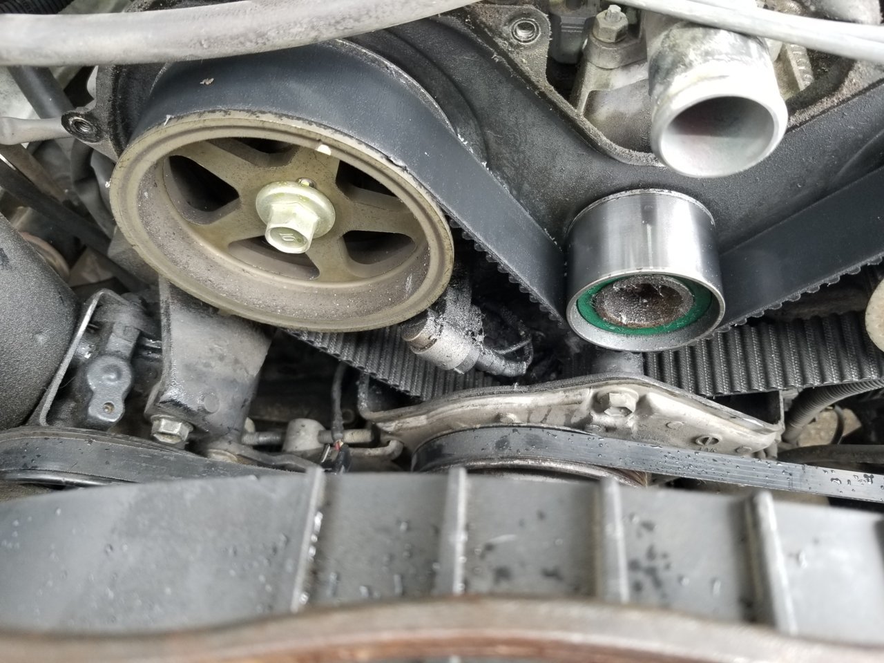

    timing belt slipped...

    You could check the timing marks on the cams and crank easily now that there’s no coolant in the engine. Removing the fan can make it easier to do. Get familiar with @Timmah! ’s channel on maintenance. You get a good amount of info for free. Watch this 2 part series until it gets to the way to check the timing.
    https://youtu.be/vHC46ypHxWc
    https://youtu.be/mErd7xoBS9I
    This is a series for changing a head on the engine which also will show you how to check timing marks. There’s six of them. Part 5 is where he puts the timing belt on. You’d learn a lot from the 5 hours of videos I’m linking.
    https://youtu.be/voLBRDZL9f
    https://youtu.be/in4VdfnHdI0
    https://youtu.be/yTsocmNdBpQ
    https://youtu.be/nFYEoWTX0YU
    https://youtu.be/iQ7-wmjo6PE
    https://youtu.be/5ysgDyea1GU
    A redo on the compression test wouldn’t be a bad idea.

    I second the check of the timing belt. If it is jumped that is unusuall unless it was a high mileage belt. The picture of your belt I find it a little concerning. All of that frayed stuff on the cam position sensor is timing belt material mixed with oil... is that "new" debris or did they not clean the the front of the motor when they put the new belt on?

    I will try the compression test again and check for tdc with cam and crank.

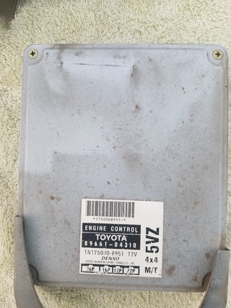

    I feel like If i do it right i need to learn how to get the obd2 and ECU working with the engine properly. If I put a good engine in there and wire it properly, that might be a good start to correct this nightmare.
    As for Wyoming 09 response, The mechanic up North checked the engine code and it was like a p0340 code, I think. When I got back home the engine light went off and now i cant check the code, nothing shows up(no codes or live engine stats)... that's probably the most frustrating part. I didn't notice much drop in gas mileage but I was consistently getting 13mpg which was disappointing but I blamed it on the fat tires.
    I'm shopping for a good 97 engine if anyone has ideas. I have a hookup with LKQ that can get me a used one for 1000$ and 6 month warranty. :/

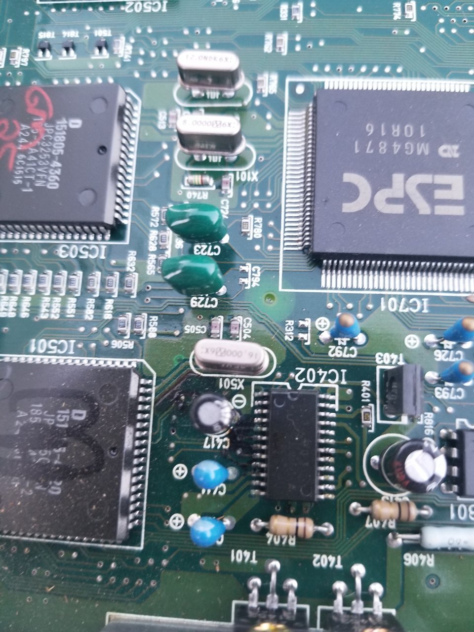

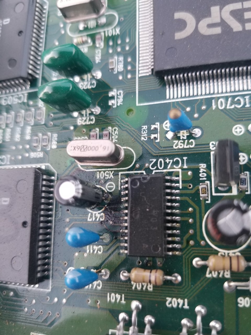

    Found this capacitor issue on my ecu. C417. I guess I'll get another computer and try that. Maybe it will help with running the diagnostic. Not a lot shows up when equipment is hooked up to it

    @16tacoguy I AM STILL in the process. I just ordered a new ECM from a place in California called ToyAuto Mart. Seemed trustworthy and had my part.(nevermind, just called me back and said it wasn't the right part and waiting for a refund...) Called Napa Auto parts and they are no help with 97 tacomas. Apparently they want nothing to do with it along with every other AUTO SHOP due to the age. And noone can recommend an ECM repair company. Internet results came up with FS1(flagship one) and some other mixed review repair companies. Does anyone have any luck with that? I would still like to repair my existing one or sell it to someone to fix. I think im going to go with FLagship one even though i've heard such mixed reviews. Most Car Shops use them and get good products from what I've heard.. *Cross fingers*

    You may not need an ECM repair shop, look for a place that fixes computers (I don't mean installs software) and other digital gear. There's a good chance that once the magic smoke escaped from the capacitor, everything else was left unharmed. If you replace the capacitor and repair the burned traces, you could be back in business. With a little bit of studying at YouTube U, and a hundred dollars worth of tools, you could even do this on your kitchen table.

    Yea i called them and they only deal with Rav-4's for toyota... Also talked to circuit board person and they are afraid that its not just the capacitor and tracks but that big Chip that has the burnt stuff next to it. If that has to be replaced then i would need reprogramming... Which brings me back to square One. I think im gonna call around to a bunch of Toyota Dealerships and see if any can help. The 2 I have called said they dont fool with stuff that old...(no respect for the elder cars). And then last Option is calling Flagship One and hoping they dont scam me.
