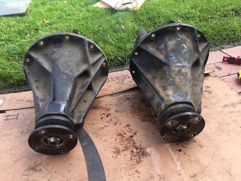

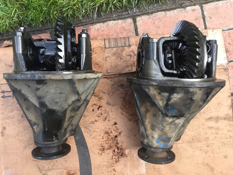

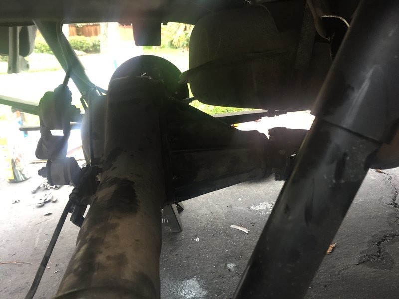

    Now that the truck was a bit higher I needed a new set of rubber. I decided on 235/75r15 (29") but I didn't want to lose drive ability so I needed to regear. According to tire size/gear ratio chart I needed a set of 3.73 gears. The problem is there's a very limited selection of Toyota 7.5 gears... but after searching I found a post about how Toyota Previa rear ends were the same. The previas come in two flavors naturally aspirated with 4.3:1 or supercharged 3.7:1. So I hit the yards and got a 3.73 previa third member for $60 and hoped it fit.
    Today I successfully installed the previa third member! I was worried because there was no definitive install, but the pinion flange fits and the spider gear spline count (27 splines) is the same.
    Tacoma third left, previa third on right

    Start by draining the stinky diff fluid...
    1. Remove driveshaft 14mm socket on breaker bar to loosen
    2. 4 14mm nuts on each axle/backing plate; disconnect brake lines.

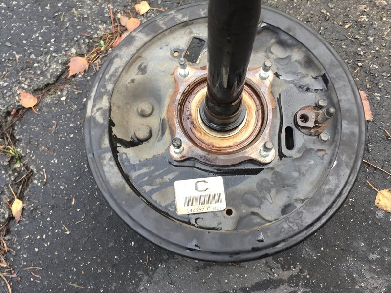

    3. Remove axles
    4. Loosen & remove all third member nuts 12mm
    5. Clean third member gasket surface and insert new gasket.

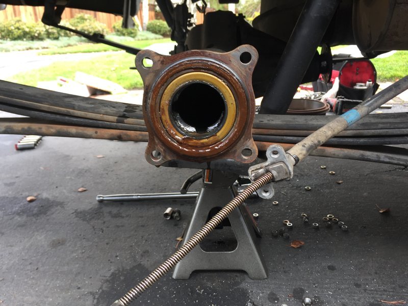

    6.Remove&Replace third member.

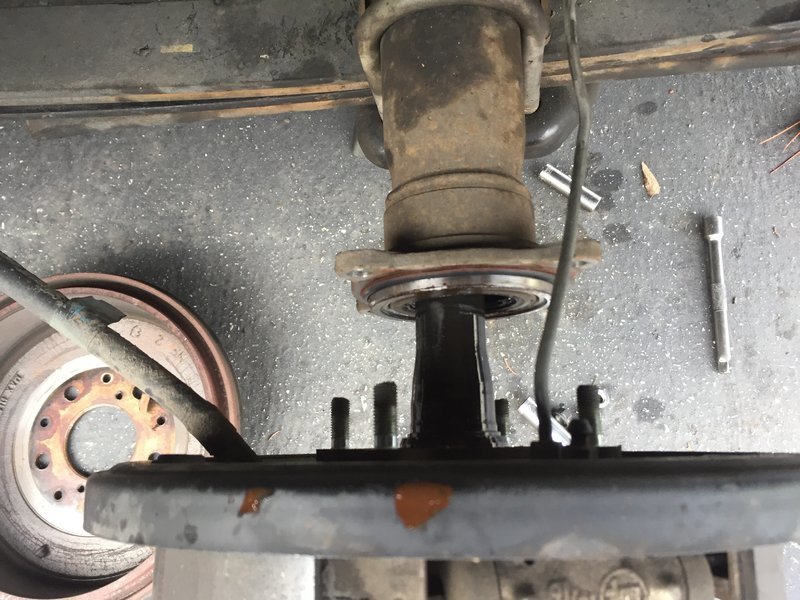

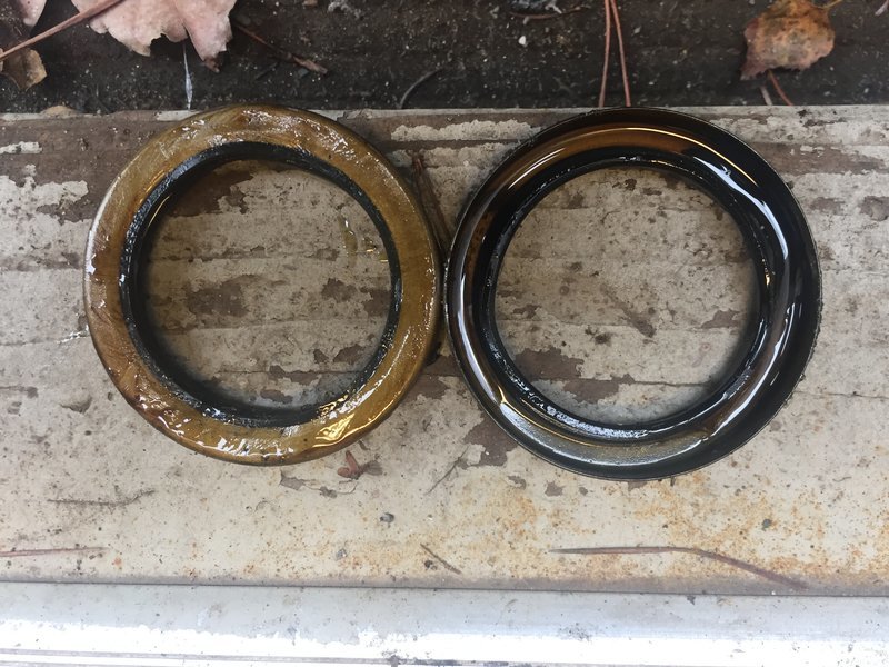

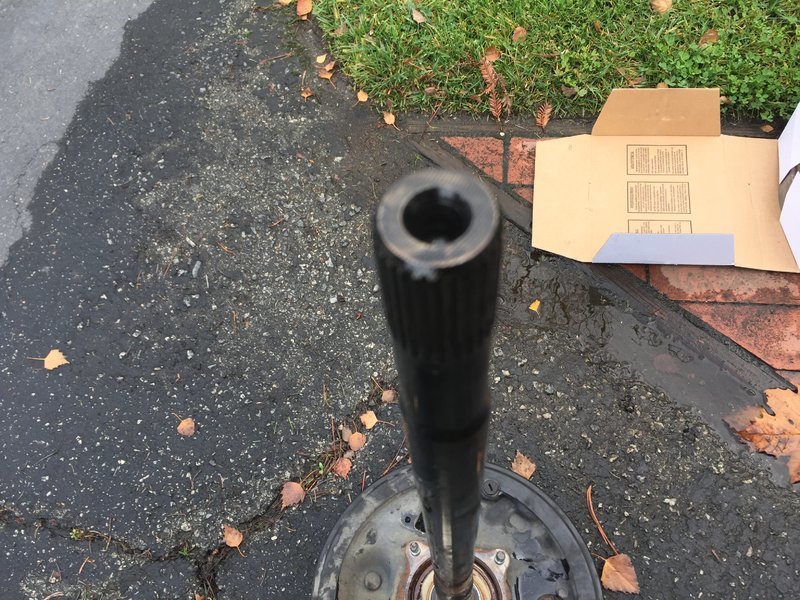

    7. Inner wheel seals both sides
    IMG_0921.jpg Both of the old seals
    8. Clean and reinsert axle shafts (I reused the outer o ring)
    9. I tighten the third member nuts in a star pattern to distribut the load evenly and did the same for the axle backing plate nuts
    10. Refill! I used 75w90 Mobil 1 synthetic and have no complaints--good stuff.

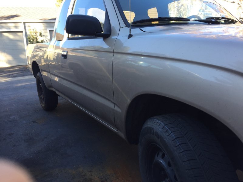

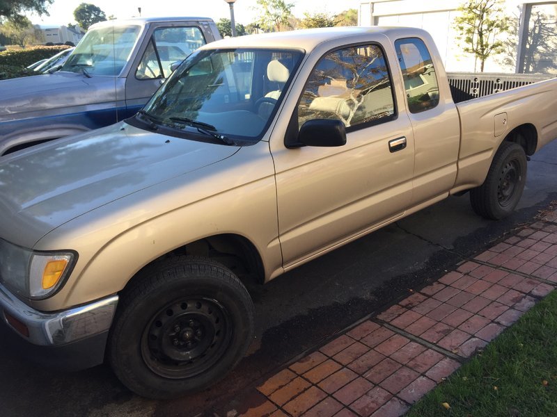

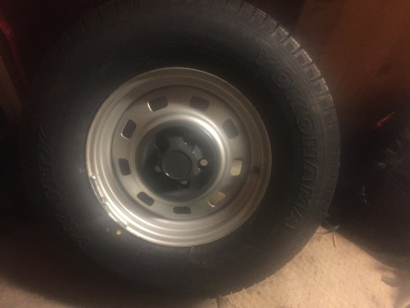

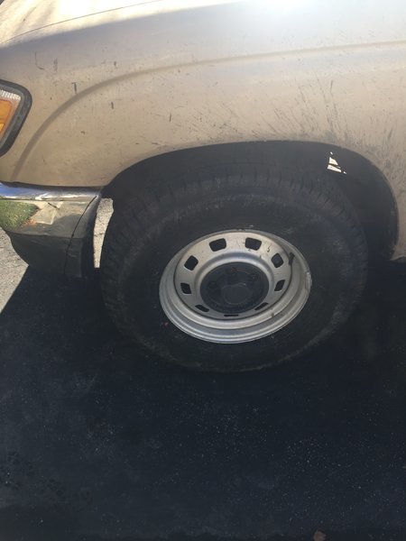

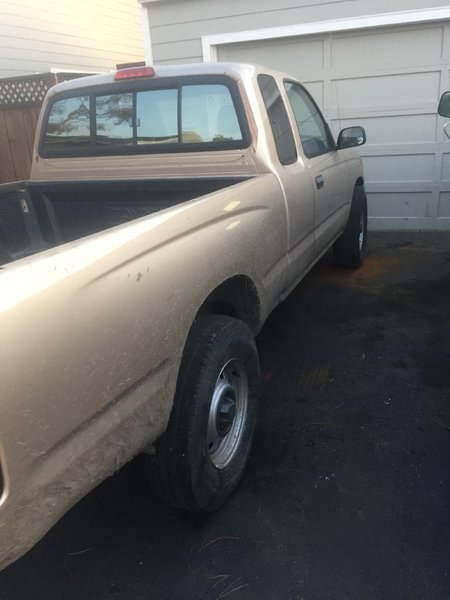

    Some pics of how the truck used to sit on 215/70r15...

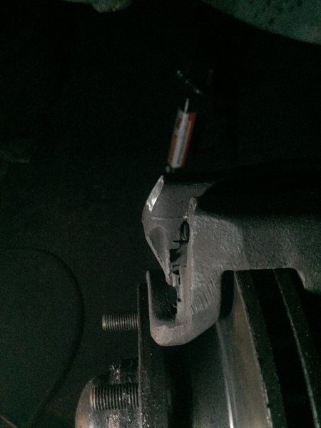

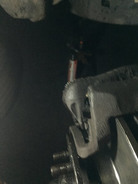

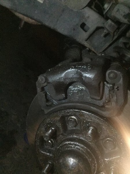

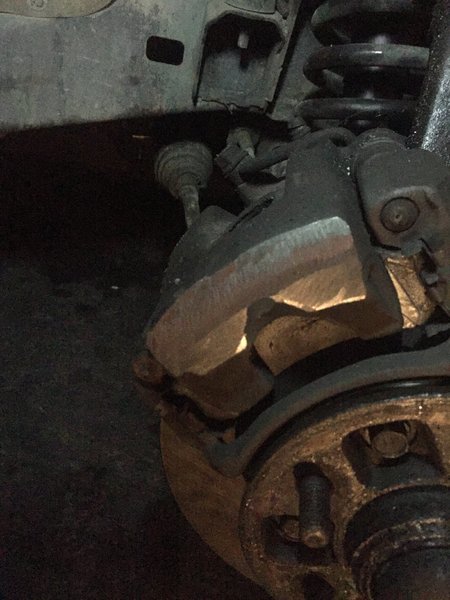

    My new wheels are a set of jeep spare wheels. It's a 15x6 wheel with 38mm offset (same as stock 5 lug of this generation) so the wheel would mount and look the same as my stock wheels. The problem I had was that they're shaped a little differently and had brake clearencing issues in both the front and rear. I had to grind the outside of the caliper for clear in the front and I got a 1" wheel adapter for the rear. The wheel adapter also served the purpose of evening out the look of the rear track.
    Some pics of the stock caliper!
    Grind away babé
    I didn't feel that it weakened the part baised on the location and amount of grinding. I ended up with about 3/16" clearance which is fine.
    New wheel: jeep spare (painted hubcap dark gray) w/235/75r15 Yokohama yk thx all season tires.

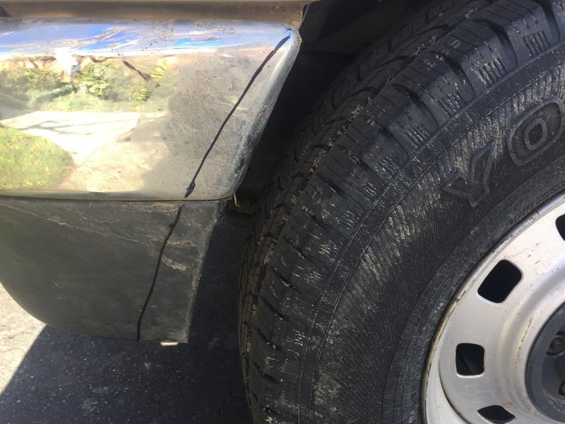

    I initially trimmed the front bumper valence to fit the wheels but I trimmed a little more to not rub and equal space
    Before
    Cut with an angle grinder off my line. My line was drawn by eye and not measured in any way--just what looked right.

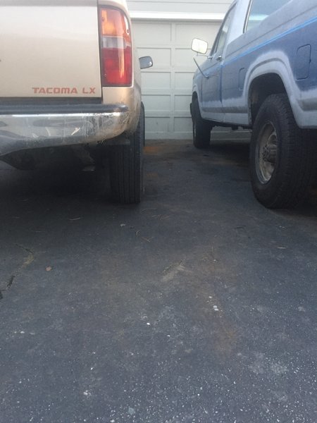

    Photos to show how in line the rears are to the fronts

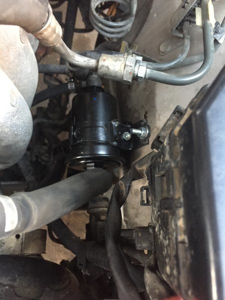

    Completed a diff breather relocation and fuel filter relocation.
    Diff breather fittings:
    1- 1/8mnpt x 1/4 barb
    1- 1/8 npt coupling
    1- 1/8 fnpt x 1/4 barb 90
    2-3' 1/4 fuel line
    Fuel filter relocation was a pain. The hardest part was getting the old filter out, hence why the mod. I'm not going to go into detail, there's already been a great write up in the custom tacos technical articles.
