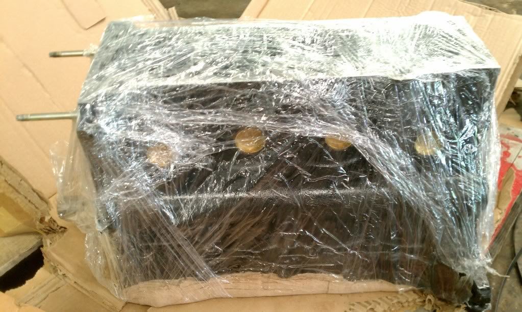

    Engine block has arrived! Now all I need is the cylinder head and I will be ready for assembly! Paint should be arriving in the next few days as well. We are building our own custom paint booth. It will be 16' wide by 20' long, complete with ventilation and sealed up tight as fort Knox against dust!IMAG0130_e5cb840d432370f691a142d979d7c477f2206762.jpg

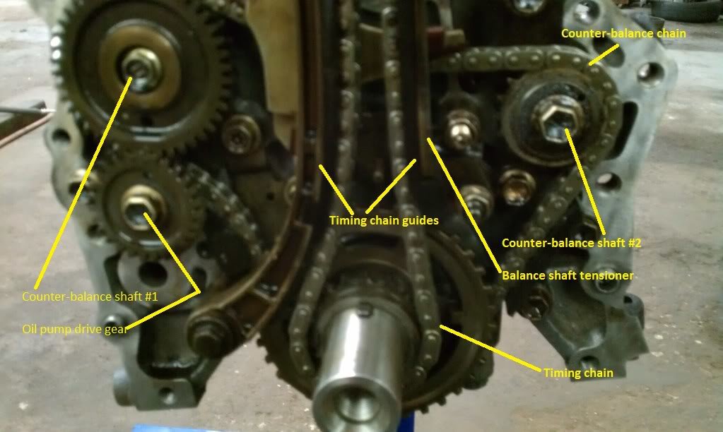

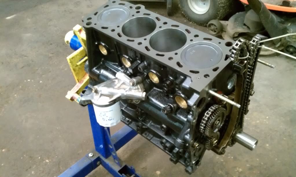

    Engine assembly has begun! As you can see from the below photos, this 2.7l engine does not have just a simple timing chain set up. It uses 2 balancing shafts to help reduce engine vibration. 4 cylinder engines over the years have been known to have a pretty serious engine vibration, and without these counter-balance shafts, it would not make for a comfortable or quiet ride. The two shafts must be installed with the engine #1 cylinder at TDC or Top Dead Center of it's stroke. Since the head is not installed, you do not have to concern yourself with "compression" or exhaust stroke.
    Both shafts were installed with the counter-weights on the bottom, and the balance shafts' chain installed properly. Then the tensioner (located in the middle, above the crankshaft) was installed and adjusted.
    After this the timing chain for the twin camshafts was installed on the proper tooth of the crankshaft, and zip-tied to the chain guides. This was done because the timing cover has to be installed before the cylinder head is installed, and it prevents the chain from accidentally slipping off the crank gear, resulting in camshafts being out of time, and possibly damaging your engine.
    Next up, Cylinder head assembly to include valve seals, valves, springs, and keepers!
