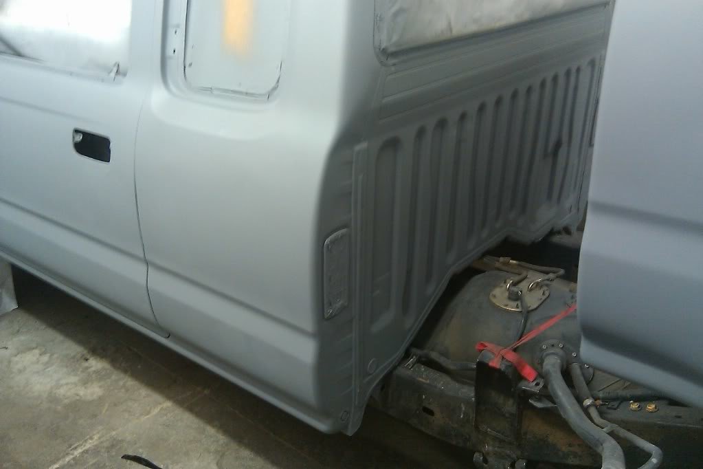

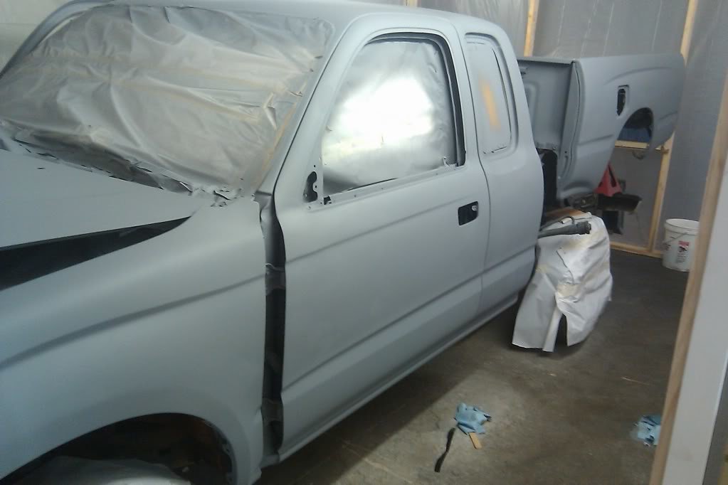

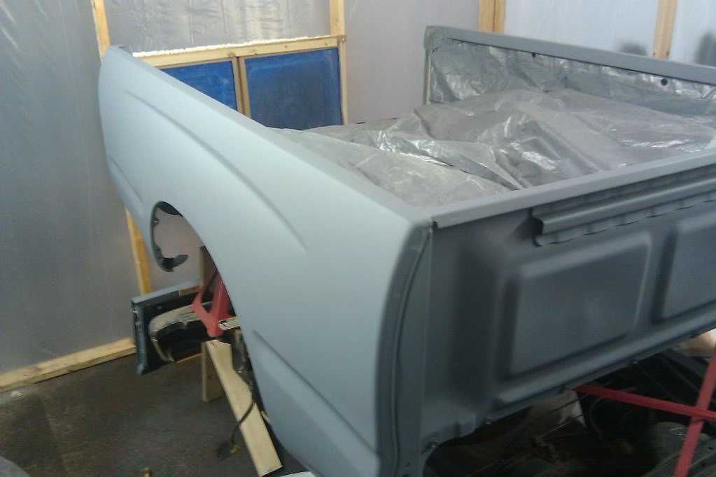

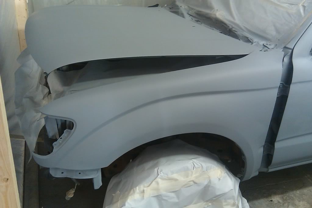

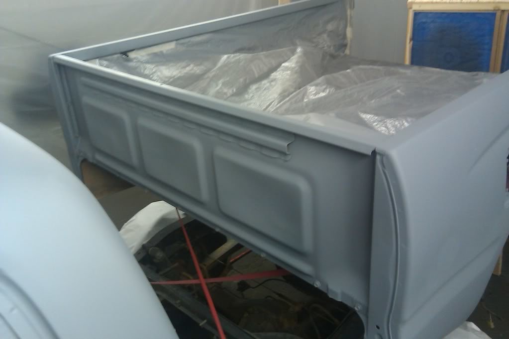

    Well after all the body repairs were done, and imperfections were located and fixed, we were ready for primer! I used Kustom Shop's 2K urethane epoxy primer. This product, like most primers of it's kind, can be used two different ways. It can be used as a high-build primer, or as a sealer.

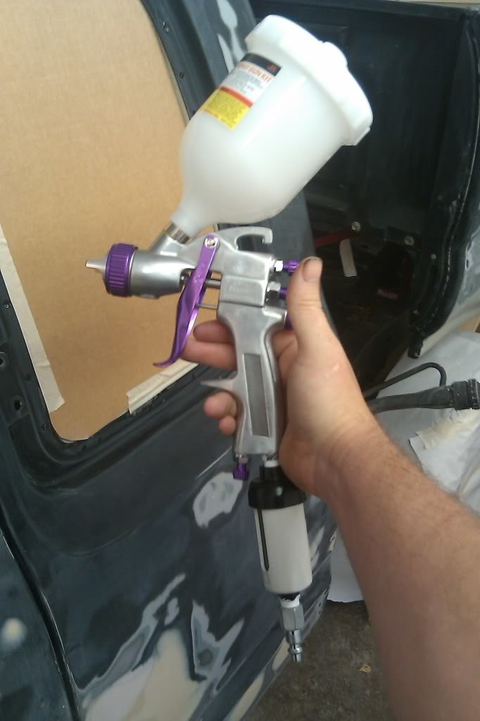

    To apply the primer you will need a decent quality HVLP spray gun. HVLP stands for High Volume Low Pressure. You will use a high volume of materials versus a low pressure of air. This improves the quality of the finish. Below is the spray gun I used. For primer I used the 1.8 tip. When painting and clear coating, I will use the 1.4 tip. The tips are interchangeable.
    We will first cover the high-build, then when the sealer is applied, I will go over that. To mix it into high-build primer, you mix 3 parts of part "A" (the primer) to 1 part of part "B" (the hardener or 'catalyst'). After mixing the two parts, this primer has a "pot life" of about 2 hours as long as you keep in stirred occasionally. After that it is no good. (this pot life is reduced quickly the higher the ambient temperature) This primer is used to build up the surface, filling small imperfections. You want to apply it in multiple "coats" to get a uniform coverage. After each coat wait approximately 15 minutes before applying the next coat. I applied a total of 3 coats. When the final coat is sprayed you must wait a minimum of 2 hours before sanding. I allowed it to sit overnight. After drying you can then carefully wet sand with 400 grit sandpaper, or finer (600 grit, 1000 grit) You don't want to use anything coarser than 400, as many paints will allow the scratches to show through. Once sanded smooth, you will have a beautiful base to apply your sealer, paint, and clear coat. The photos here are after the high-build has been applied, but not sanded.
    As you can see it came out pretty well. What you cant see in that the surface is actually pretty rough, a result of the "high-build" that builds up layers of primer to allow a uniform sanding to be done. If you were to run your hand across the truck it would actually feel like rough grit sandpaper right now.
    You also may have noticed that the front fenders are not in their bolt-on location. I off-set them to make it easier to get the primer into the door jam areas in front of the door hinges.
    NEXT: Wet sanding to smooth out and prep for the paint!

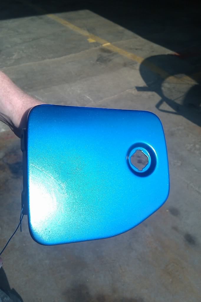

    I couldn't resist this afternoon, so I shot the fuel door with the base coat to see what it would look like. Now remember that there is NO clear coat on it, so the shine is not quite as good as it will be. The glare and discoloration in the lower left is because of the angle the sun was hitting it.

    I like that better then i originally did. The color looks better sprayed on then it did in the sample.
    Can't wait to see the whole thing sprayed that color!
