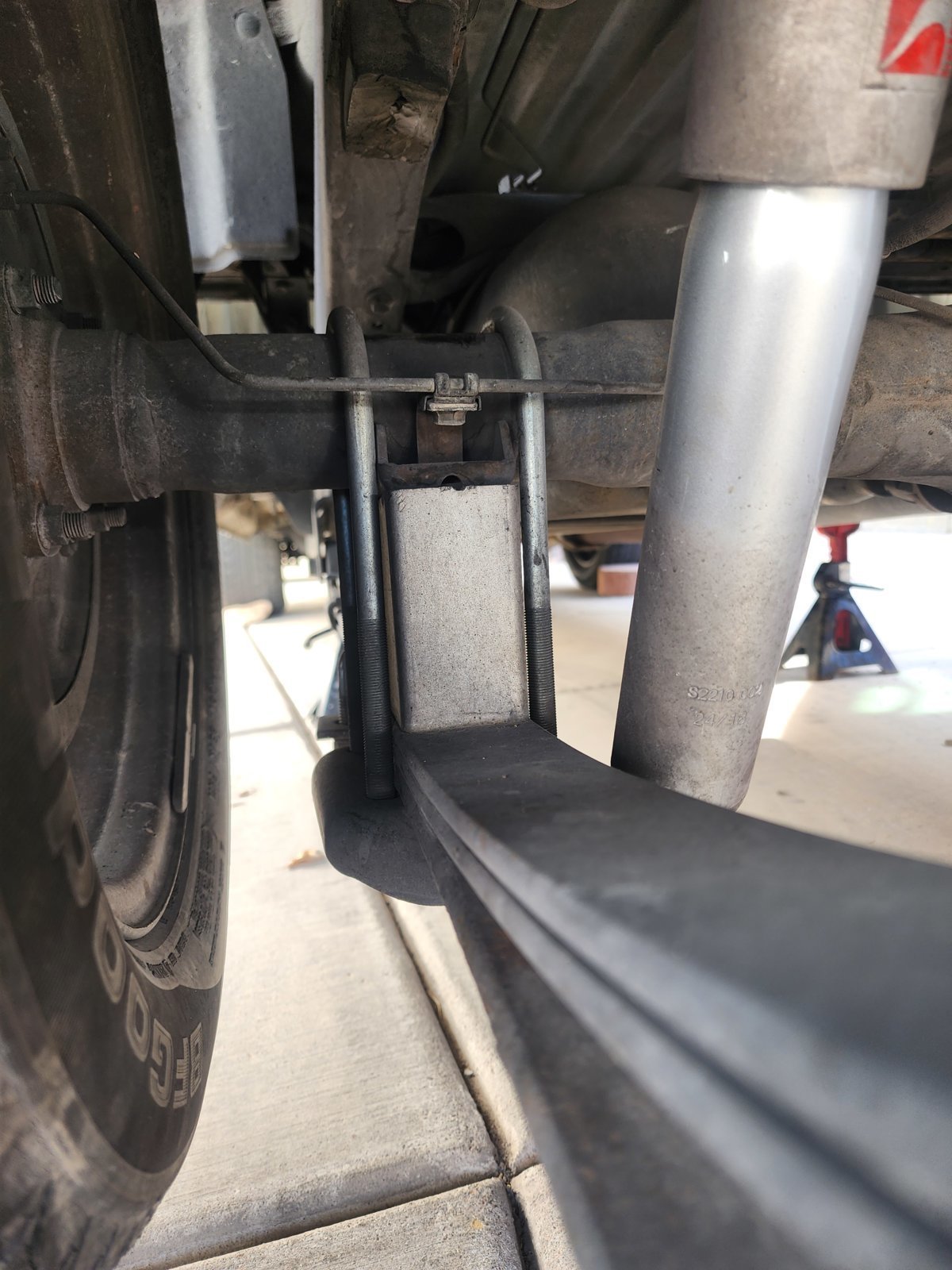

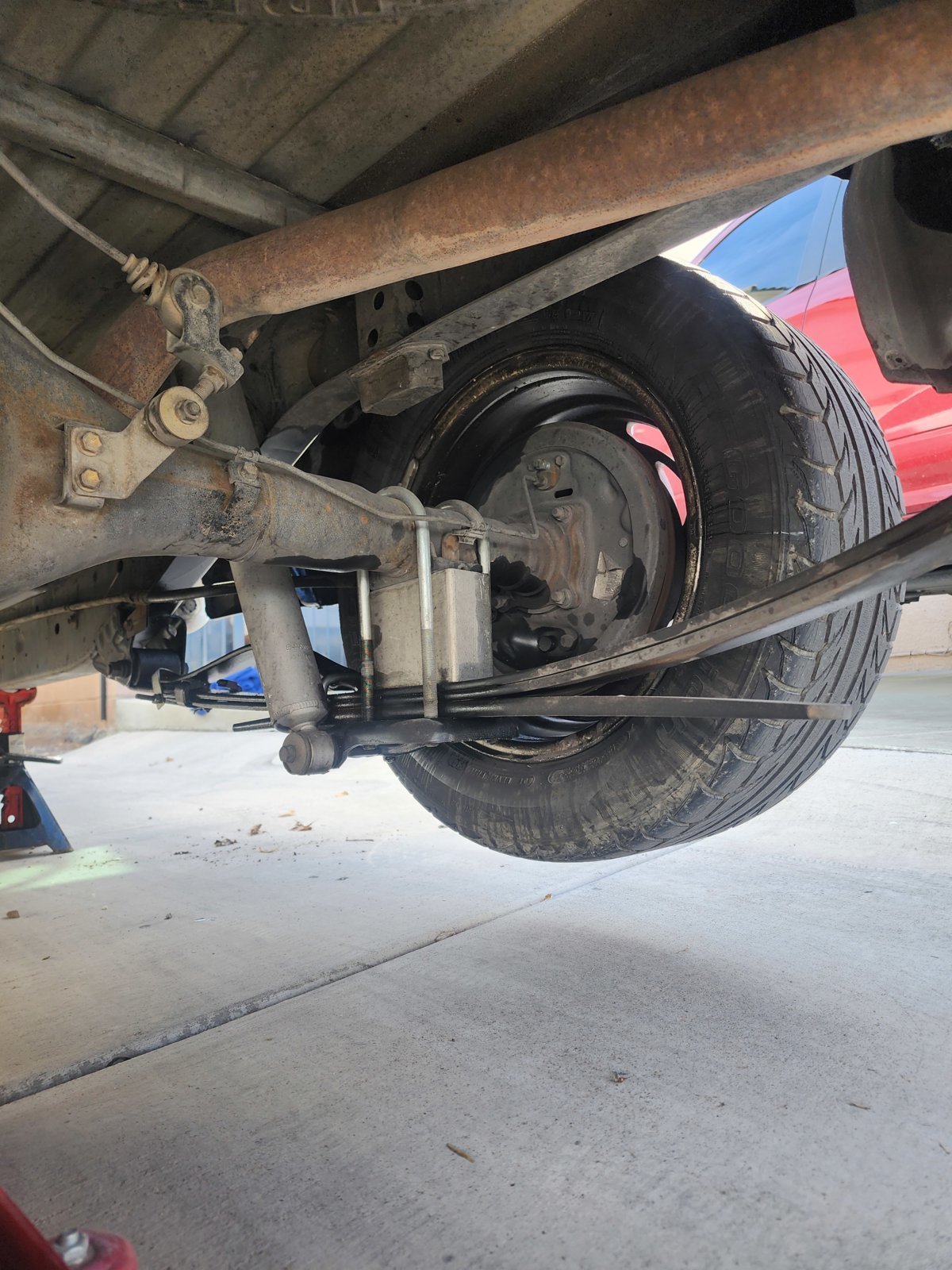

    I have a recently purchased 97 taco that was lowered by the previous owner and I was going to un lower it when I realized the the rear diff was above the spring suspension when in other trucks that weren't lowered or even lifted the diff is below the leaf springs is this just my truck or is it reversible?

    Spring over is found on 6 lug vehicles (Prerunner or 4x4) whereas 5 lug are spring under (2wd only variants)

    OP, on a 5 lug like this you just need to remove the blocks and get new ubolts (and probably shocks) to return it to stock height

    Do you know any place to get the u bolts i checked just like oriley and other shops the bolts were to small

    do you have any trailer or HD truck supply shops around? they usually can make them on the spot for cheap

    I expect General Springs to have them
    They make tons of leaf packs and sell u bolts for many older and newer vehicles
    No reason why they wouldn't have them for a 5 lug
