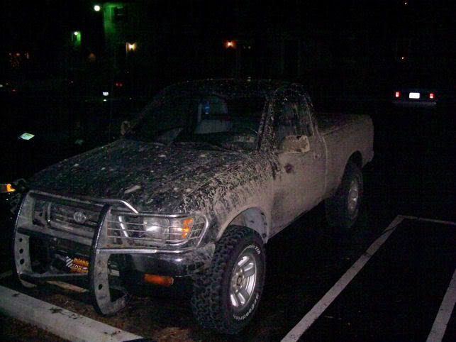

    I won't drive it unless it's a manual. ;):p
    here she is. :)

    Oh my god I think I am in love...........
