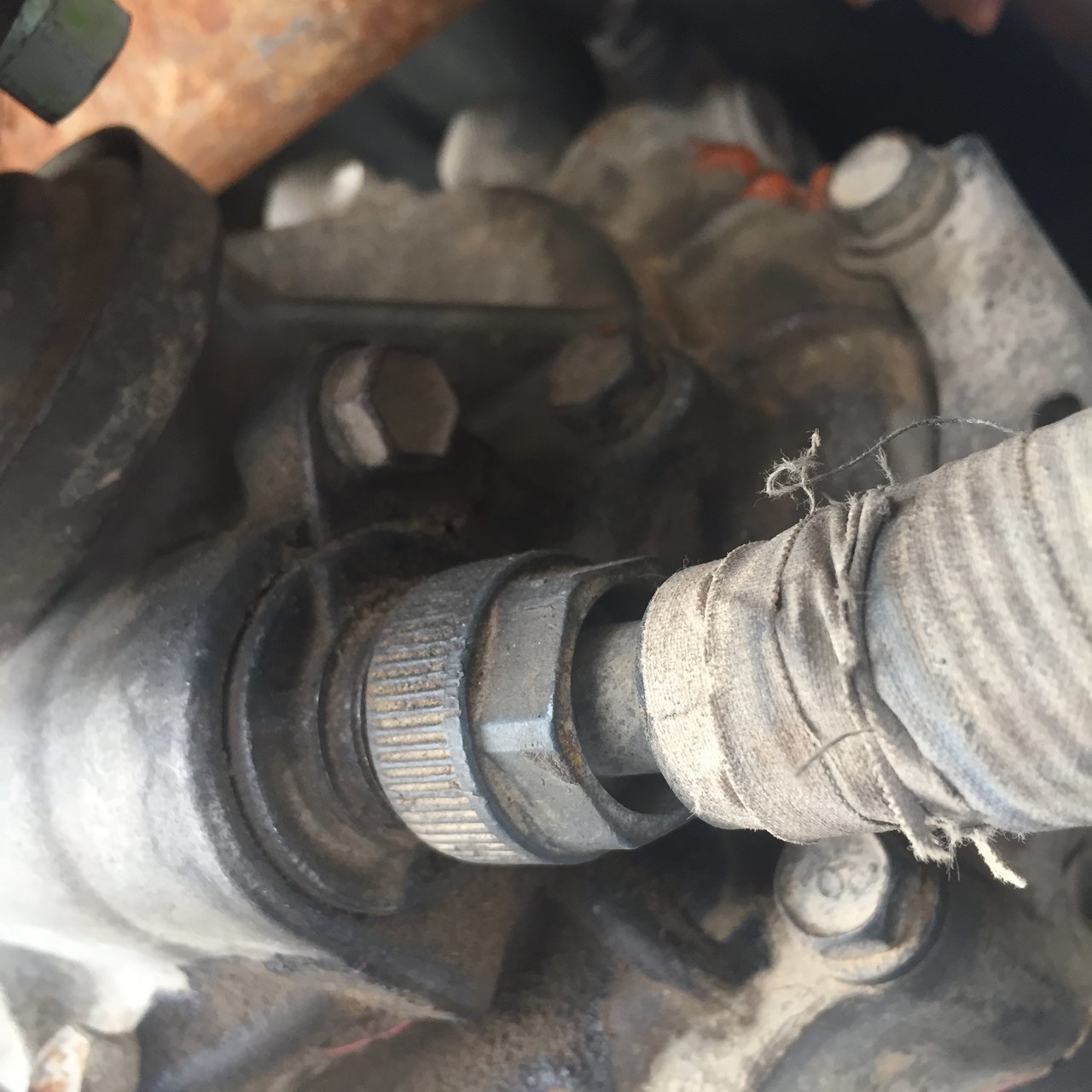

  14. Dec 25, 2017 at 1:29 PM
    anthony250f
    anthony250f Well-Known Member
    Feb 18, 2012
    #73066
    16,778
    Anthony
    San Diego, CA
    2008 dcsb trd offroad 4wd
  15. Dec 25, 2017 at 1:57 PM
    JeremyD
    JeremyD [OP] Member
    Dec 23, 2017
    #239218
    15
    Jeremy
    97 Tacoma 4x4
    Yes that’s mine but have found one here locally that has the button will it work ?
