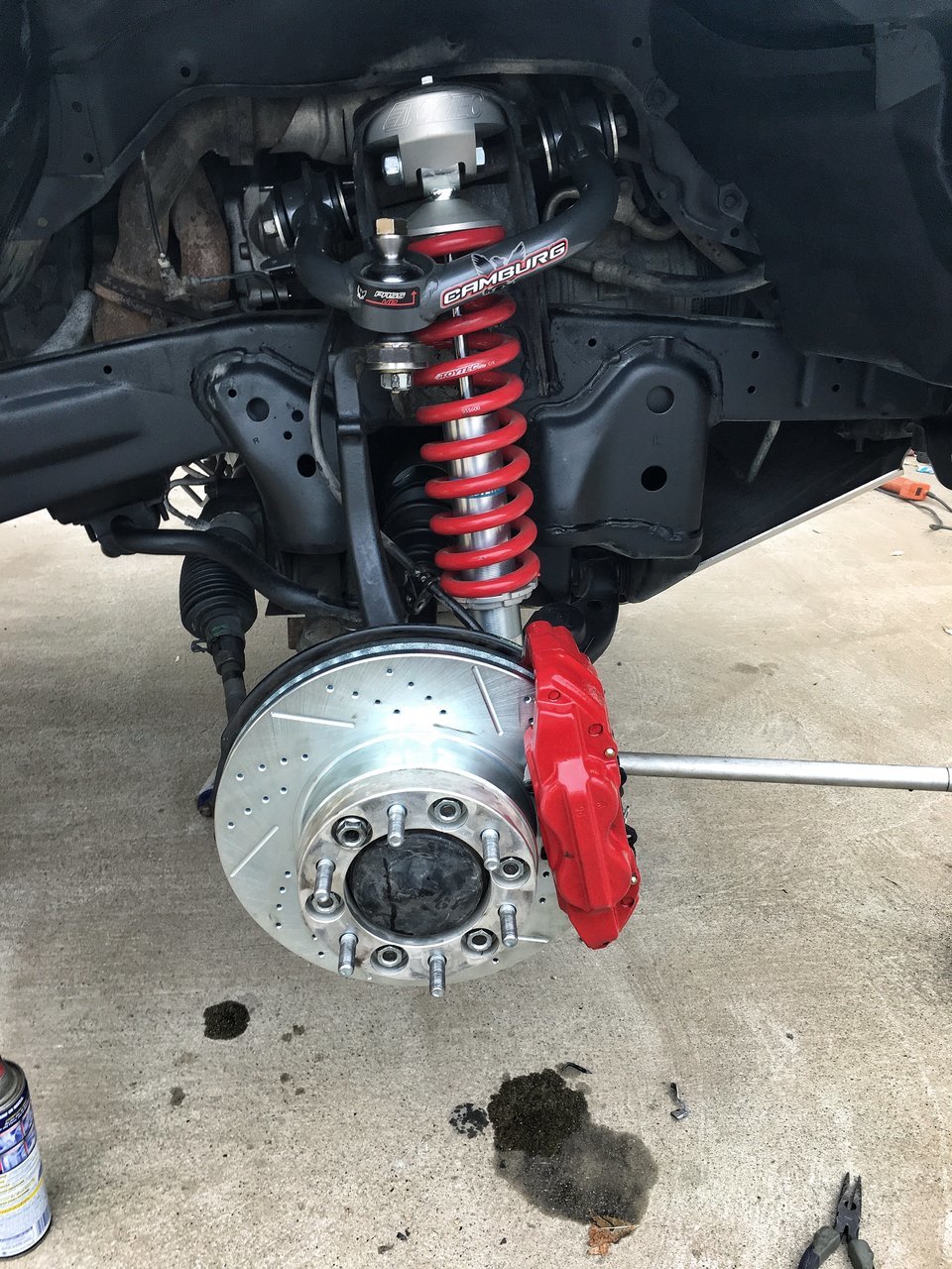

    I have the same vibration/roaring going 20-30 mph I also lifted mine, camburg UCA, new cv axels, new lower ball joint, tundra brake upgrade, I got an alignment . And it’s till doing it.1D34B7C6-713B-4DDA-8FB1-1CB37CF2DB36.jpg .. I replace my rack n pinion like 2 months ago with new tie rod ends.

    @FLBAdrian have you driven it with the wheel spacers off? If those aren't concentric to the hub and wheel it could be the problem.

    No I have not took the wheel spacers off. I’ll give it a try when I get back home later in the week.

    So I took off the wheel spacers and it still makes the vavibration. :annoyed:
