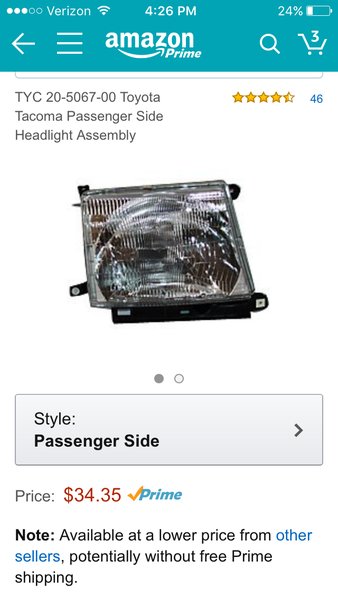

    What aftermarket headlights are those? Mine are so yellow now..

    Pretty cheap. How long have you had them? They holding up alright so far? Any condensation?

    Just bought them last week and installed them today... will wait a few weeks to see how they hold up

    Bought some cheap 2nd gen blacked out housings for my 2nd gen and they leaked, but even after sealing a couple times they will randomly get condensation after rain storms. Sometimes it's the passenger side and sometimes it's the drivers. I can confidently say after taking them out and resealing them with silicone more than once that there's no way water's getting in through the seam between the lens and the housing. I think some aftermarket housings just don't have good tolerances around the bulbs and can leak there.
    The good news is that whenever it happens now it's such a small amount that I just take the bulbs out of the housing over night or maybe while I'm at work and the moisture leaves the housings and they're good to go again. So it's barely any moisture getting in now. Not a bad issue to deal with for having cheap headlights compared to prices for oem housings. I'll probably be super observant if I make some retrofits just to eliminate any leaks whatsoever, but for now I'm set :)

    So you're resealing the lens? Or the area where the bulb goes that you were talking about. If the come apart easily I might consider just doing a retro fit while I'm at it.

    I go to adjust the lights and the back adjuster broke, so now I can't adjust them... fudge... I'm irritated, they look nice but not functional.... I read reviews that the adjusters broke easy

    All I'm doing is caulking the seam between the lens and the housing with silicone - while others will swear that the only way to do this properly is to open them up in an oven and use new window weld I've found that this may or may not be more effective than using silicone from the outside on the seam. Pushing it in all the cracks with your finger and wiping it smooth makes it clean and leak proof as far as I am concerned. I used to paint houses so this is my preferred method lol.
    After taking my 2nd gen lights apart I'd only do it again if it was on a new set that I was going to retrofit for sure. Other than for that reason I'd not waste my time with it. Even with all of the rain this year all I've had to do to get rid of the condensation is to take the bulb out for a day and let it hang from the wiring harness. If I was doing a retrofit I'd go for both the new butyl tape, silicone, and double check the seal where the lights click into the housings to make sure those puppies hopefully didn't get any condensation. That won't be for awhile though. I'm thinking of converting my truck to the 96 headlights & grill since it's only a small amount more than getting new 98 lights and I like the look better.

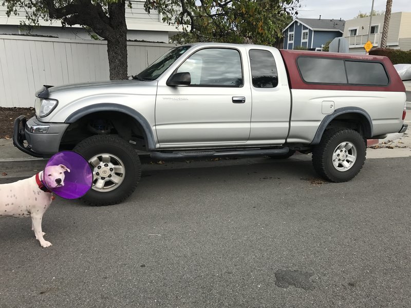

    Finally getting around to sending some money on my truck. Going to be looking to you guys for help in the upcoming months. 2000 3.4L pre. Ive got a pair of fox coilovers coming in part#985-02-003 got em very cheap $660+Tax. UCA's next, any recommendations? IMG_0260.jpg

    id pair with a good rear and new leafs so you aren't bro leaning hard

    I know a lot of people prefer the total chaos uppers over the camburg uppers. Hiemed upper is better also, but more expensive.

    Okay, its gonna take me awhile to save up the cash for all of this, coilovers took me months alone. Baseball coaches and money dont go together. Would i be able to get away with just adding on or just suck it up and save for new packs?

    Buy once cry once. Suck it up and buy it right from the beginning

    you may be able to get away with AALs, but if those are original leafs on your truck, just get Dakars and be done with it.
