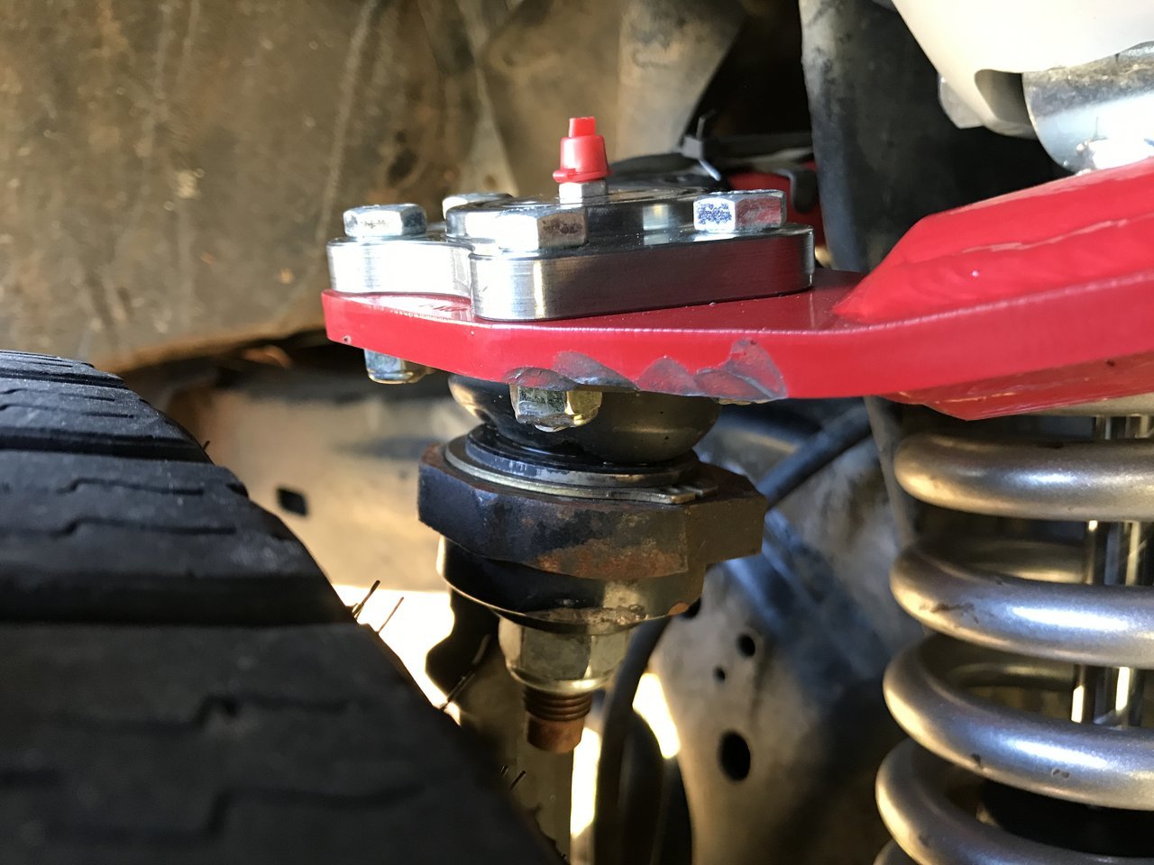

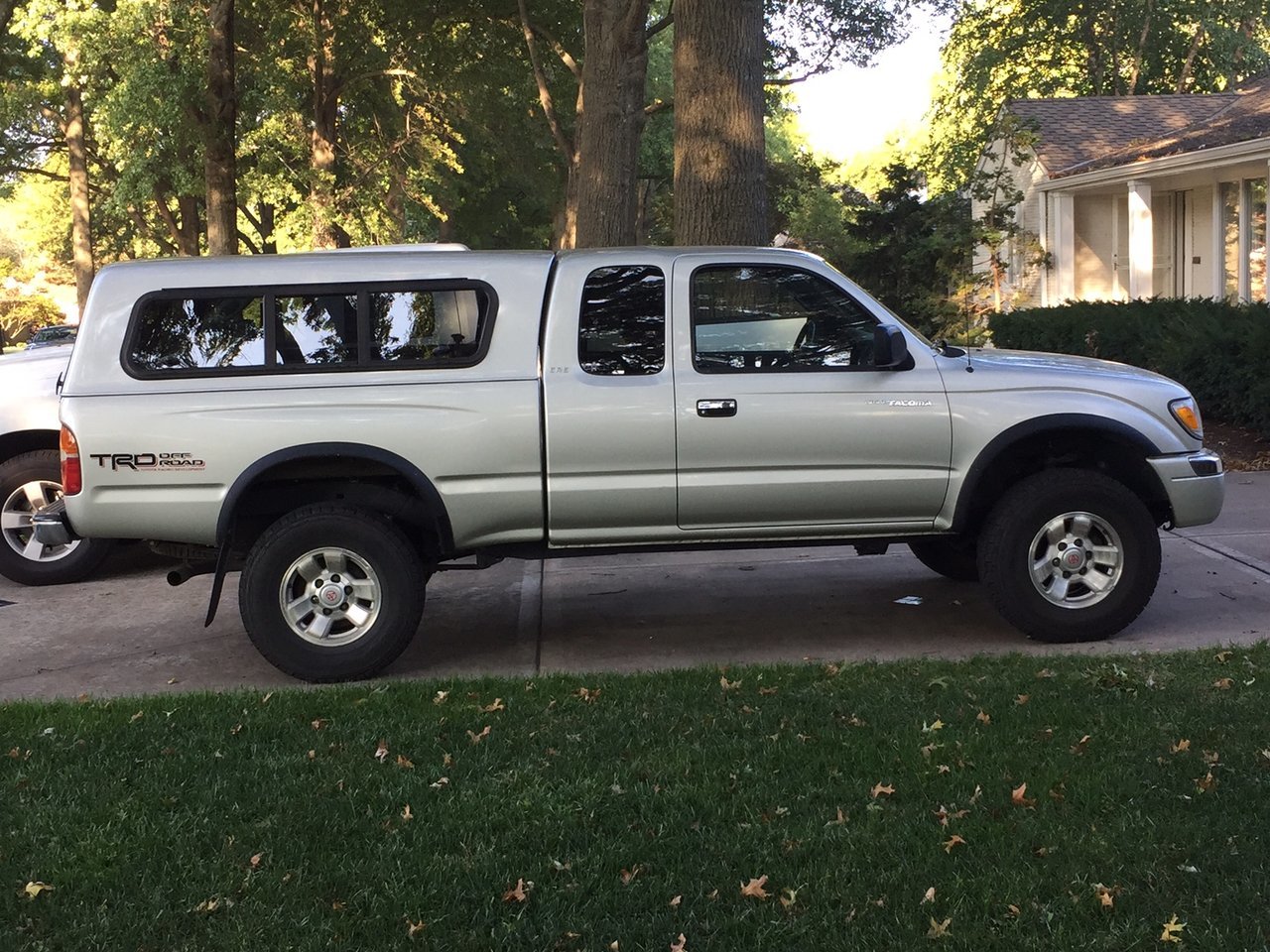

    Can anyone tell me what's been making contact with my UCAs to make these kinds of marks and how I can correct the issue? I learn as I go with this build and after a good wash today I just noticed that this had happened. I have done some light off roading recently but I wouldn't have considered it rough enough to have done this. Maybe I need to change the way I have things set up?

    Looks like it could be them tars. They're the only things up there. Do both sides have it?

    That's the tires, get a better alignment or go ahead and make the tires sit farther out by either spacers or different rims with better offset
