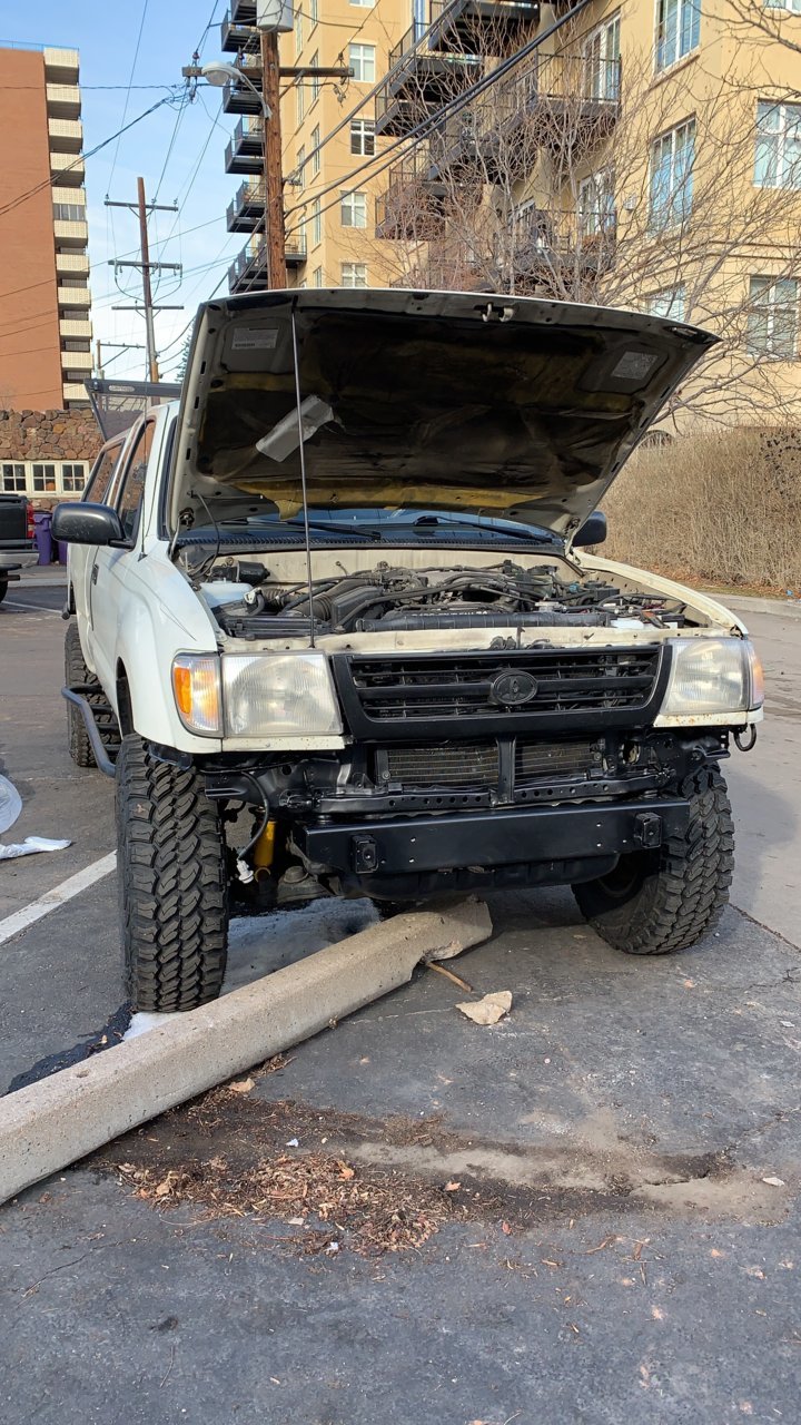

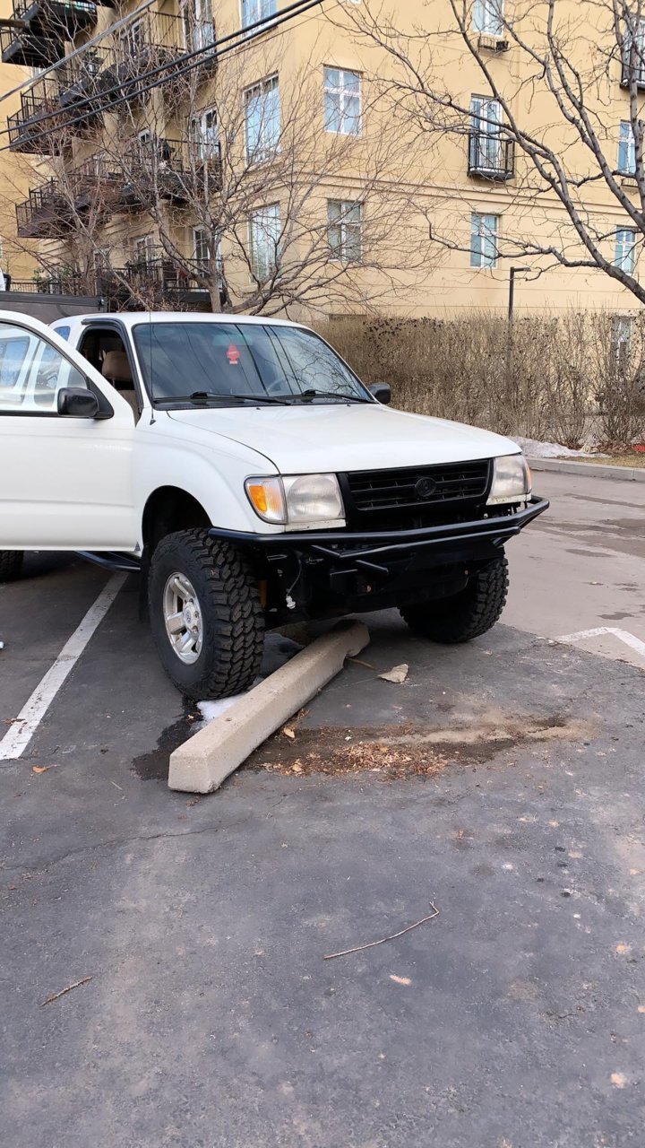

    Installing a trail gear low pro front bumper on my 1998. How much cutting am I going to have to do?!

    Was told I need to at least cut small crossmember between frame rails that currently houses the stock skid plate bolts? Would be very happy if I don’t need to use the grinder.

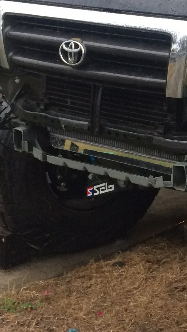

    I had to section out the small skid hanger cross member where the bolts hit - just spray it with primer and install the cross member then you'll see where the nuts are hitting the cross member. You can kind of see it here - I might just cut the whole thing off eventually, but I tried to cut as little as possible just to show people where the cross member can interfere with the bumper.

    Got the mounting plate on. Your picture was incredibly helpful. Thanks!

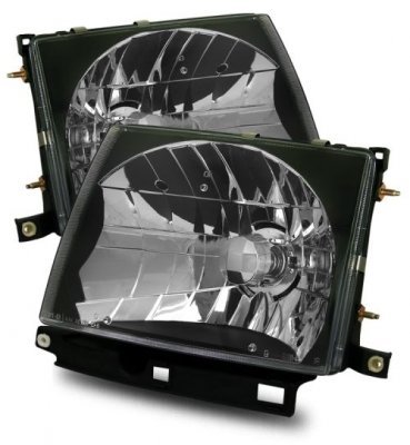

    Anyone have some black anzo headlights laying around?

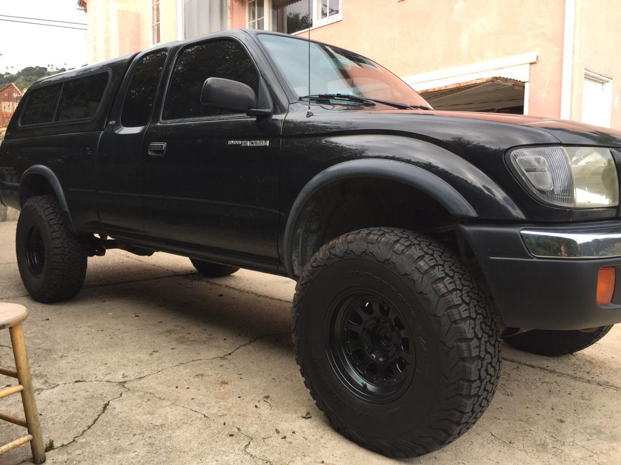

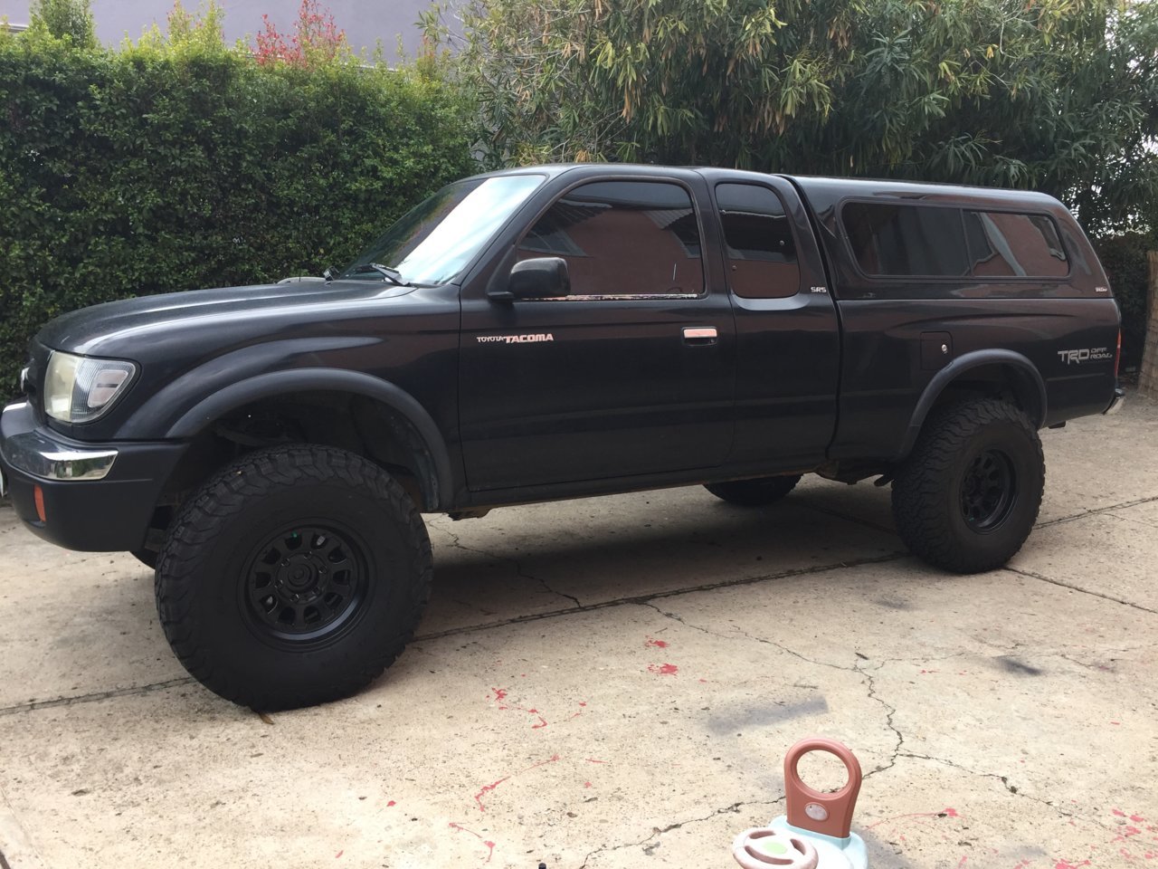

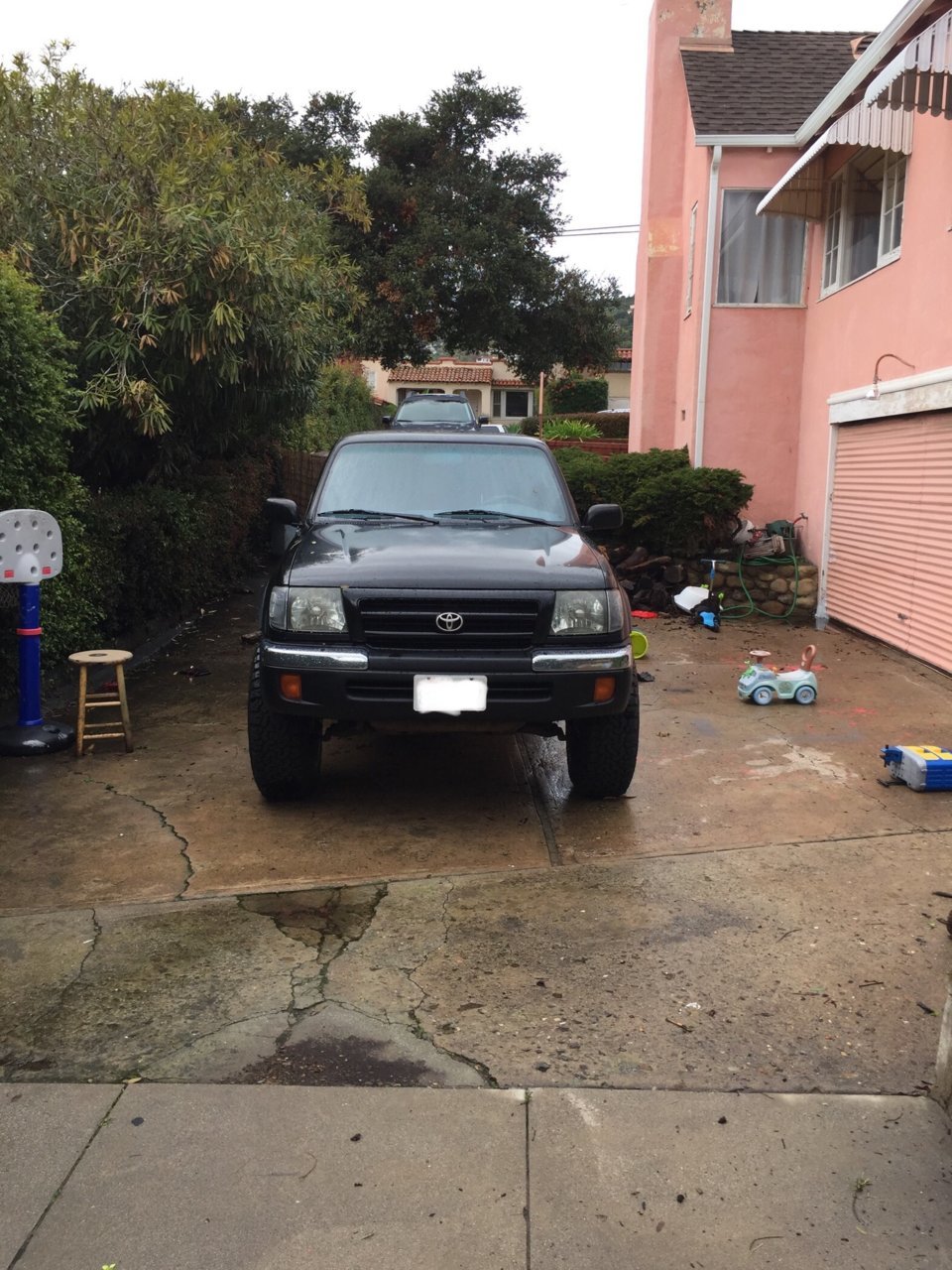

    99 prerunner 3.4L 2” lift aal 33.10.5.15’s just put new wheels and tires. Had it stock for 10 years, runs great with 33s.

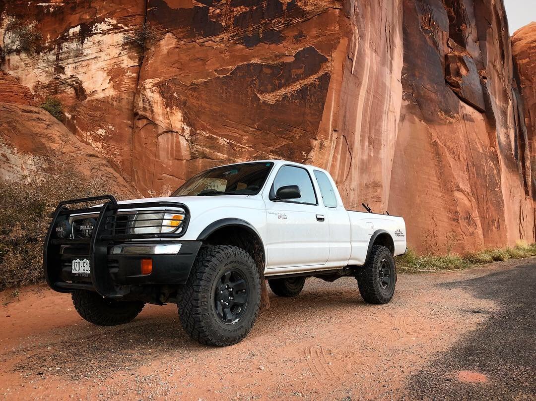

    Here's my '98. Bought at 128k miles last april.
