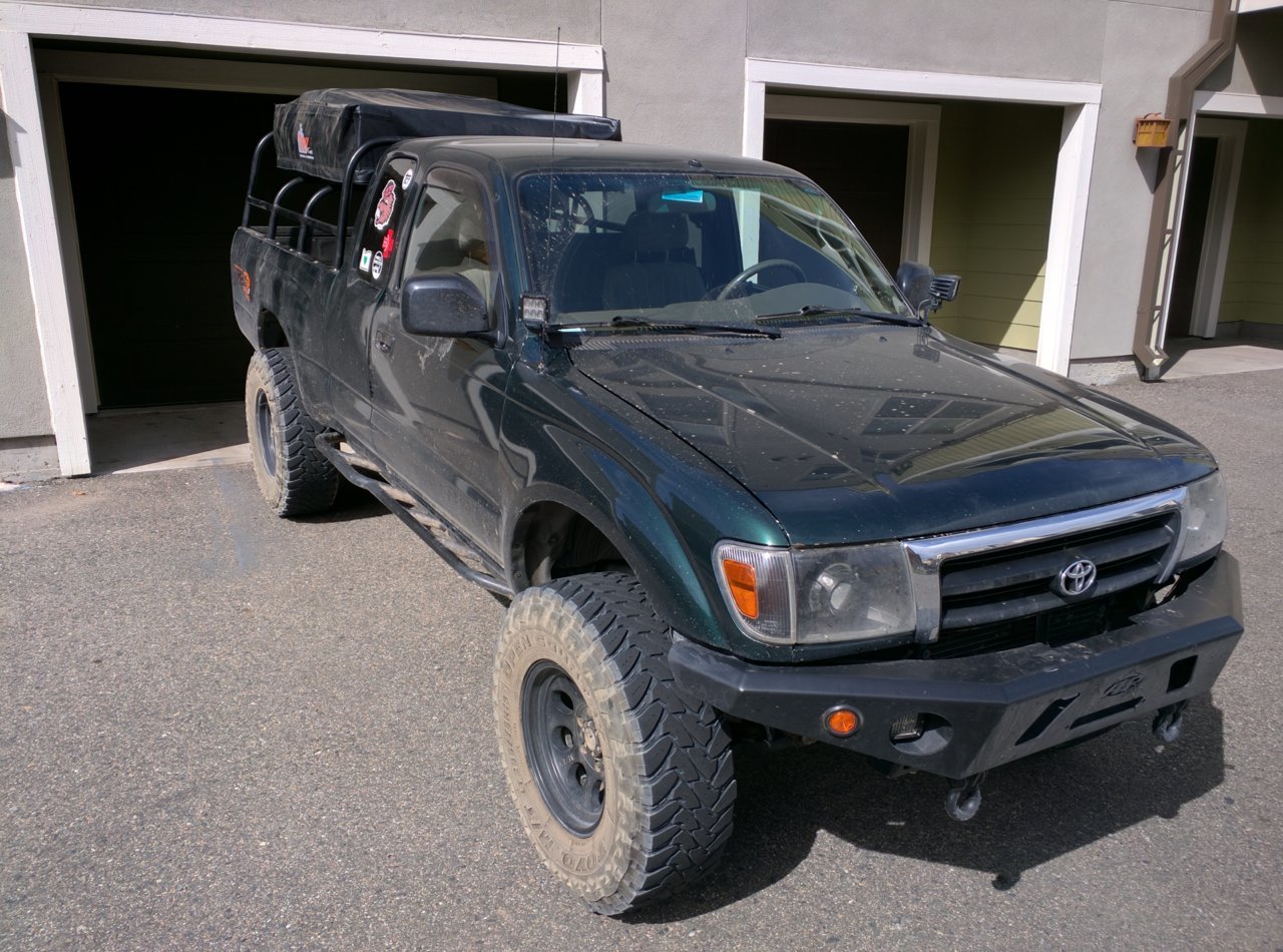

    as others have said, most 1st gen plate style bumpers are going to match up to the 01-04 front end, because it protrudes more, and if they built it to tightly fit the 98-00 it wouldn't fit the 01-04. and 01-04 is the most popular of the 1st gens to be honest. (and you can swap to the 01-04 front end, just a couple brackets to trim, and buy all the parts)
    but yeah, it didn't fit perfect
    here's after I had to swap back to a stock grill (some jack waggon decided he wanted to try and steal my headlights... got the hood up, started a battery fire, ran away when others came to "help")IMG_20160410_154002.jpg

    Thanks for posting that pic. Darn thieves.

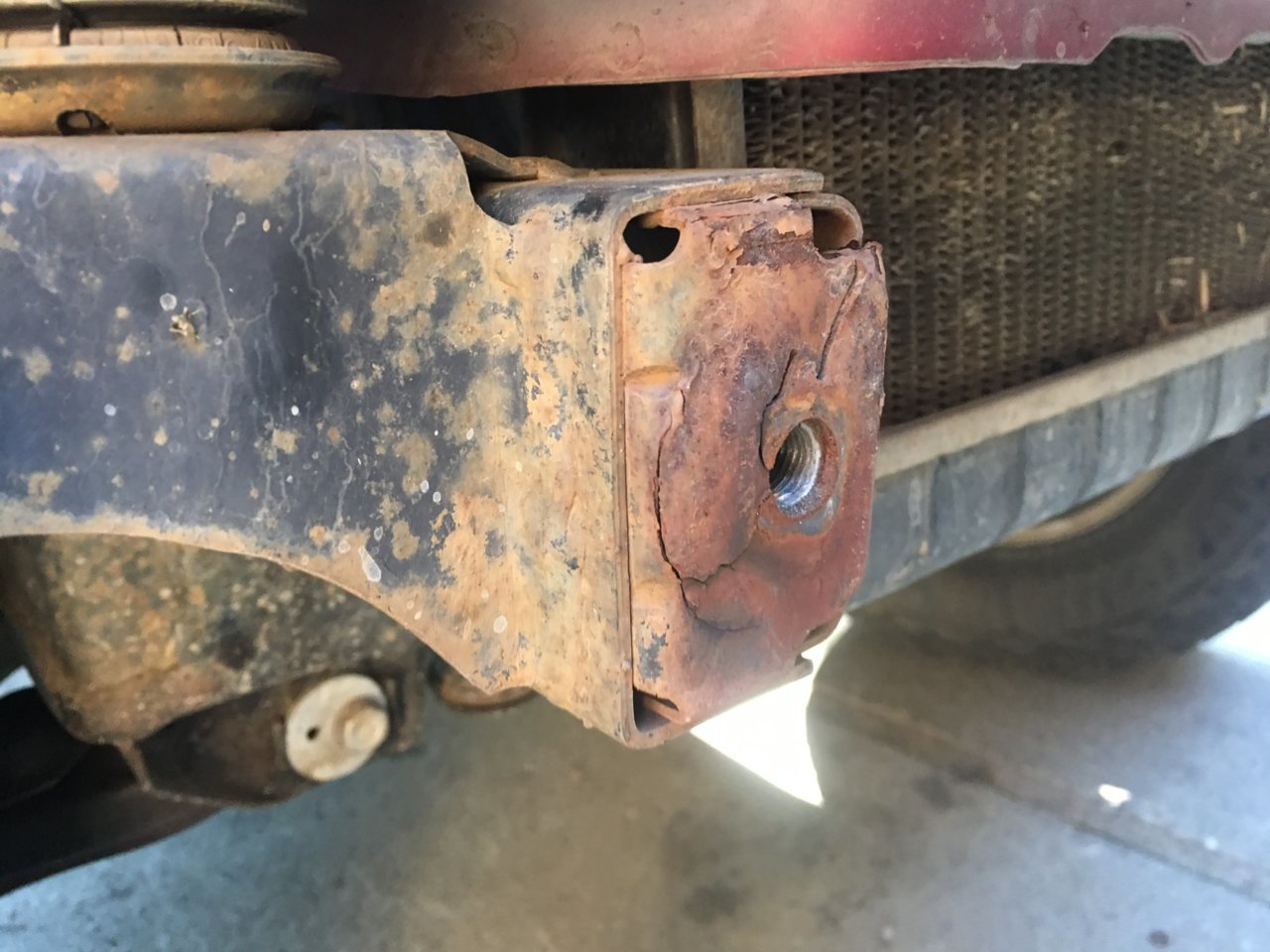

    While they may not need to be modified to mount the bumper, I can speak to from personal experience that when mounting an ARB, the end caps should be cut out and heavier plate should be welded in place. If you don’t ever plan on winching or using the front recovery points, it’s probably not needed. But, here is the result of using my winch and then not addressing the issue for a couple of years...

    Did the ARB block break or something?..

    No, the block is bolted to the frame end cap. It just tried to pull the nut through the frame cap. Also bent the mounting brackets once the end cap failed. I’ve never even used that winch in what I would consider a hard pull. It’s mostly been used to clear trees off the trail and get disabled vehicles into position to be towed with a tow strap. Although, I can’t point to a specific thread, I know I’m not the only one to have this issue on TW.
