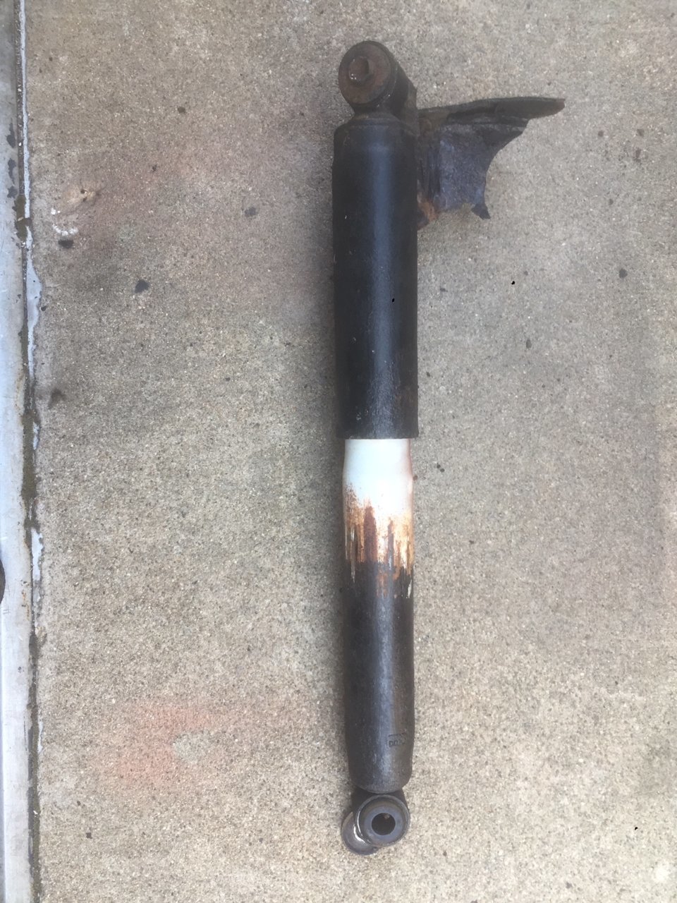

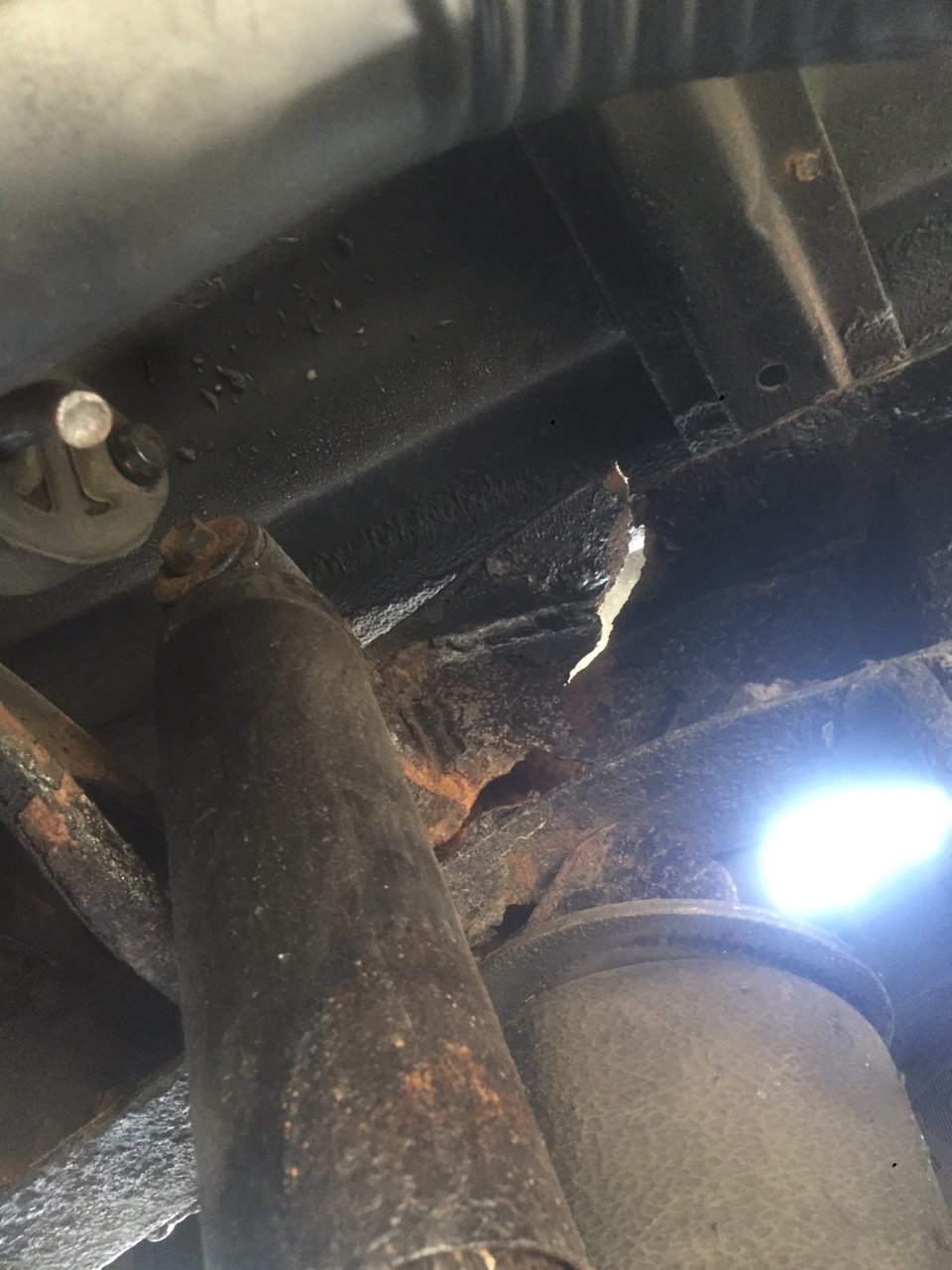

    anyone else here ever have the rear shock snap and take the mount section of the frame with it? :itllbuffout:bum shocky.jpg bum shocky 1.jpg

    Lololol. Naw, can’t say I have. Upgrade time?

    Those are Safe-T-Cap frame restoration kits

    I had one of mine one bump from snapping and my leafspring half off, the rust on these trucks are no joke

    Scary shit ain’t it.. what’d you end up doing to fix it?

    I ended up replacing that section of the frame completely and the leaf spring set also because they were just about flat from being disconnected

    Nice, did you use the Safe-T-Cap frame kits, or something custom fabricated?
    I’m currently having some kits installed as well as new leafs and shocks all around.. my frame was all Swiss cheesed up by the mounts, I’m surprised I didn’t lose a leaf as well..

    I ended up cutting out a piece of frame from a wrecked tacoma I found in a junkyard and my wife welded it on, I have a full write up of it on my page. I still haven't installed new shocks back there yet, but that is extremely high on my to do list
