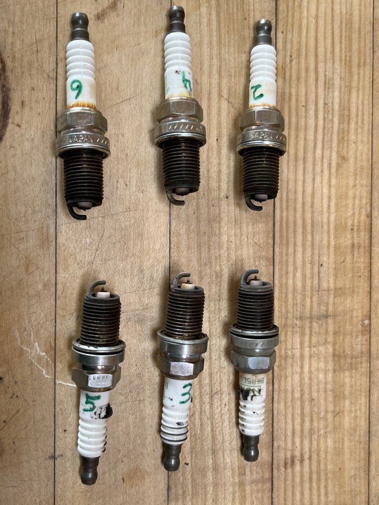

    Here are old plugs... 2,4,6 all seem to show more wear and higher temp... also seem to be burning richer... due to less spark? Seeming likely poor signal/power from coils...?
