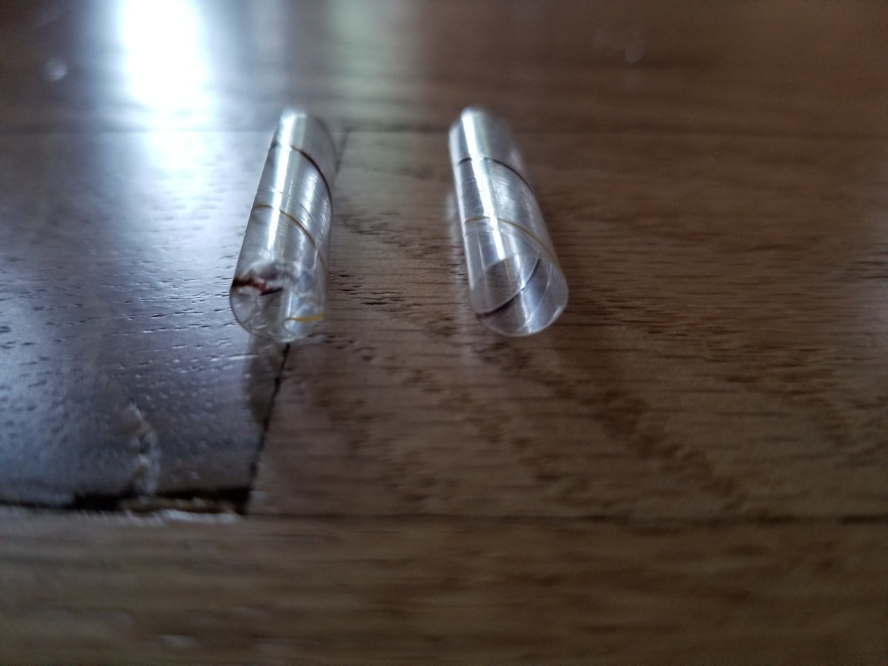

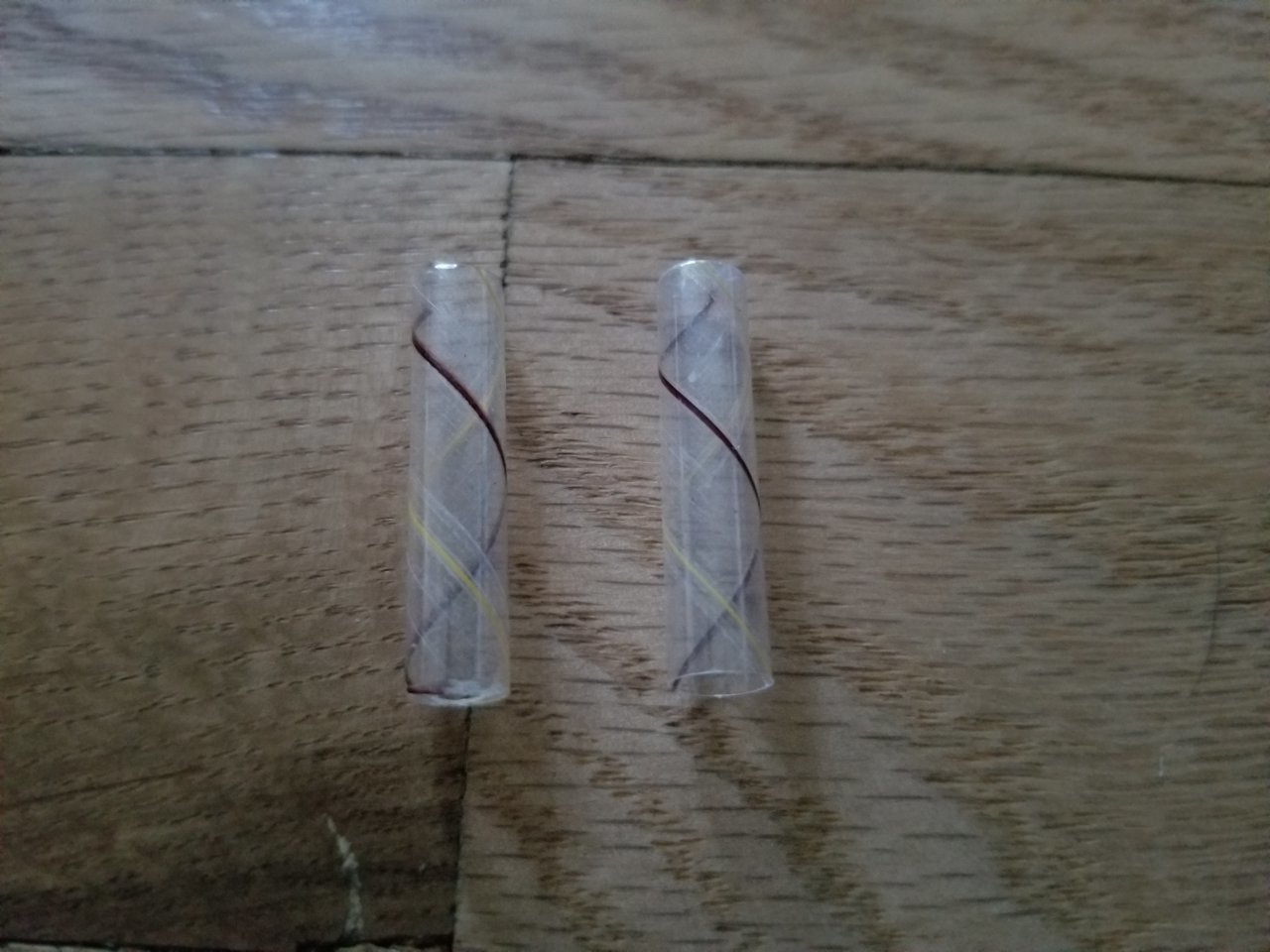

    Oh and these two little tubes... where do they go??20190614_203611.jpg 20190614_203618.jpg
