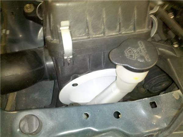

    Just cut the whole in the front of the box, heres a few pics of mine
    The washer jug neck will be right in front of the whole but i dont really matter, you just cut the whole in the front of the box so that it will take in more air coming through the front of the truck
