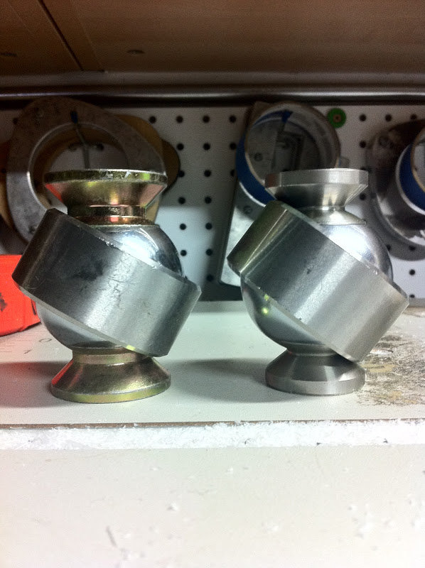

    i think you will get more travel out of the camburg compared to the all pro

    How?

    i need to find the pic, but when i had them side by side, all pro one is stronger as it uses a larger bolt, so the misalignment spacer is larger. so less amount of misalignment on the all pro compared to the camburg

    How does this reduce travel?

    because you have less travel in the uniball so there for less travel available in the UCA. so with one arm, say you run out of down travel at 13" with the allpro, because the extra travel in the camburg you can get an extra inch or so. (numbers mad up but you get the point lol)
    ohh found it.
    i took this a few months ago.
    allpro on the left and camburg on the right.

    Hmm, cool. Thanks for posting that!

    That's informative.

    Both uses 4130 chromoly.
    Camburg is MIG welded using 1" Aurora (1.25" on 2nd gen)
    AP is TIG welded using 1" FK (1.25" on 2nd gen)
    Those not AP's misalignment spacers. I don't know of any companies that use zinc plated spacers.
