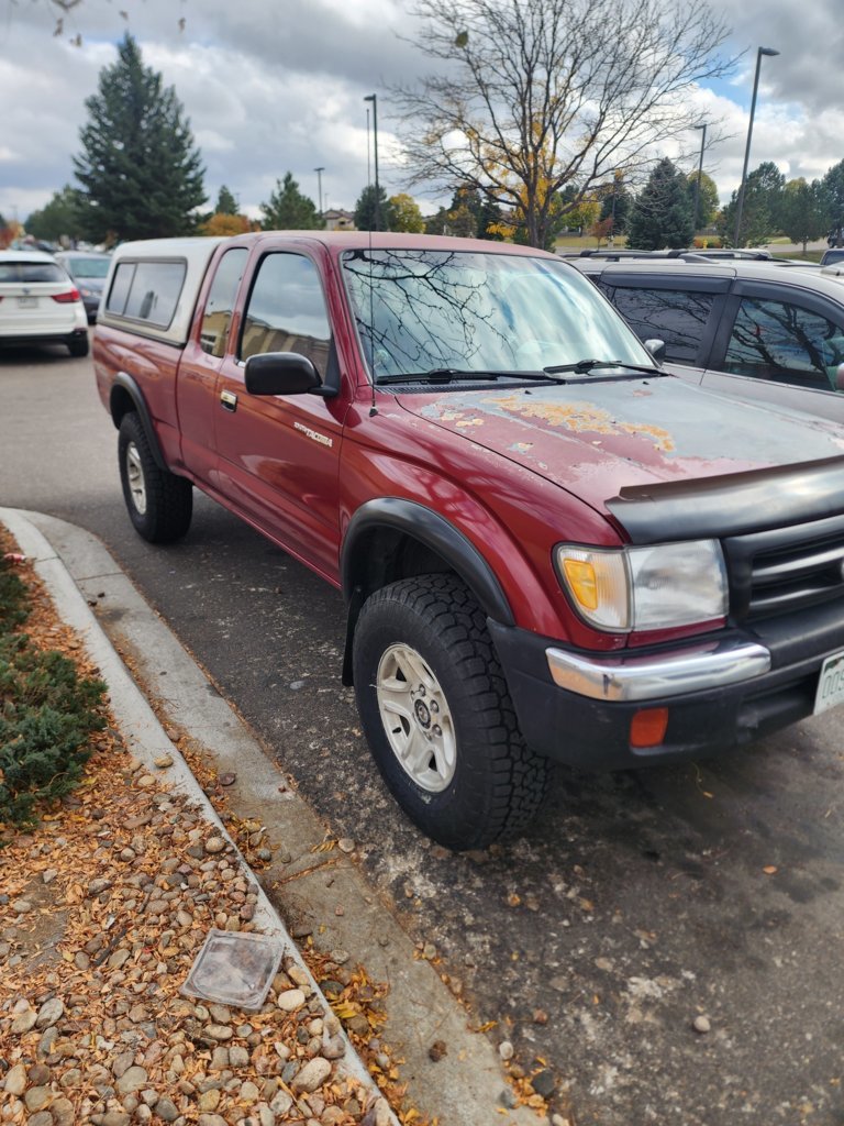

    Try drivers side door, door jam tag. Mine is 1998 tacoma barebone manual locking hubs sr5 5spd 3.58 ratios.
    Its a'ok although will be moving to 4.10 with front air locker rear elocker.
