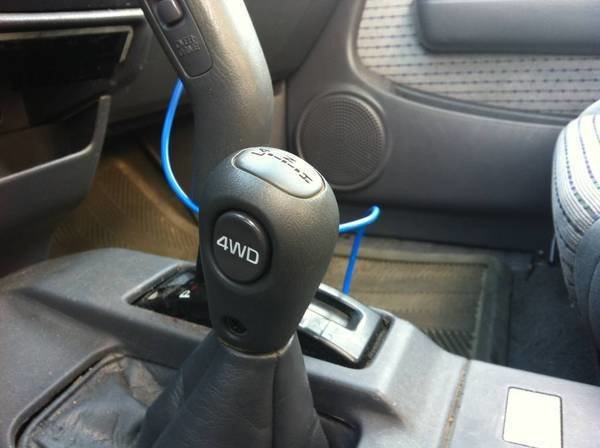

    For those who did the swap from ADD to manual hubs, what transfer cases did you have? The T-Case or the J-case?

    When I did my write-up I was only thinking about trucks with J-Shift transfer cases. Since they can manually shift from 2 HI to 4 HI, there's no need for an ADD actuator with manual hubs; they can shift on the fly without it.
    The manual transfer case with a 4WD button only has HI and 4 LO. It requires a working ADD actuator in order to shift on the fly from 2 HI to 4 HI and back.
    When I have more time I will update my write-up to clarify this. Sorry for any confusion!
    Yes, If you have a J-shift transfer case and manual hubs, you can get rid of the ADD actuator and have a completely mechanical front axle, as I have done. If you had the manual transfer case with a 4WD button and deleted the ADD actuator, you would lose shift on the fly capability and you could only engage 4WD using the manual hubs.
