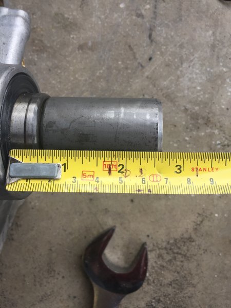

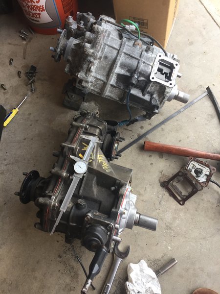

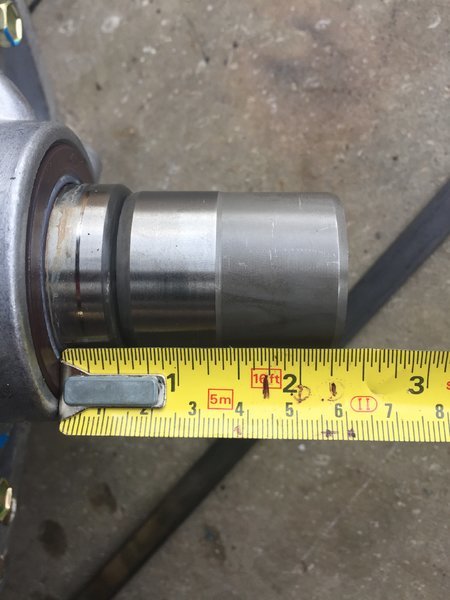

    Thanks for the link I think I have a lead from it for spindles and hubs. I do have one more question I got a manual tcase today and the output shaft to the trans is quite a bit longer

    So the manual tcase with longer shaft did bolt up but I measured the transmission mounting surface to the bottom of the shaft, then measured the the mounting surface of the tcase to the end of the shaft and it's too long it has to be hitting the c clip inside the trans. I am unsure if I have the wrong tcase or wrong housing off the back of the a340f. Any guidance would be greatly appreciated...thanks in advance
