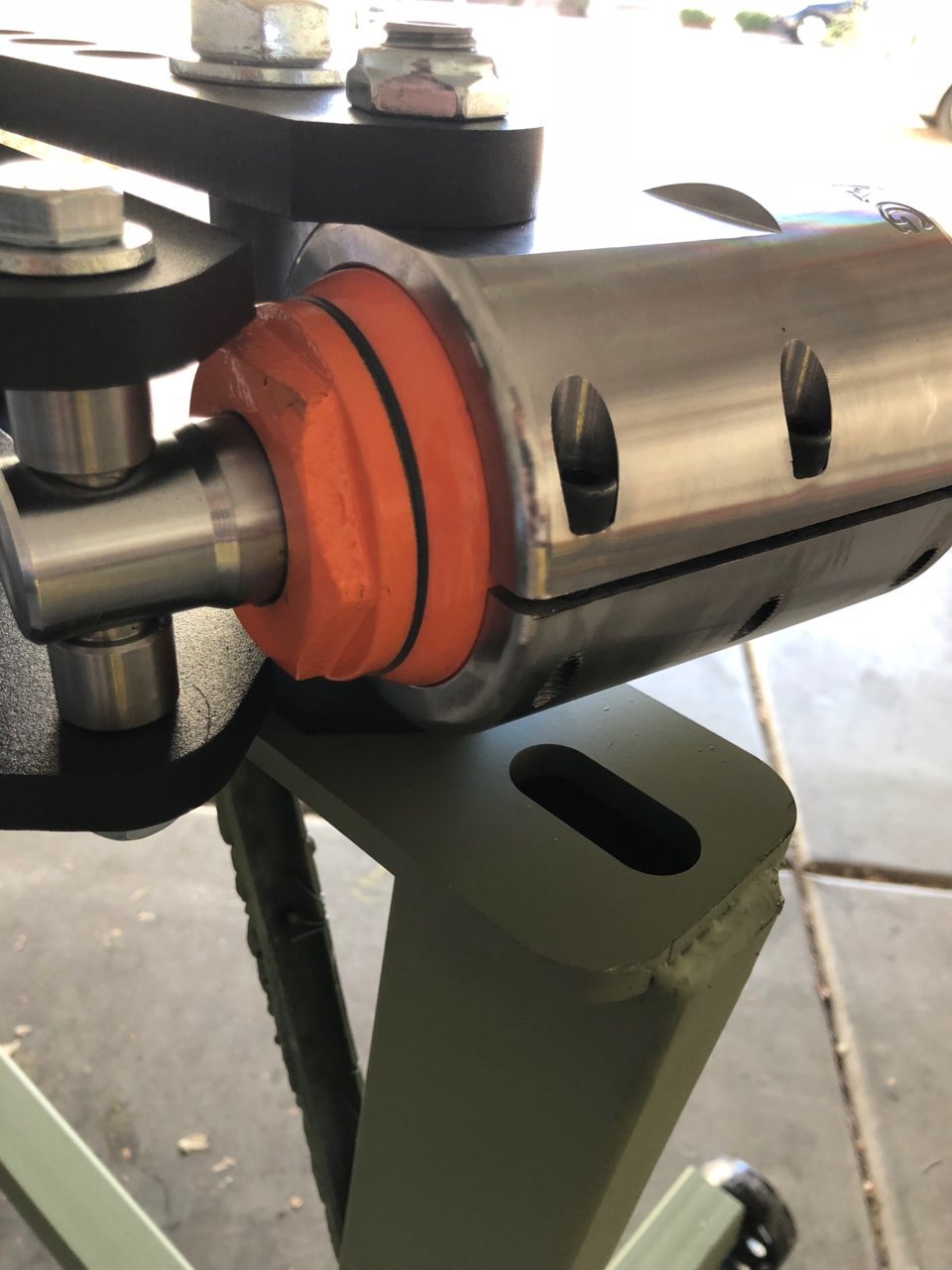

    -JD2 Model 3 bender, custom mounted on a harbor freight engine stand

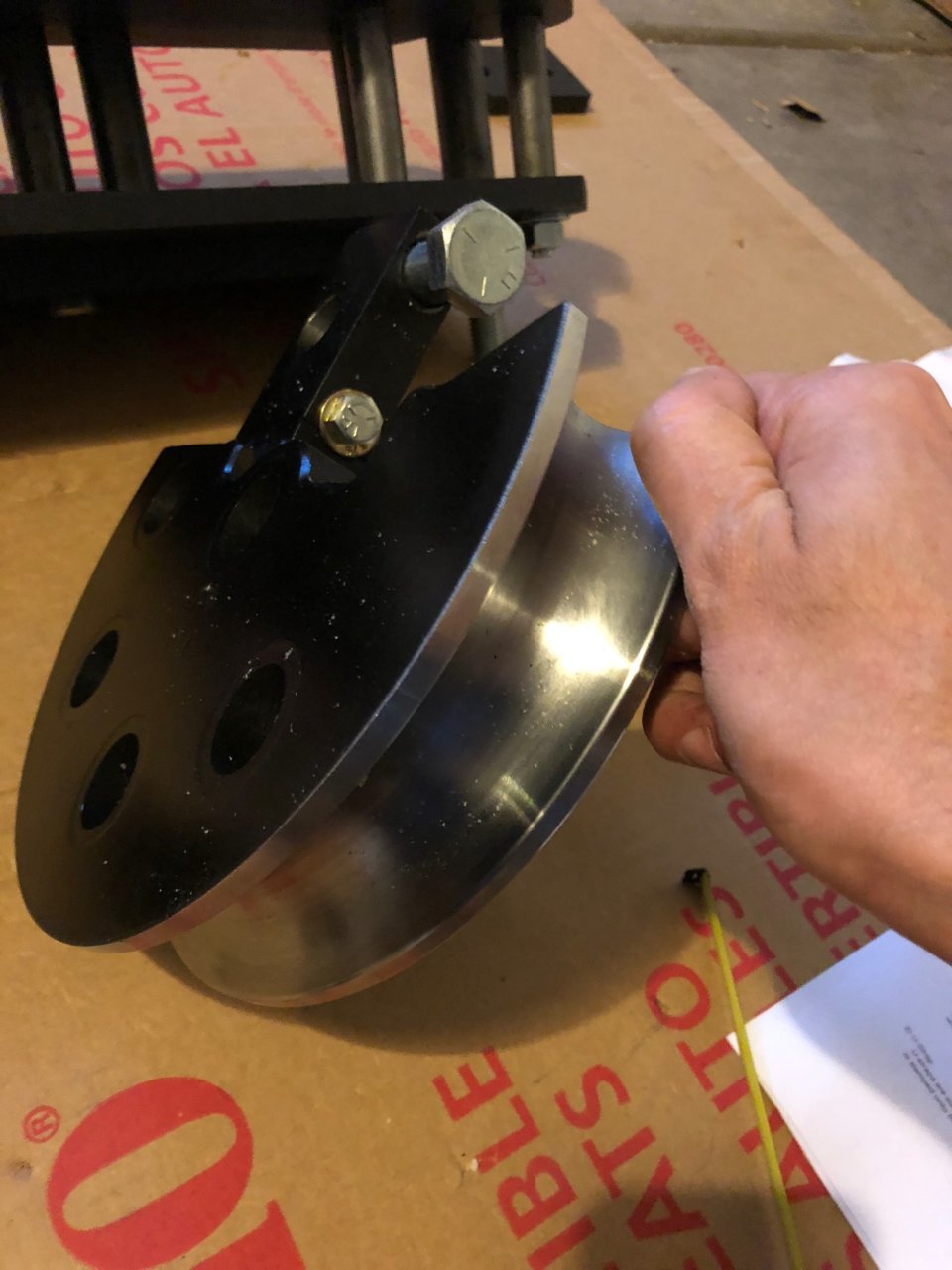

    -JD2 1.50” die with a 5.5” Center Line Radius (CLR), 180 degrees.
    -Swag Offroad machined tubing bender air/hydraulic mount
    -8 ton air/hydraulic mount from harbor freight
    Many people choose 1.75” X .120 wall for cages. I went with 1.50” X .120 wall. The die with the 5.5 CLR was a good compromise to get the bends close enough to the cab. All parts of the cage are 1.50” DOM, with 1” X .120 wall gussets in key areas.

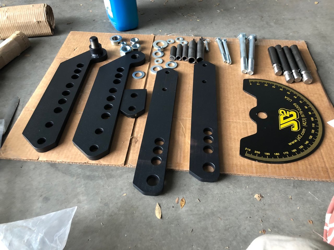

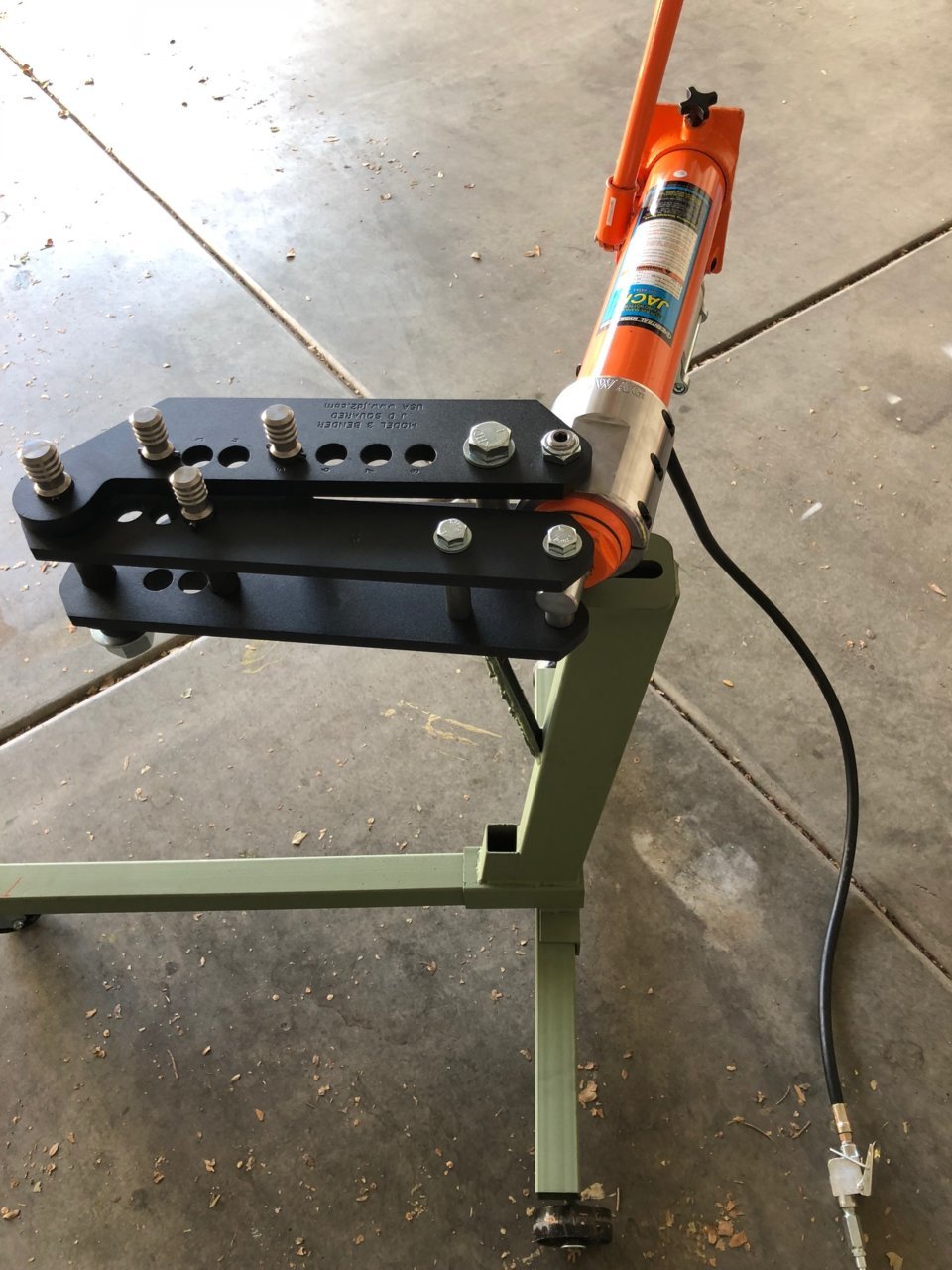

    JD2 Model 3 Bender
    This model is now discontinued. Really great tool, all American made. There's a tube bender in there somewhere lol
    Instead of mounting it on the floor on a fixed location, I decided to mount it on an engine stand to make it mobile. In order to the tube bender work in this configuration, it must be converted to full hydraulic, or air-over-hydraulic. I chose the later to keep costs down.
    Air-over-hydraulic is slow, but it works well. Full hydraulic is nice and fast! But I couldn't justify the expense. It is probably a must for fabricators and others who do this kind of work all the time. To make the air-over-hydraulic conversion, I used a custom mount from Swag Offroad.
    This is the 1.5" die. The die cost more than the bender itself :D. These dies are so well machined. JD2 makes good stuff. I also bough a 1" die.
    Learned the hard way that it is way cheaper to buy DOM in full sticks vs smaller pieces. Got five sticks, more than I needed, but saved money that way.

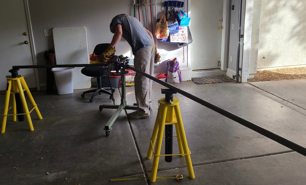

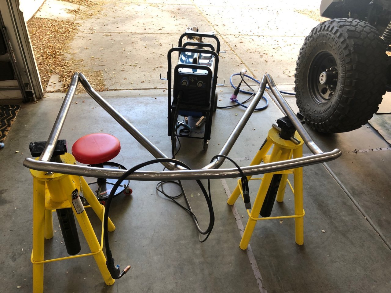

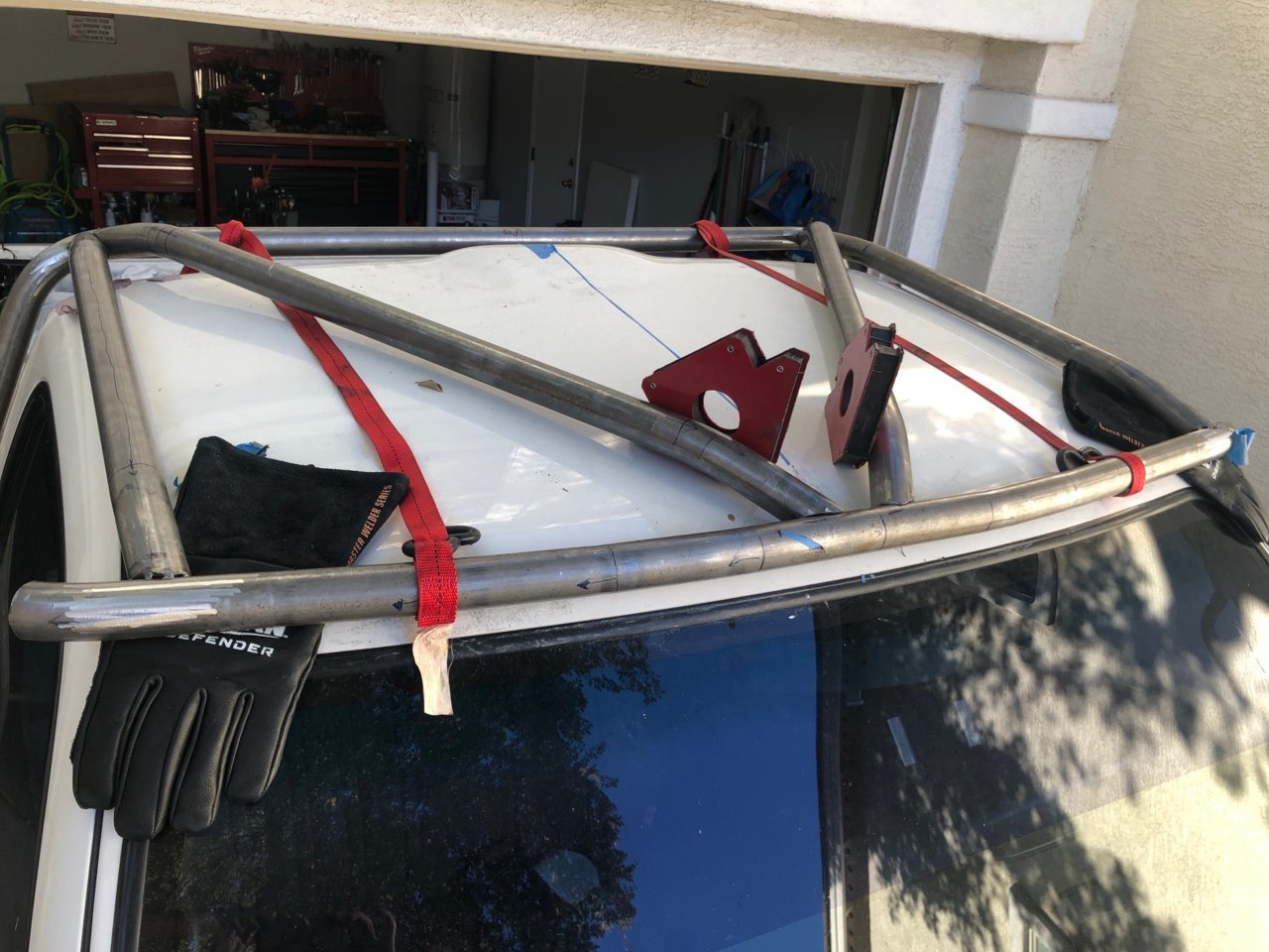

    Working on the main hoop. This is really a two-man job. Gotta make sure all the bends are level. This is trickier to do than it seems when working by yourself. Had to improvise with tall jack stands as my helpers lol. But it was a PITA moving that long piece in/out of the bender a bunch of times by myself while ensuring everything was level all the time in all areas.

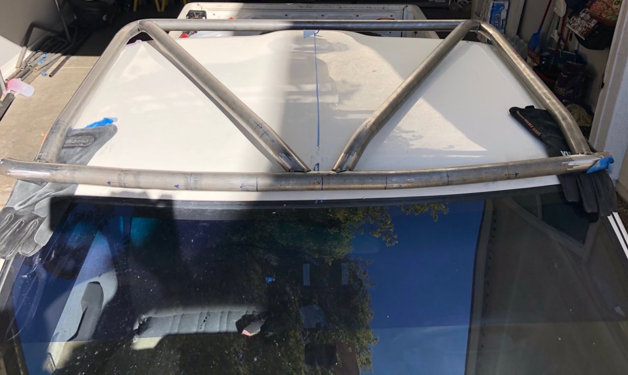

    Mock up of the main hoop. It took several tries until I got it where I wanted. Gotta go slow, under-bending is always better than the risk of over-bending. If you over-bend once, especially on a piece with multiple bends, even if you over-bend just a little bit, the entire piece gets ruined. The one are over-bent throws off all the other bends, then nothing fits where it should be. Ended up doing two iterations of the main hoop with the bends angled slightly differently between the two versions. Kept one hoop as spare for a future project.

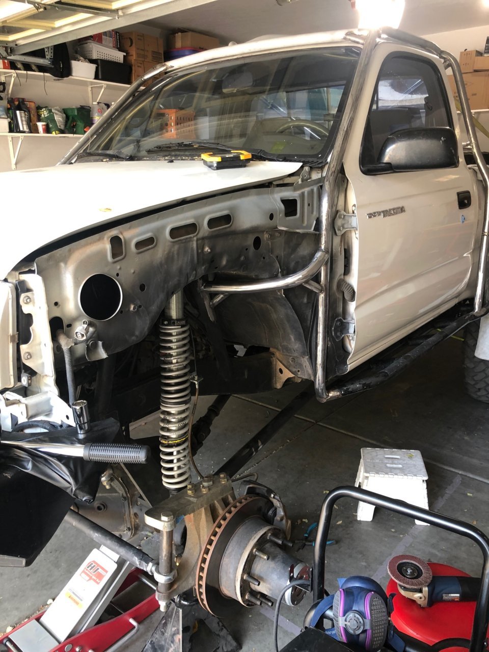

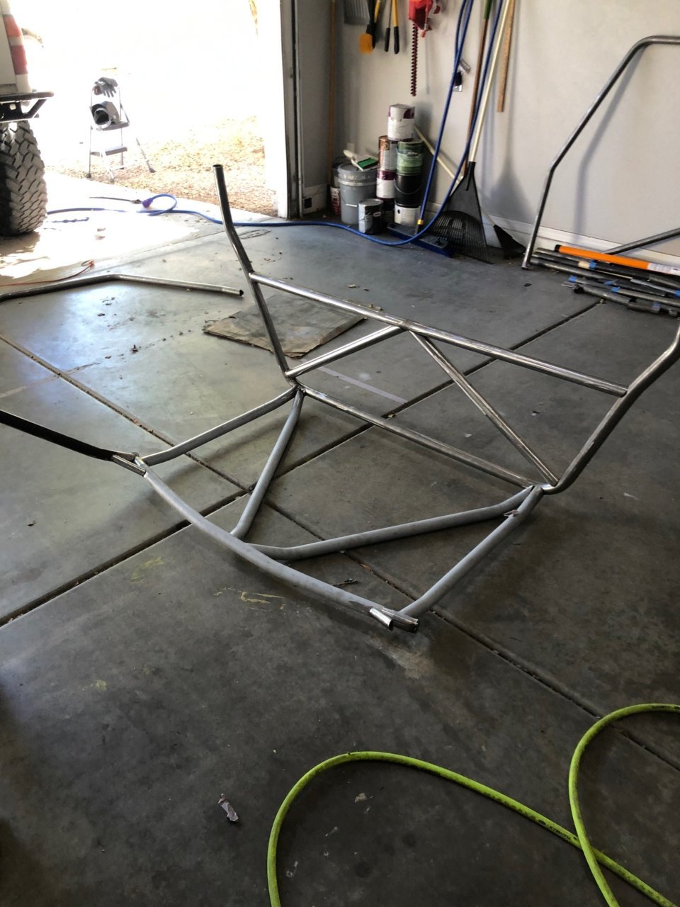

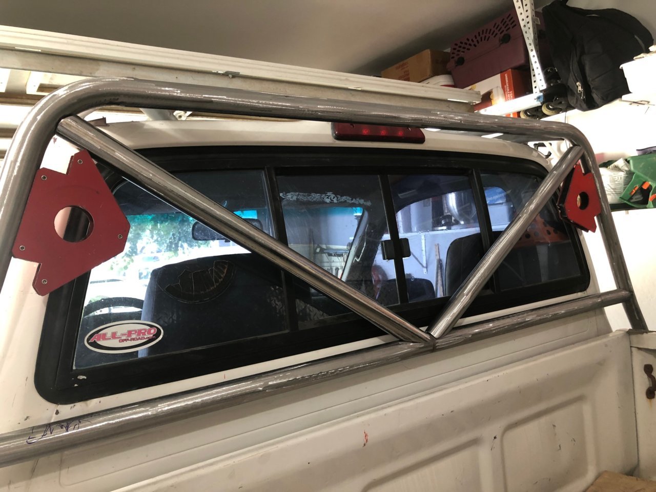

    Mock up of the back pieces.
    Mock up of the top pieces.
    Removed the top piece to fully weld it off the truck.
    Then removed the entire cage in one piece for final welding - minus one of the front legs that fell off when I removed the cage from the truck LOL.
    Some reinforcements.
    Decided to tie the front legs both to the rock slides and to the frame through the shock hoops.

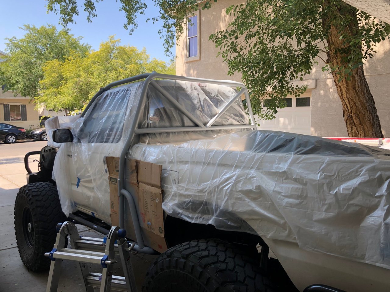

    Paint!!
    Finished.
    Used gloss black paint for the outer parts and flat black for inner parts for a more stealth look in there.

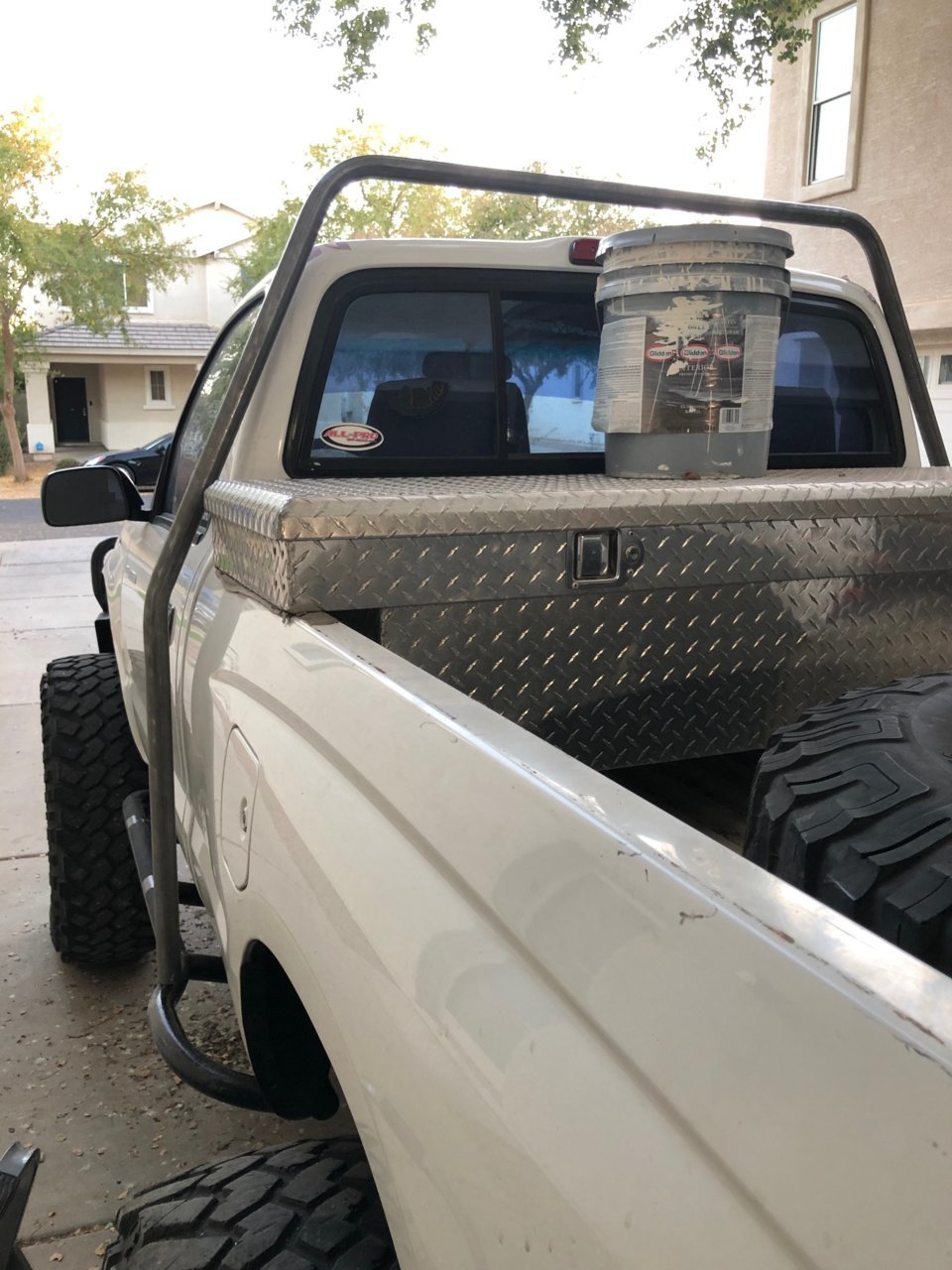

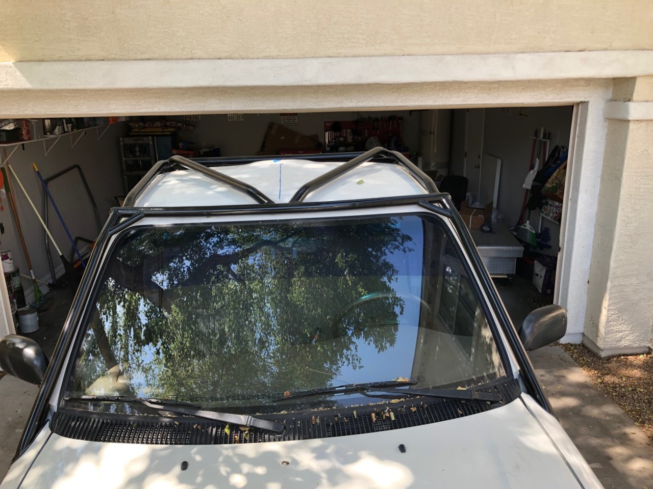

    I did a windshield cross bar, but ended up removing it. In order for the bar to clear the wipers and the hood, it had to be placed kind of high, and it obstructed my vision field too much. I drive the truck on the street so it bothered me. Who knows, maybe I would have gotten used to it eventually.
    Coincidently, all of a sudden, soon after I finished the cage my windshield develop a long crack! So good thing I removed the cross bar because now I have to replace the windshield, which is the original one BTW...23 year old windshield! Can't believe it lasted that long.
    Overall, I am satisfied with the end results. With a mandrel bender I would have been able to get all parts of the cage to follow all body lines perfectly. But I got them as close as I could with just the tube bender.

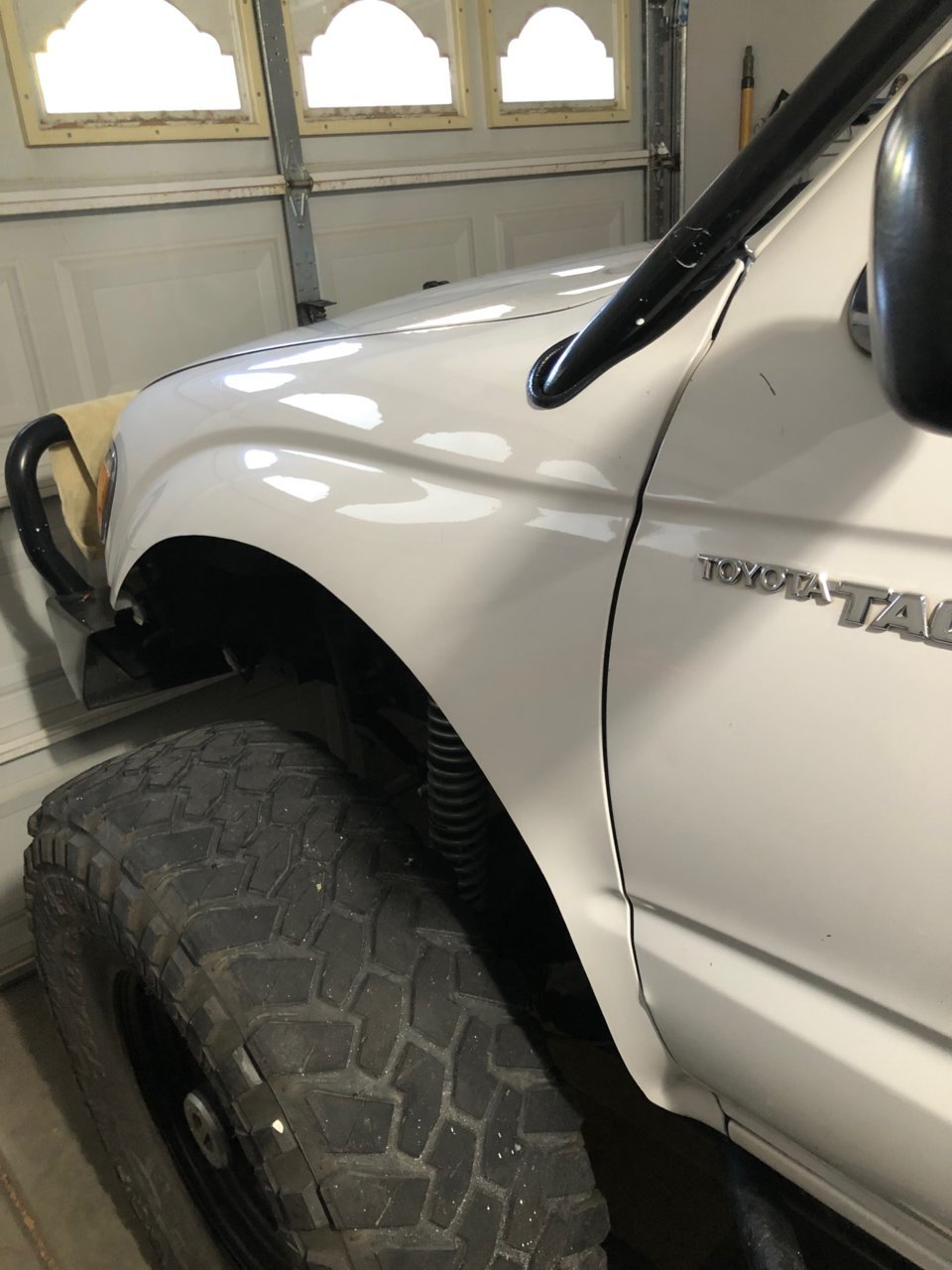

    Looks good bud, truck looks great as well. The holes through the fenders are clean. Did you run supports down to the frame in the back or is it just mounted to the sliders?

    The holes through the frame look better from a distance :D
    It is just mounted it to the sliders in the back.... for now.
    Running supports to the frame in the back would require me to butcher the bed, which I don't really want to do because I am considering a flat bed. Keeping the bed intact will make it easier to sell when I go flat bed.
    But yes, when I go flat bed, it will add more supports and triangulation tying things to the frame and bed itself.
