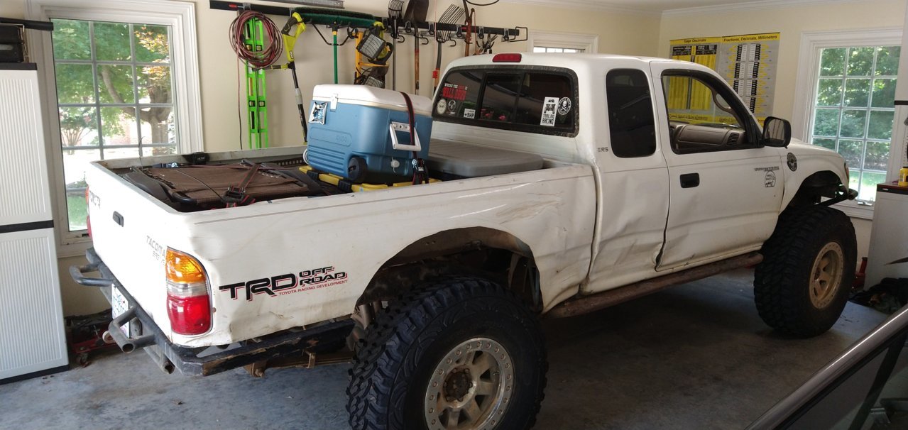

    Yup, had the 02 Tundra on one tons from around 07-12. That was a fun truck, and learned a lot while building it.
    Loved the PRP's I had except for two things... I should have got the reclining version because they would have just flat out fit better in a regular cab, and I wish I would have got at least tweed centers instead of the vinyl.... the back sweat from the Florida heat was unbearable lol.
    I should have elaborated more on the bed I had, I loved the look of the flat/tube bed (the second/last version that was on the truck, the first version with the major dovetail was just plain awful) and it was functional, but the biggest drawback of it here in Florida was all the mud and water that would come up between the fender skins and the tube bed itself.... you couldn't keep anything clean that was in the bed no matter what you did (full width axles made this worse too). So for me and the terrain I have to deal with, the stock bed would have been better in the long run for me. For someone that doesn't have to deal with mud and water like I do, a flat bed will make more sense. But, the truck was built to be a crawler originally, but my needs changed as time went on and the tube bed got less desirable. So take all that for what it's worth, don't let me dictate what you end up doing :rofl::D

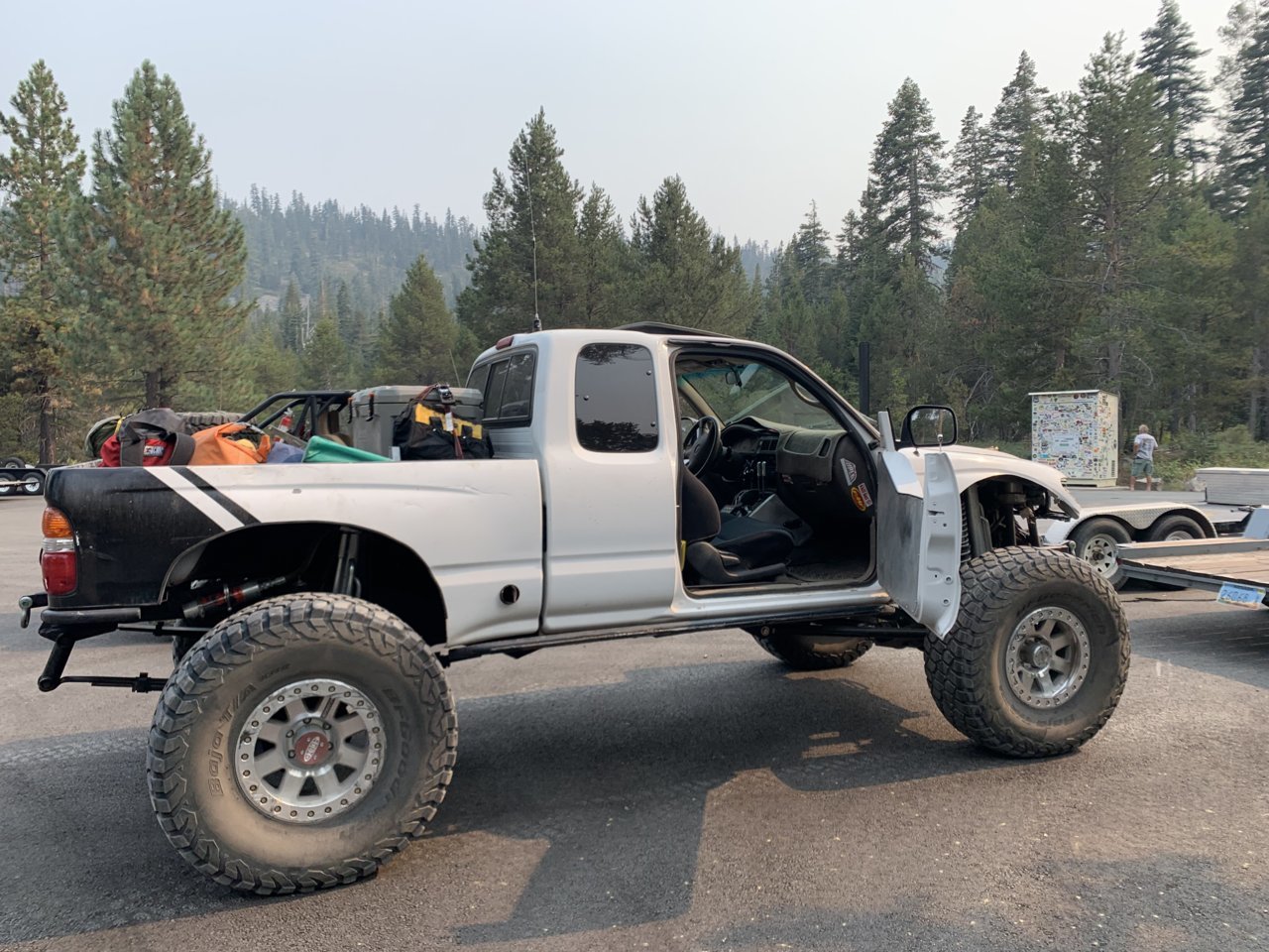

    I carry my 40" spare on the bed. I just drop it there and strap it down. No tire mounts or anything. Still enough room for a full size tool box and all the other crap :D. If I bobbed the bed, I wouldn't be able to carry the tool box at all.
    Your bobbed bed looks actually good!
    I personally do not like how reg cabs look with bobbed beds. It's just personal preference.

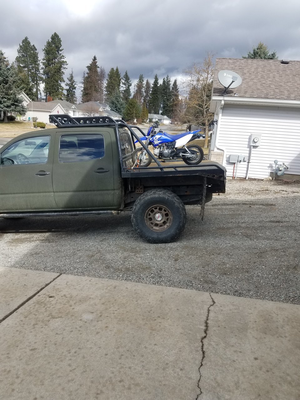

    Great build, I just got through the whole thread. I've had 2 flat beds on a couple of my pickups and once you have only you won't regret it. If you make one make sure you have plenty of places to tie stuff down have some dry storage too. The flat bed I built for my Tacoma has a 5' drawer that slides underneath the deck for storing tools and spare parts. Another thing about flat beds is they are a lot tougher than a stock bed. Hopefully this gives you a little perspective from someone who likes flat beds.

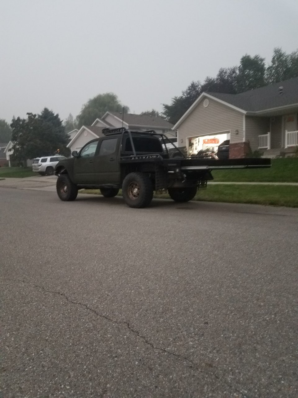

    mtnkid85 and 1999RegCab[OP] like this.

    Dang, when you mentioned a "drawer" I thought it was a little thing to put a few wrenches and hand tools. That things is massive! Love it.

    Go big right. The drawer is 5' long and the slides are good for 550lbs. I love flat beds. Its also nice to have the roof rack built into it also. It comes in handy when the bed is full of elk.20201016_212742.jpg

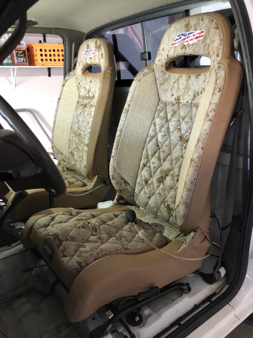

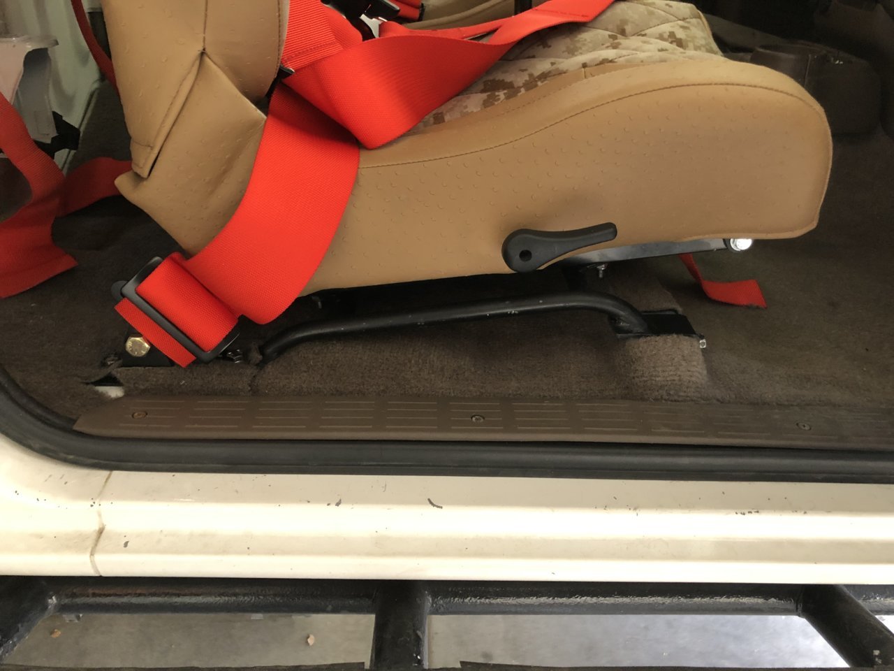

    Quick update on the PRP "Enduro Elite" seats.
    Installing these seats was a bit of a headache. The first issue I encountered was that the mounts PRP sent did not fit at all in the factory seat location. None of the holes aligned. Also the PRP seats were close to 2" taller than the factory bench seat, I had to do a significant amount of fabrication to the mounts on both sides to make the holes fit and to lower everything close factory height.
    Went with this specific model for a few reasons. First, it is their only reclining suspension seat (or was at the time of purchase) with a slider mechanism. I wanted a recliner with sliders because they provide multiple angles and positions, which makes it easier to fit the seats in a reg cab truck (fixed back seats have a very steep angle on the back rest that push the entire seat close to the steering wheel)
    Second, this seat model is a hybrid meant for off-road vehicles that are also driven on the street. The bolsters around the thigh area are shallow and not as aggressive as traditional race seats. This makes it easier to get in/out of the truck, which I can appreciate (the bolsters on the back rest are more aggressive than the thigh bolsters and keep your back in place quite tightly). To compensate for the shallow thigh bolsters, the bottom cushions are not flat. Instead, they have this high point in the foam right in the middle between your legs. It's hard to describe, but the high point locks your legs in place, as if you are on a horse saddle for lack of a better comparison. It is super comfortable, quite a clever idea from PRP.
    I ordered my seats with the back rest 4" taller than their standard option, and am so glad did. It looks like a many of these aftermarket seats are for short people lol. I really hate it when the back of seats are short without providing enough neck and head support. The opening for the harness is literally at my shoulder height. It is perfect for me. PRP has instructions on their website to help you measure seat heights before you custom order.
    I have the standard width. I am fairly thin guy (6' tall, 175lbs) and the seats are certainly on the narrow side. They work for me, but if you are a bigger fella, you may need to custom order wider seats. I believe most PRP seats have the option of 2" or 4" wider. Also added the old school hand pump to inflate the lumbar support. It's really cool and it inflates fast.
    Overall, I am very happy with these PRP seats so far. They are very comfortable. The customization options PRP offers are overwhelming. You could literally spend hours using their online builder coming up with various combinations of colors, fabrics, etc. I chose a military theme with their digital camo fabric, which is actually the same fabric the military uses. It is super strong but surprisingly comfortable. Then I chose tweed for the arm rests, and a textured tan vinyl with for all the other parts. Finished it up with an American flag for the logo.... 'cause we need more patriotic offroad seats out there:rofl:.
    Have to say that PRP is a great company to deal with. Very responsive customer service. And yep...the tweed is super nice and softer than it seems.

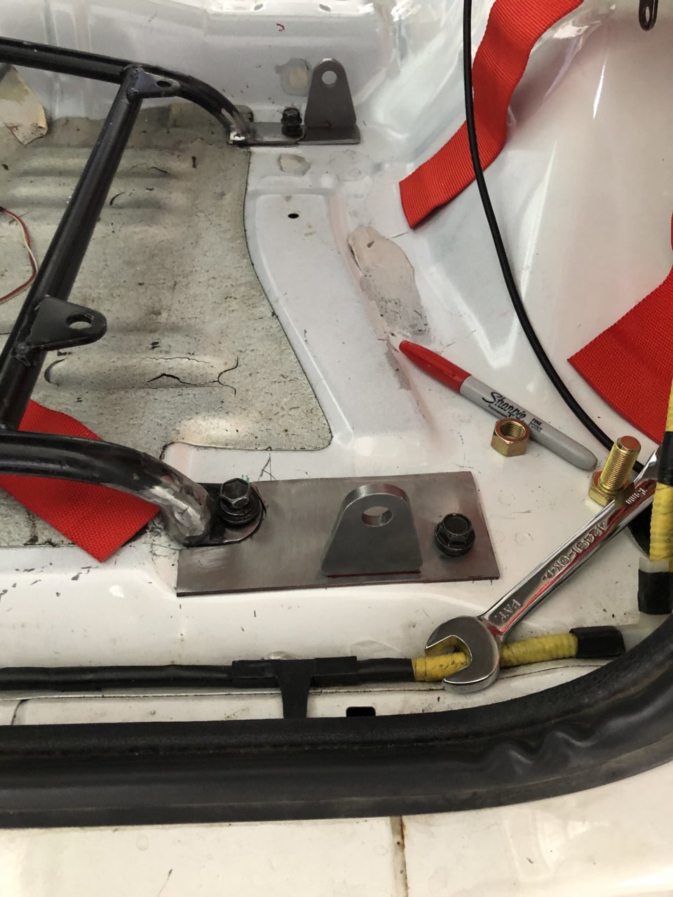

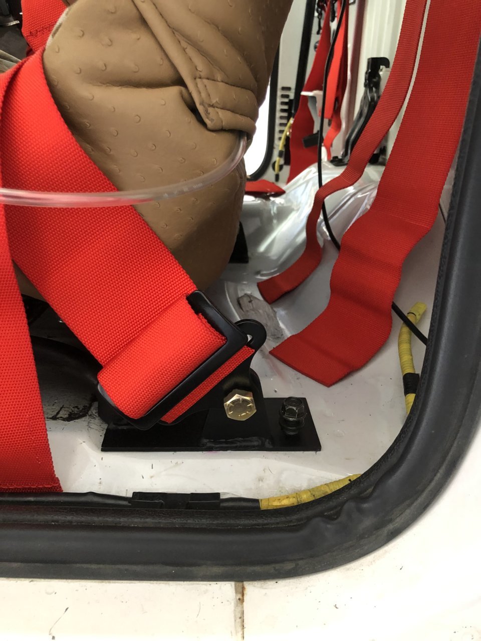

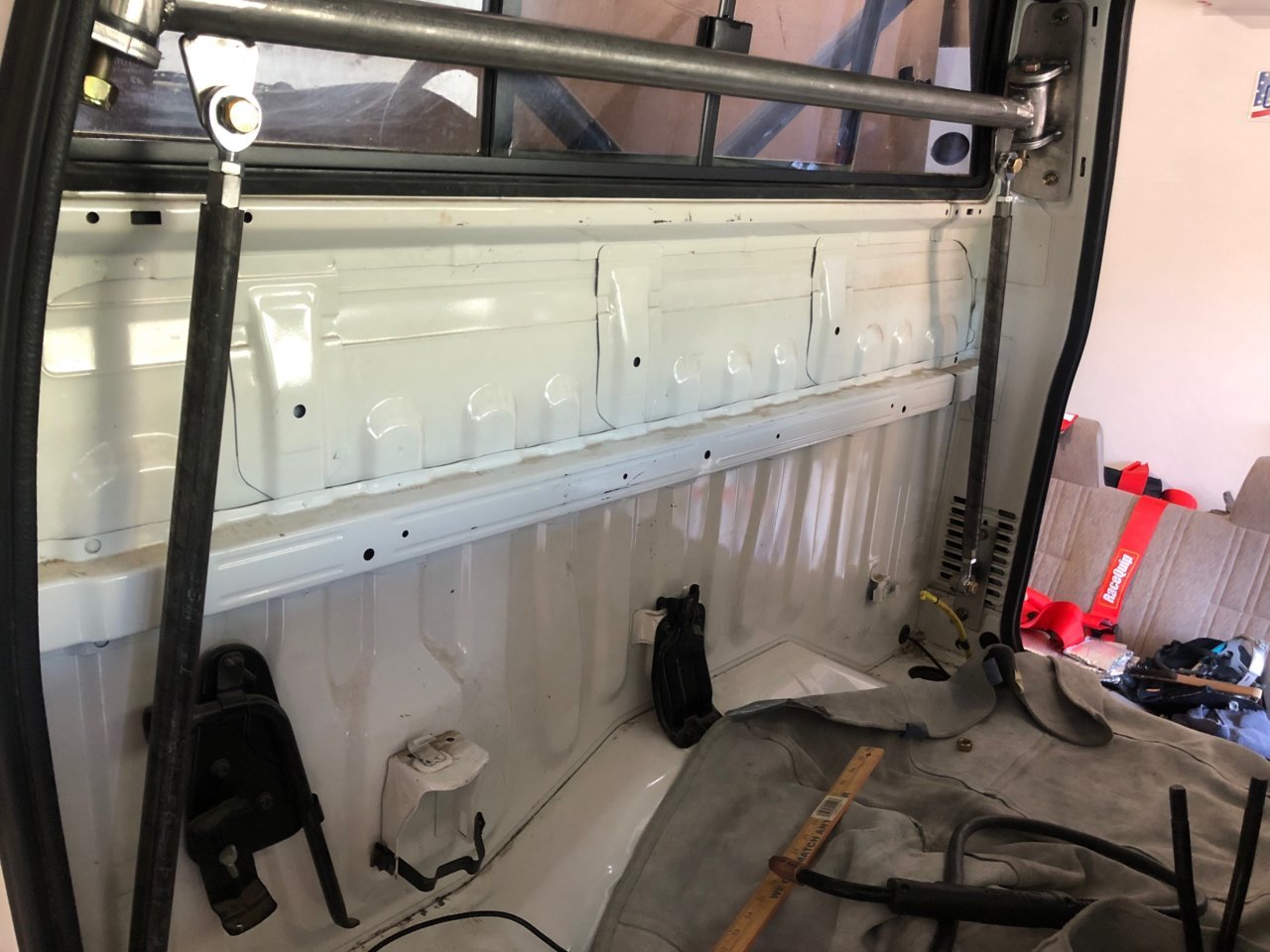

    Just when I thought I was done with the seat install, I realized I had not figured out how to attach the five point harness. And a new set of headaches unfolded right away.
    One negative thing of having an exo cage is that, if you want to install a multi-point harness, you are screwed since there's not an internal structure to attach the harness to. With an internal cage this is obviously not an issue.
    Race harnesses need to be installed within specific angles to prevent injuries. The shoulder straps in particular, are problematic because they are supposed to be installed at a very specific angle in relation to your shoulders.
    I underestimated how tricky installing a 5-point harness would be be with reclining seats/sliders - as opposed to fixed seats. With fixed seats, you set everything up and are done. With reclining seats, you have to account for changes you make when adjusting the seat.
    Decided to build a bolt-on, removable harness bar by borrowing an idea from @allenfab :D. Used the factory seatbelt mounting holes and bolts. It took a lot of measuring and mock up to get the bar on the right spot with some wiggle room to allow for the seat adjustments while keeping the shoulder straps at the right angles. The horizontal bar is 1.5" X .120 wall DOM, and it attaches to the factory seatbelt upper mounting holes through a custom plate and crossmember bushing sleeve kit. The crossmember kit is overkill because the tabs are too thick. But that's all I had in the garage lol.
    The two vertical bars are 1" X.120 DOM, and they attach to the factory lower seatbelt mounting holes through a custom plate with 1/2" heim joints on both ends. It looks like the the horizontal bar by itself would be plenty in terms of strength. But I figured it wouldn't hurt to have the vertical reinforcements at an angle to spread the load from the mounting locations. Now there are 8 mounting holes with bolts supporting everything vs just four if I just used the horizontal bar by itself.
    All plates use the factory bolts. Have to finish welding everything, then remove, paint, re-install. But it looks like soon I'll be able to get the 5-point harness installed finally.
    allenfab, jubei, Duckfatt and 3 others like this.

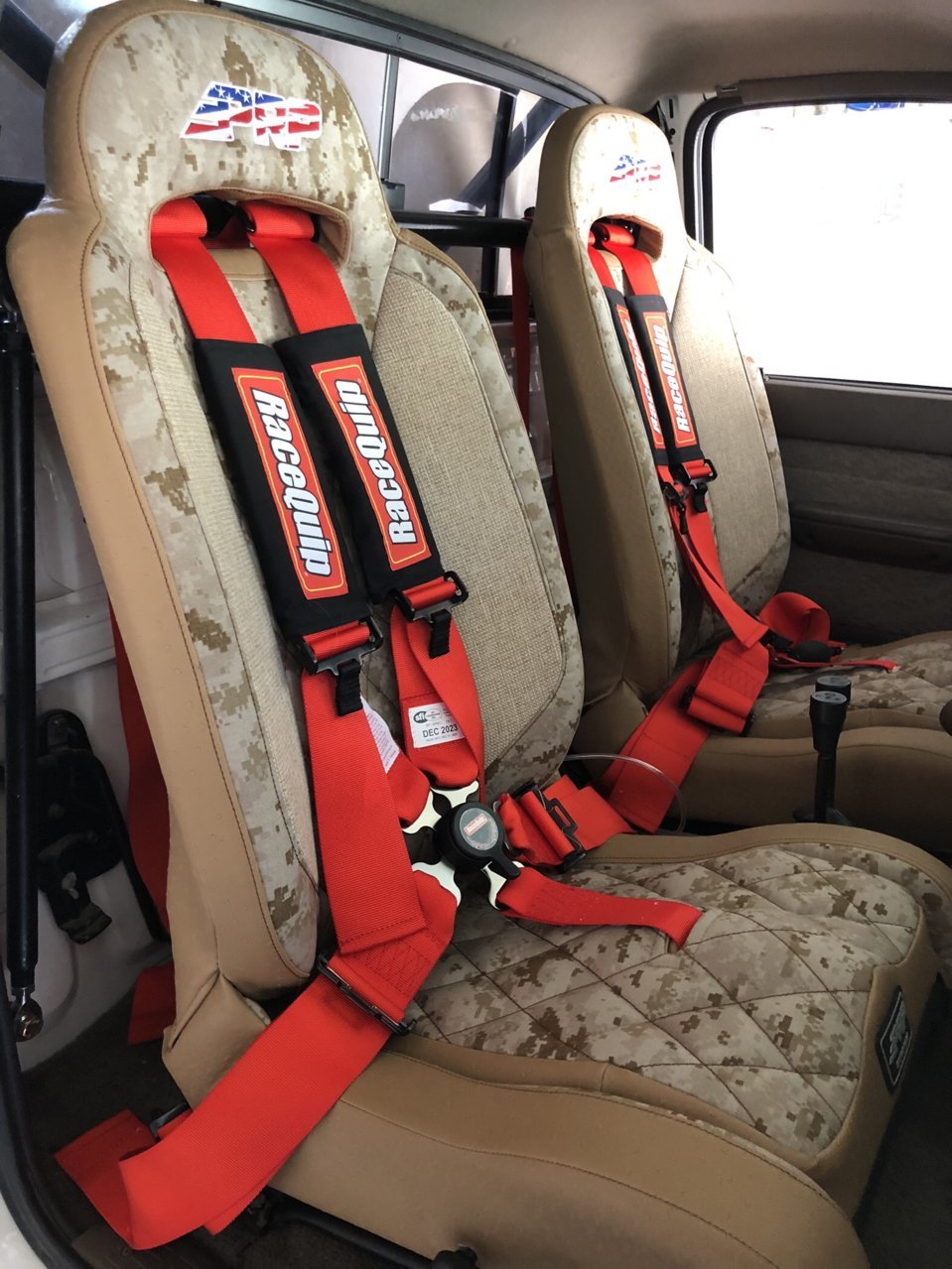

    Finally got done installing the 5-point harness. It was tricky, but I am happy with the final results especially after reinstalling the carpet. From 5 feet away it almost looks like a factory installed option lol.
    What a huge difference a harness makes. Not sure why I waited this long. It is a much more pleasant - and safer - wheeling experience when you are not moving around the seat so much. Also...if you are thinking about a harness, I highly recommend to pay extra for the "cam lock" style. It is double the price (or more) of the latch/link option. But the cam lock style makes the process of strapping in/out so much easier and faster.
