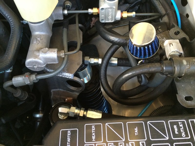

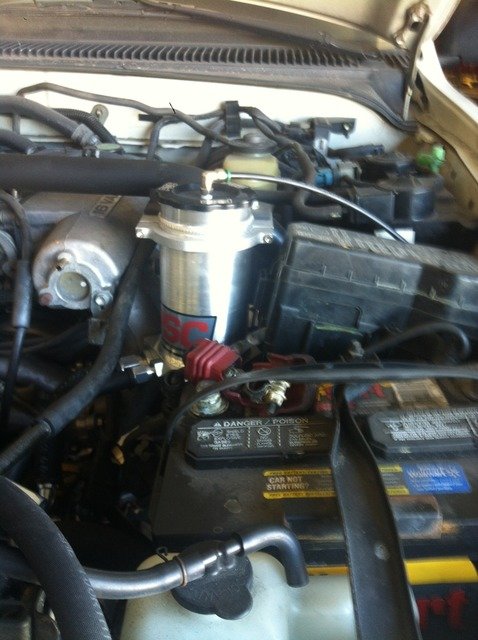

    Here is a pic of my DS shock tower.
    I did have to change the reservoir hose configuration after the Fox CO install but everything is where it needs to be.
    Looking good man.

    I like what you did there. It looks really good. Those towers are really nice too.
    I see the top of your coilover sits under the master cylinder. Mine sits farther to the front.

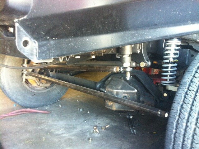

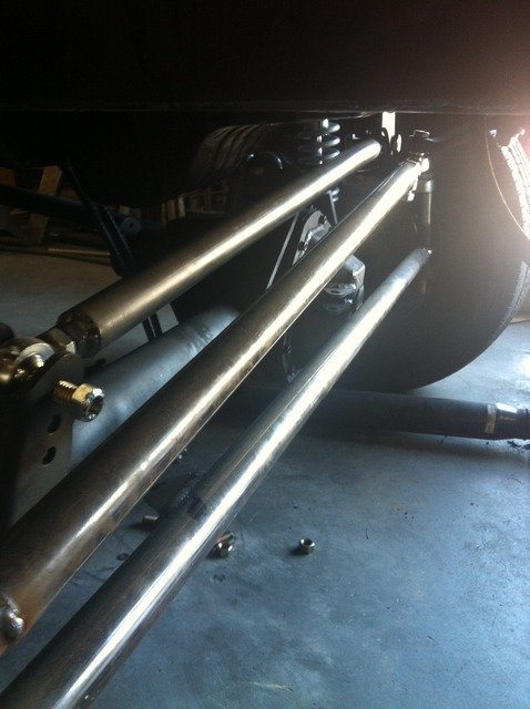

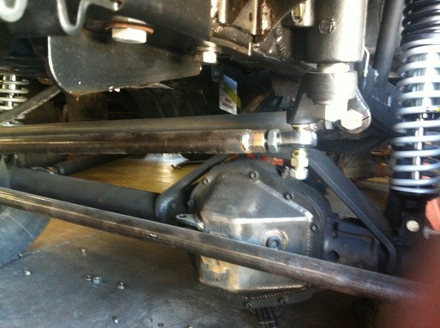

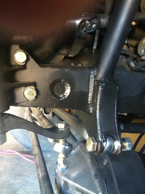

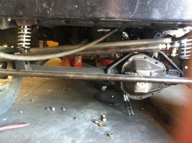

    Front end is done. Only thing left is installing the ram and bleeding the system.
    The angle between the panhard bar and drag link turned out great. They are as parallel as they can be:
    C6871D57-F143-40F6-B7A4-674AA59AA5D0_zps_893d7e4d6dce6ef86e28febd9325a851f7341a53.jpg

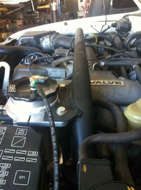

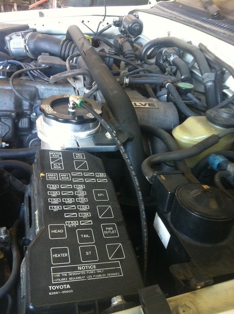

    Power steering reservoir mounted on the side of intake runners

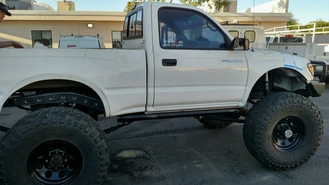

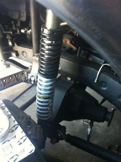

    Mock up coils, these are too soft. Different ones are coming in:
    6536CCAE-C8CA-4E5C-AF20-963494D1B0D0_zps_f17023950104c94915abfe4254b2cc7e39601d36.jpg
    And here's the final product: truck sitting on 31" tires LOL :D
    C21CBEF0-2512-461B-9B7D-90C6A605E82C_zps_0e40e0bd3619a4bf990749cad3a6b7b1bd770f21.jpg

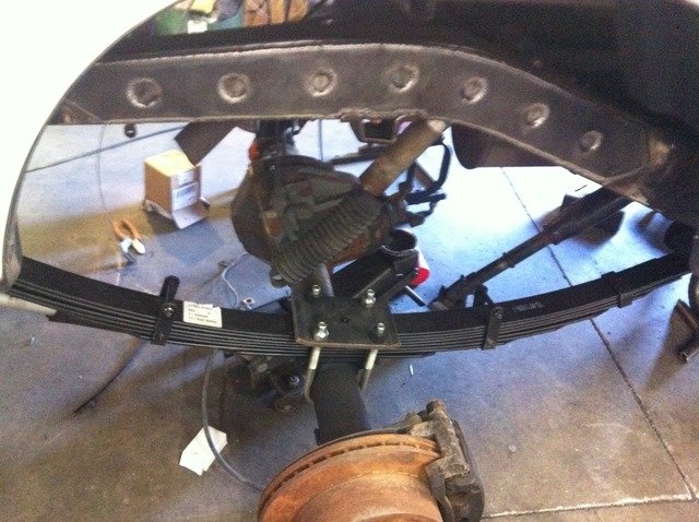

    Rear end is done - minus the shocks. Now waiting on drive shafts and rear shocks. When those are installed, she will be rolled out of the shop for a leg stretch with the fork lift for the final dialing of the suspension.

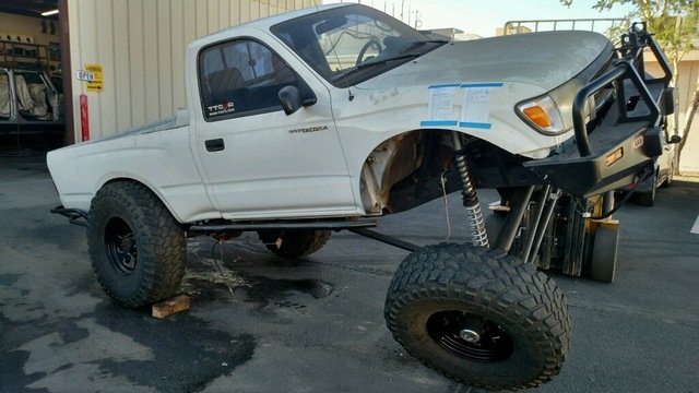

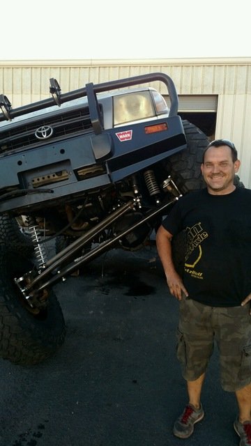

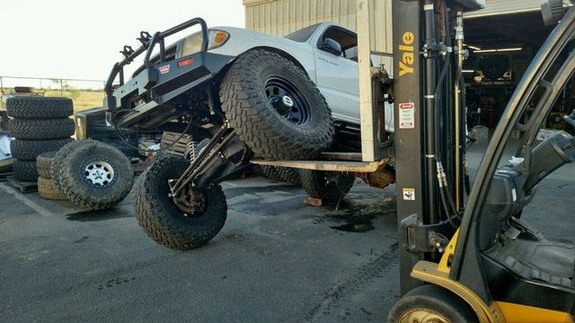

    So today she got her legs stretched wide open for the first time lol
    A2BE7C2B-69F9-45C8-8465-F2DE5A2FD9C0_zps_abe022ace7b497d20e25c76e617ac6897a39a6b3.jpg
    5B235DE7-D685-4D9C-9338-C2863DFAFF1D_zps_319deced519be7f2427b62241dbbf48a7d6fe9f8.jpg
    D719C2AB-D538-4586-8726-A67034681955_zps_259a987895b1d51cab8bea157efaba6c3ef0f52d.jpg
    C430289D-BF60-46B2-8365-23EF057DE937_zps_19a054518d0710b3ea4e5d1e89e9f24a04e51a9d.jpg
    E0D05498-6CA5-4EB0-9C08-7623D61E8E14_zps_e7ba7c259a7320d0801be0e8383ecdfa7f0c2caf.jpg
    Last pic for now. Notice the top of the head of my fab guy in relation to the driver front tire and bottom corner of the bumper. Keep in mind that's a 40" tire, and he is standing straight. Both tires in the rear are flat on the ground. By the way, He really knows his craft; great fabricator.
    This leg stretch was primarily to check measurements for drive shafts. Fine tuning of the suspension is next.
