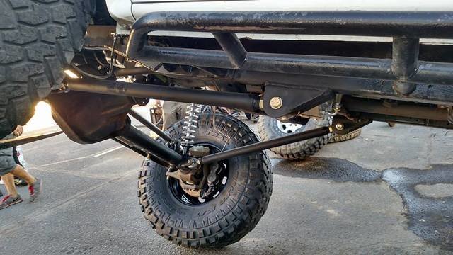

    A few more pics of the leg flexing with the fork lift:
    The drag link and panhard very parallel. Also the oil pan had to be massaged with big ass hammer to make room for the steering linkage :D

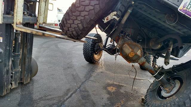

    Rear flexed better than I had expected. Again, those are 40" tires - though in some pics they look like 37"s. Front tire is stuffed pretty good as the rear stretches

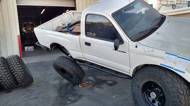

    Can't really be seen on this pic, but the shackle mounts were built through the frame with some plating. I'll try to get some pics later on. Also, the front spring mount were moved farther forward than the factory location. These springs are longer than factory springs.
    14316742_979269345516785_869007384943970_3d0780676bc9c42c7942a71dc83e033d70bc313a.jpg
    This pic shows the flex potential of the rear suspension. Again, those are big ass tires. Please ignore the old shocks in the pic. Those will be replaced with new bilsteins in a /\ configuration.

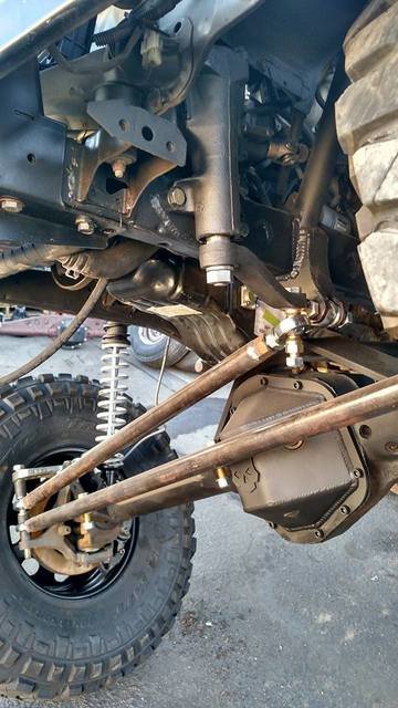

    Can't remember what ended up being the lenght of the lower links....43" something inches i think (need to measure again to confirm)

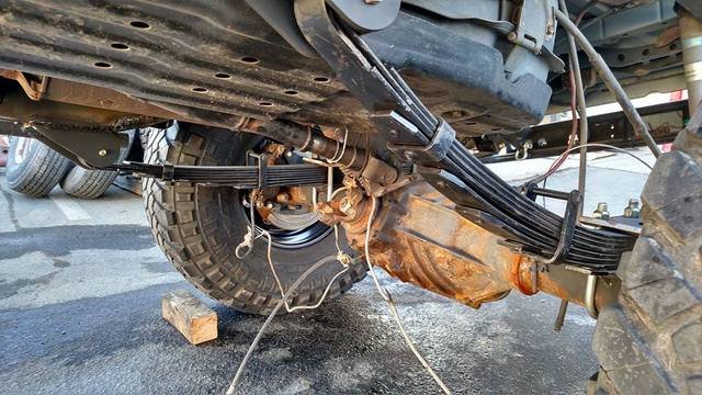

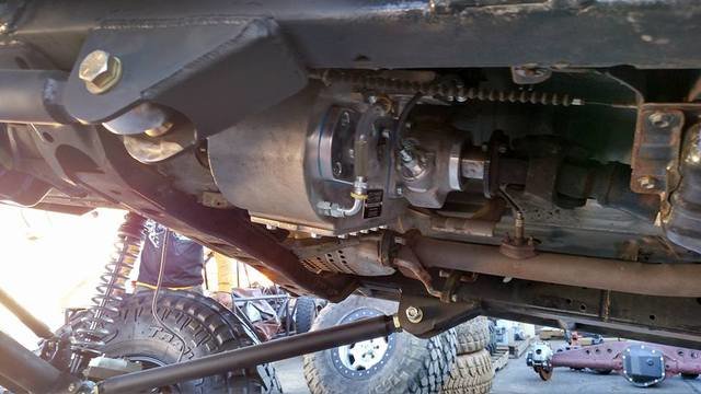

    Another pic of the 2spd Atlas. As you can see, the 2spd atlas is not that much bigger than the factory chain driven case. It actually sits 1" higher than the factory case was lol.

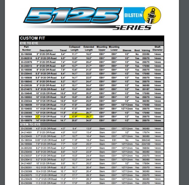

    Regarding the rear shocks.....the 12" bilsteins might work just fine in the factory staggered config....you still have leafpacks back there and 12" of travel just might cover the range you need. They say the staggered front /rear axle config helps on axle wrap and might offer some sway resistance. Something to think about.

    Interesting. I didn't know that the staggered shock design can help prevent axle wrap. However, The leaf springs mounts are not in the stock location anymore. So if I keep the shoks staggered I'll have to move upper shock mounts anyway.
    On the other hand, i've read that setting the shocks in the /\ configuration makes for a better ride and allow more flex. Don't really know...
    I'm going with 12" Bilsteins by the way.

    Ya, you need to have the fork lift lift the wheel again and measure the spot where the shock would be on the compressed side and also on the drooped side......
    Tape measure time.....
    For example, if you measure 19" on the compressed leafpack side and 29 on the extended side then the staggered config is ok to use with no loss of droop. By the way, excessive droop is over-rated. ;)
    the heavy duty valved shock is the 33-185569 part number fyi
