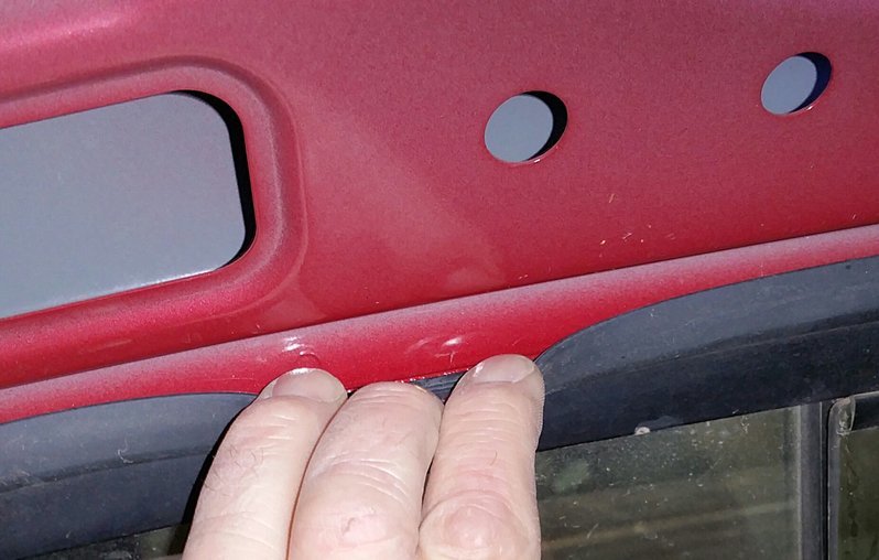

    On my 00 and 98 the headliner tucks under that rubber window seal about 1/8 -1/4" and then there's 2 plastic round clips in the back.Took those down last and slid headliner forward out from under the rubber.
    Going back up carefully tucked the back in with a putty knife in after it just had the visor clips holding it in front.
    I have'nt taken a rear sliding window out yet but will get to that probably this weekend.I did read how to do it in the FSM.

    Clips under the rear window rubber gasket? That pic does look different then mine.

    Yea. Theres clips running up under the trim. It goes in quite a ways. You cant remove with removing window. Ive tried...

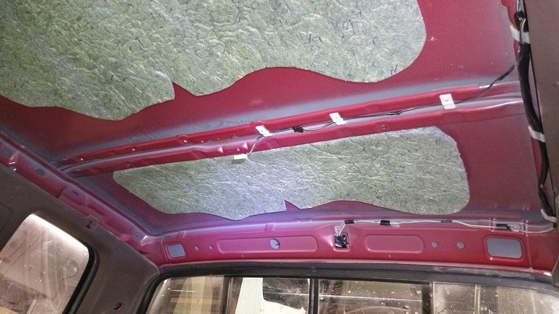

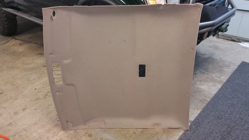

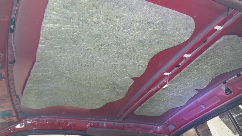

    I pulled that headliner from my parts truck last night and did some PN research on them.The one from my ext cab parts truck I just pulled is a 63310-04040 E1 (oak) and has the 3 cutouts for the map lights in the front. The one in my ext cab green truck is a 63310-04030 E1 (oak)and I don't have the map light option and have 1 cutout. These are the part numbers for 98-01's ext cab oak color ones.
    Here's some pics as there are factory sound deaden pads glued to the roof under there too. I took my pads off and lined with dynamat and 10mm closed cell foam when I had mine down on the green truck to sound deaden.
    The part numbers for the 95-97's and the 02-04's are different then the 98-01's but not sure what the whole difference is or if they are interchangeable.Yep, yours is different then mine as there was no clips holding it in,just tucks under the rear rubber window trim .

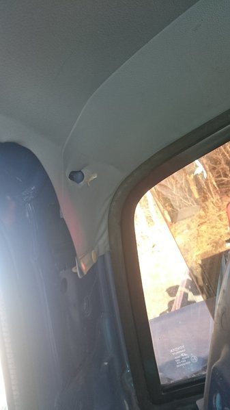

    Thanks for the info. I am missing the front pillar covers and the drivers side plastic piece that covers the 3 mirror bolts.
