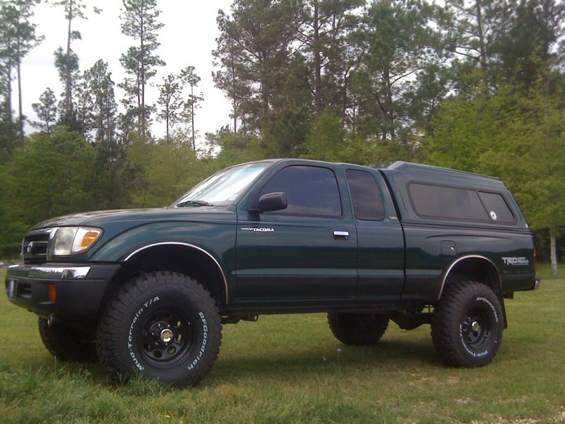

  3. May 19, 2015 at 5:19 AM
    Brake Weight
    Brake Weight But it hasn't rained in weeks...I'll make it.
    Jan 27, 2015
    #147363
    2,879
    Deep South near the Third Coast
    Taco pulling 33s and a B6 pushing 33psi
    Weld on sliders, fiberglass shell, 12k winch in an Elite Offroad bumper, front Aussie Lunchbox
    33/1050-15 on a '99. 15x8 with -12mm offset and I don't remember the backspacing in inches. I needed a 1/4" spacer to clear the calipers. Look online at/for several different wheel offset calculators before making your decision. This rubs at about 3/4 turn and only the outside edge of the tread against the outside corner on the rear side of the front fender wells and only when compressed.
    98sr54x4[OP] likes this.

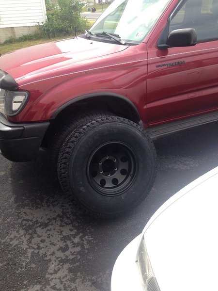

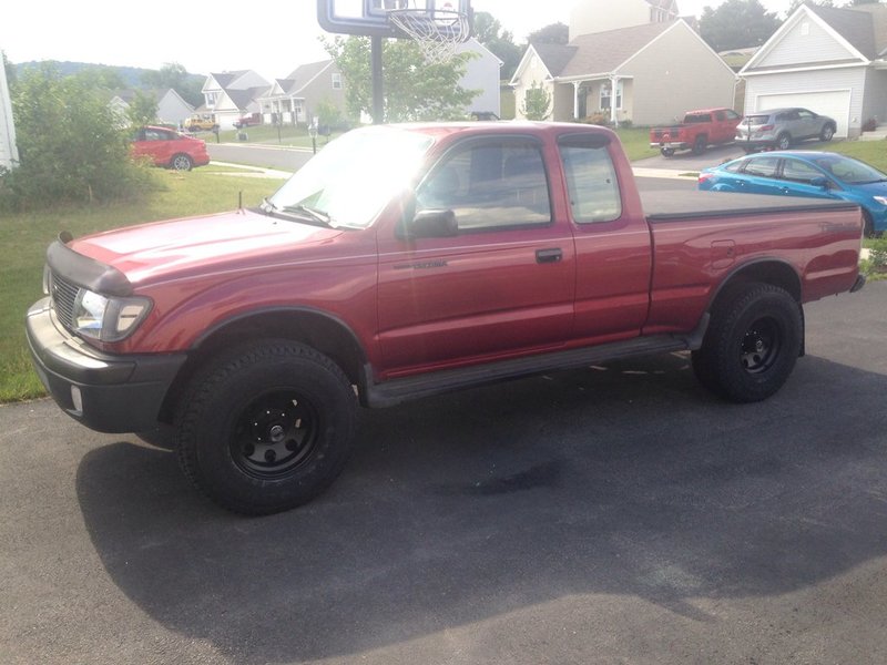

  5. May 30, 2015 at 4:04 PM
    98sr54x4
    98sr54x4 [OP] Member
    Feb 15, 2015
    #148751
    21
    Pennsylvannia
    1998 sr5
  6. May 30, 2015 at 5:12 PM
    Brake Weight
    Jan 27, 2015
    #147363
    2,879
    What's the sizing?
  7. May 30, 2015 at 6:21 PM
    98sr54x4
    Feb 15, 2015
    #148751
    21
    Pennsylvannia
    1998 sr5
    31x10.5x15
  8. May 30, 2015 at 7:38 PM
    Brake Weight
    Jan 27, 2015
    #147363
    2,879
    Looks good. What wheels are those? They look like aluminum.
  9. May 31, 2015 at 9:56 AM
    98sr54x4
    Feb 15, 2015
    #148751
    21
    Pennsylvannia
    1998 sr5
    American racing baja 15x8
