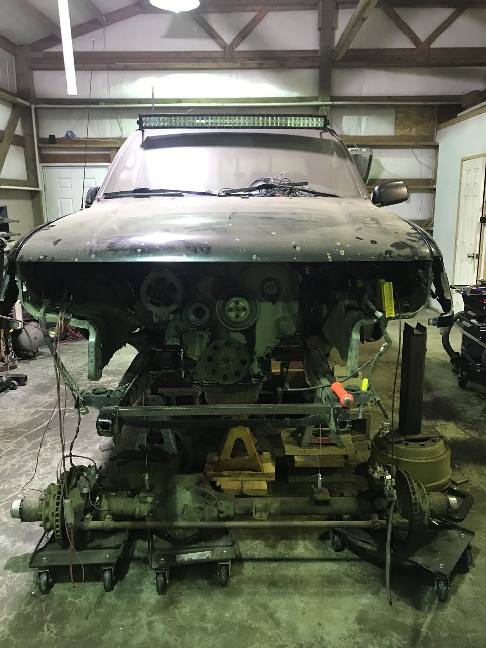

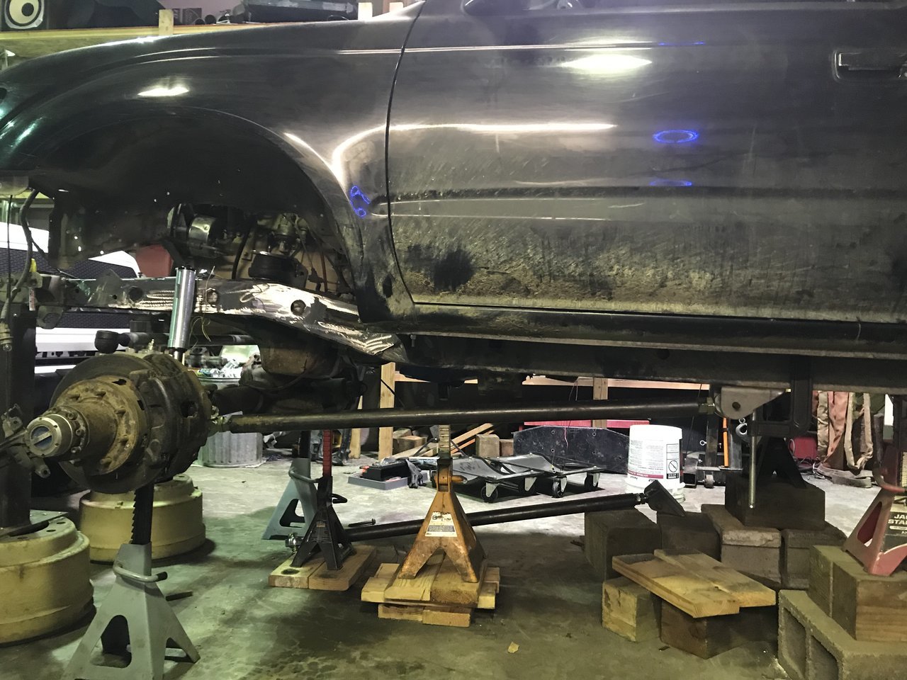

    98 4bt swapped on tons and 43’s

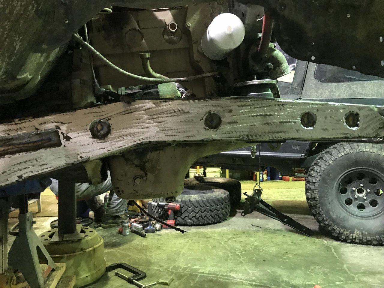

    So long story short, I was planning on dual cases, 1 tons and 38’s with the factory 3.4 v6.
    But that quickly escalated to what it is becoming now.
    4bta 3.9L Cummins.
    T19 ford 4 speed
    Atlas 4
    King pin Chevy Dana 60 (4:10)
    Corporate 14 bolt (4:10)
    3 link front
    Leafed rear (for now)...
    Plan on running 42” iroks or 43” tsl sx2’s

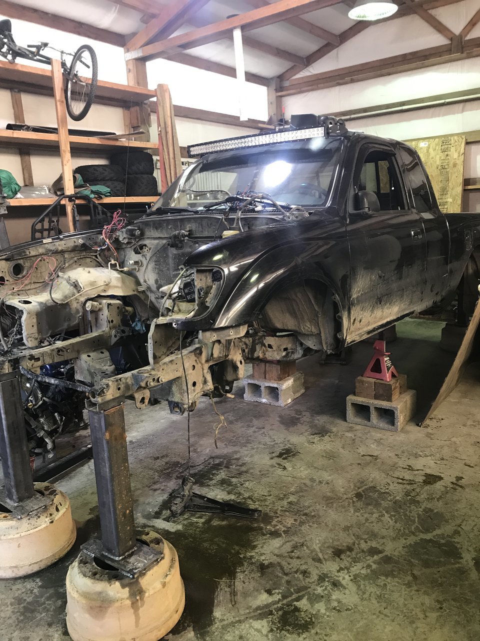

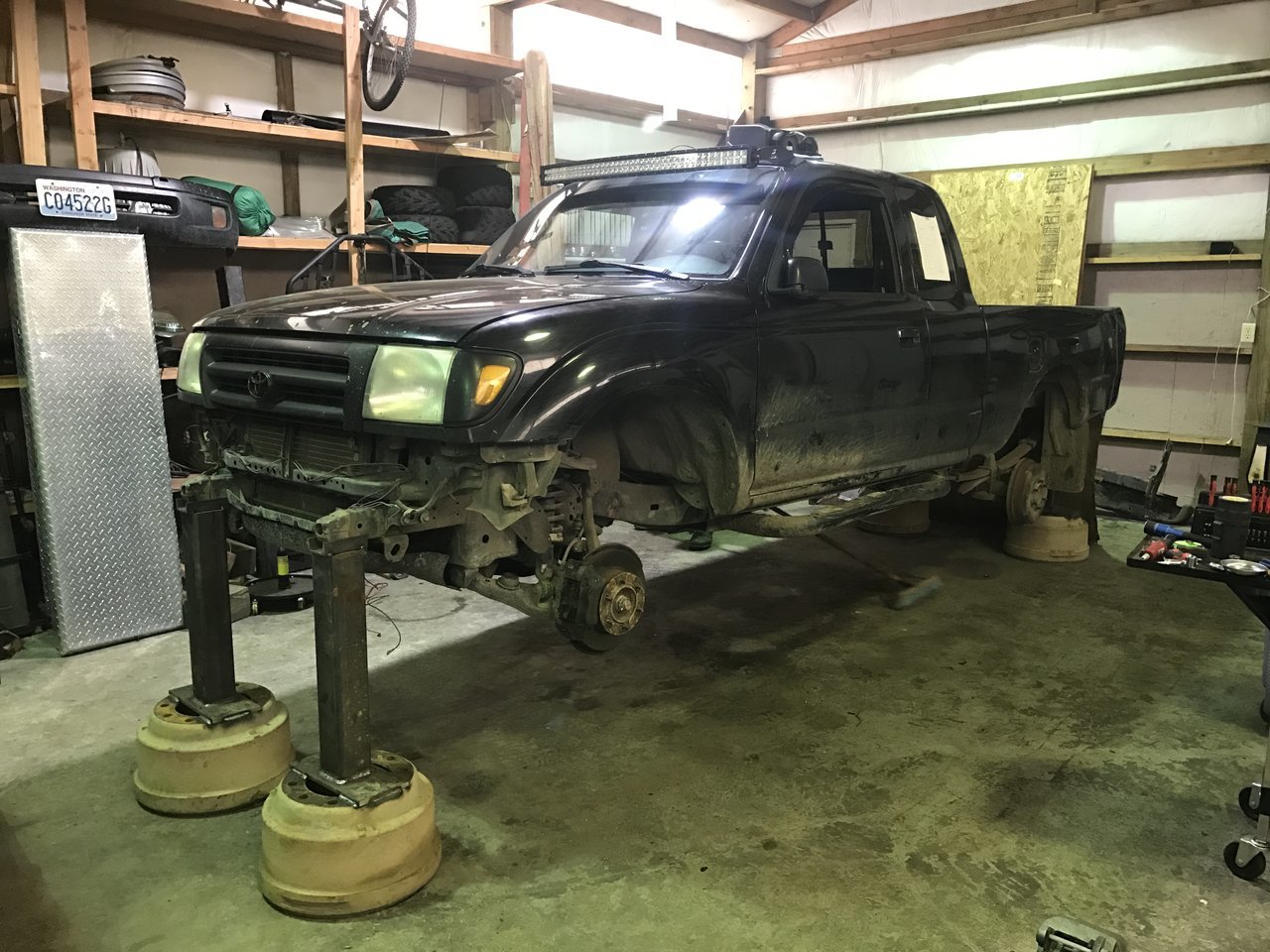

    Here’s the pictures I have so far.
    Day before I started tear down.
    First day of teardown.

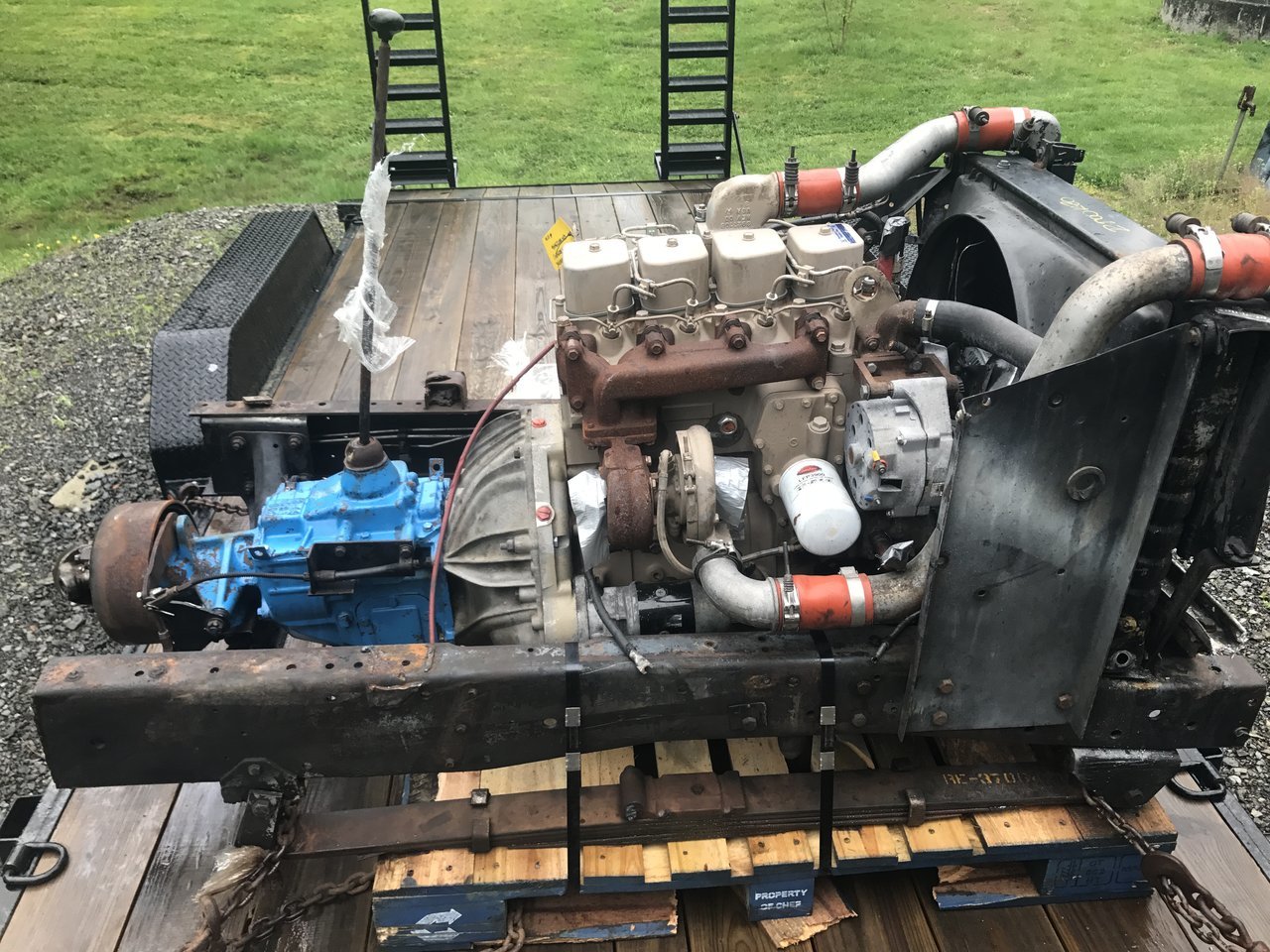

    Almost clean ready for frame plates
    Engine and trans arrived

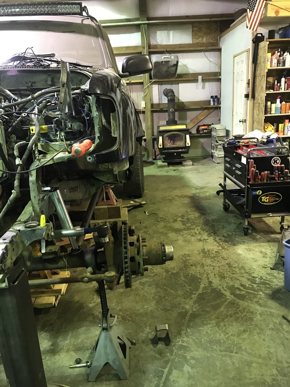

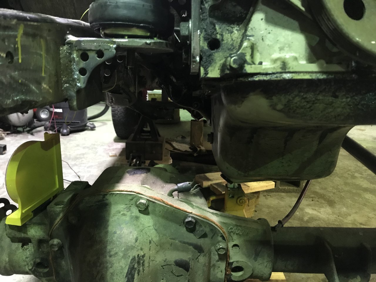

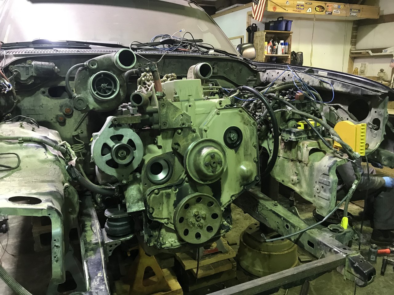

    Jump ahead a few months. Motor mount mock up and test fitting.
    Mounts pretty much done.

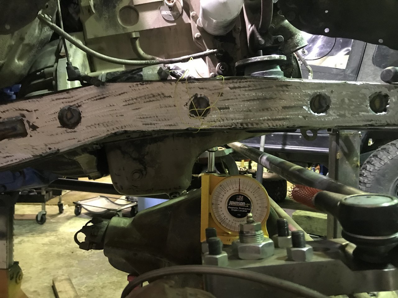

    Currently mocking up front axle links

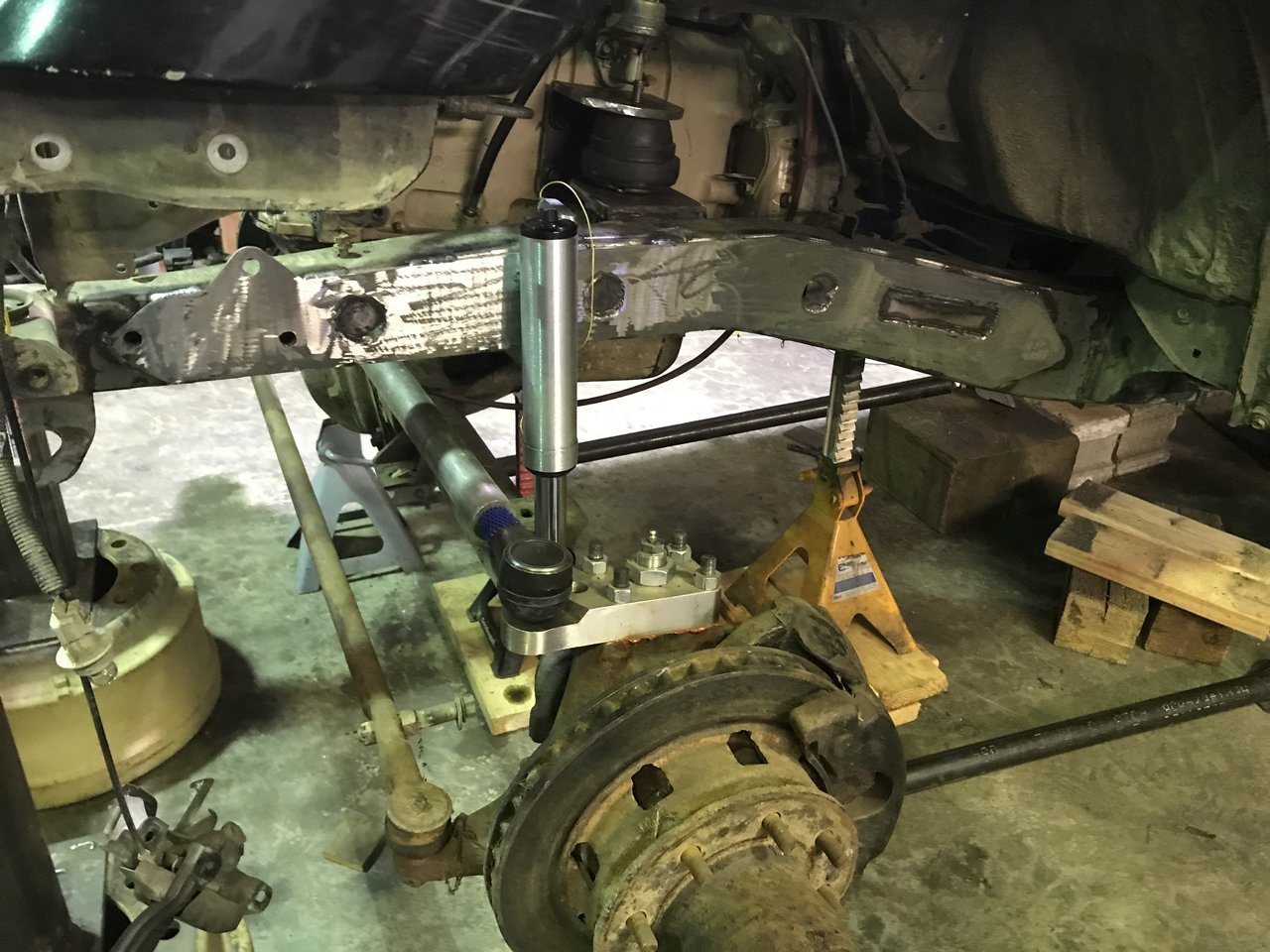

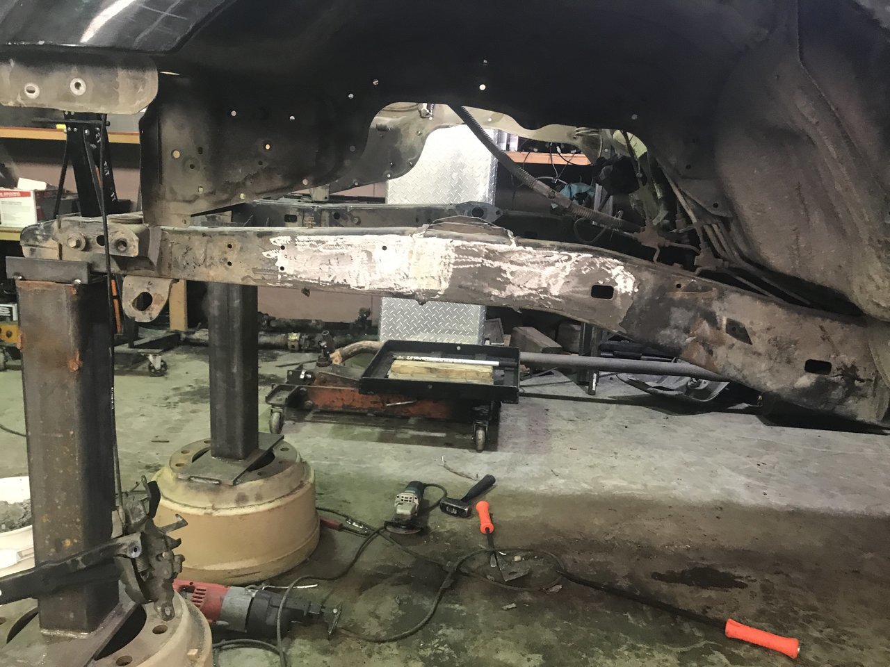

    Decided before I fully weld up the link bars I’m going to insert them either with a solid bar or another tube to help strengthen them since they are 55” eye to eye. Also figure this truck will be really heavy and I really don’t want to bend them when on the trail.
    Plan on making this truck somewhat streetable so should be interesting

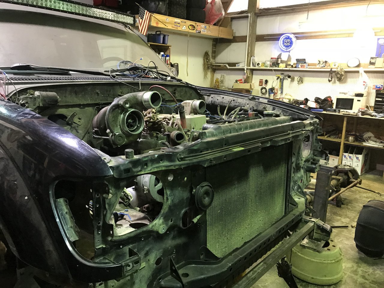

    It will be a Diesel. Currently has a 3.9L 4bta Cummins in it. I just finished up the engine mounts and the engine is sitting in the truck. Trying to find info on the trucks wiring so I can get lights working again and then I’ll get the engine running in the truck.

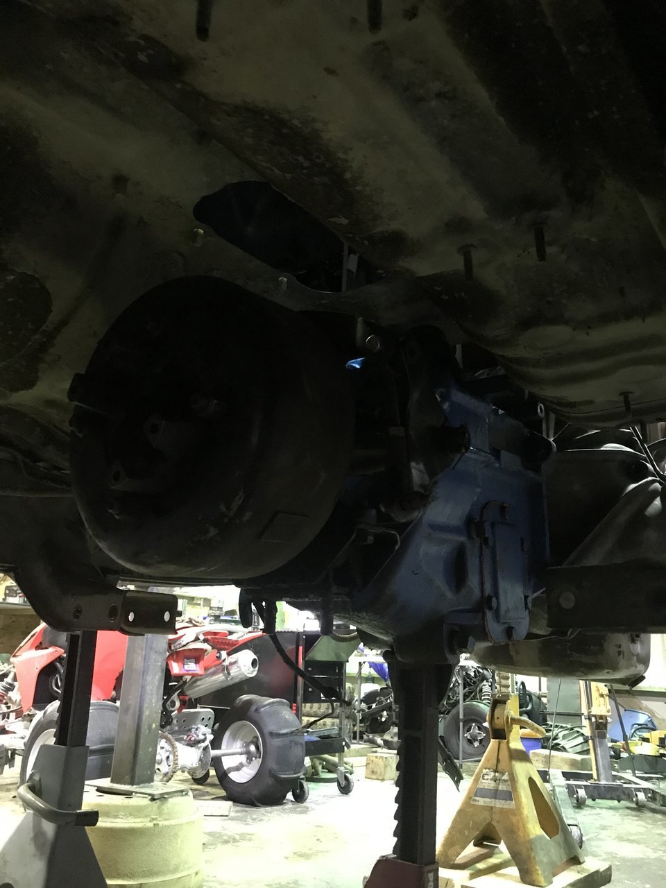

    Hard to see but the shifter is going to come out directly under the dash.... definitely going to have to custom bend a shifter.
    Still need to tear down the trans and put the new shaft and adapter plate on so I can attach the transfer case.
