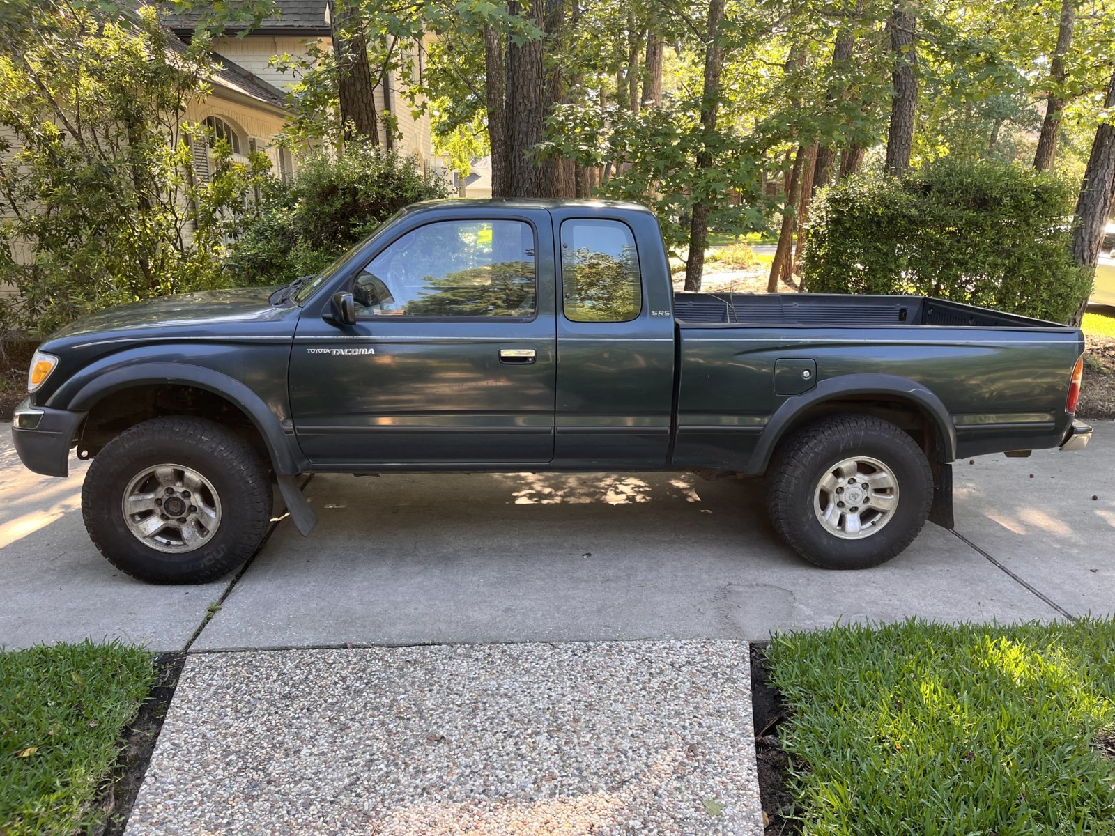

    Hey guys,
    Just did an overhaul on the front end/suspension.
    -Bilstein 4600’s all around with MOOG 81102 springs for front coilovers.
    -New OEM Rack/Pinion
    -Sway bar Links
    -Lower Control Arms
    -Upper Ball Joints
    -CV Shafts
    -Outer Tie Rods

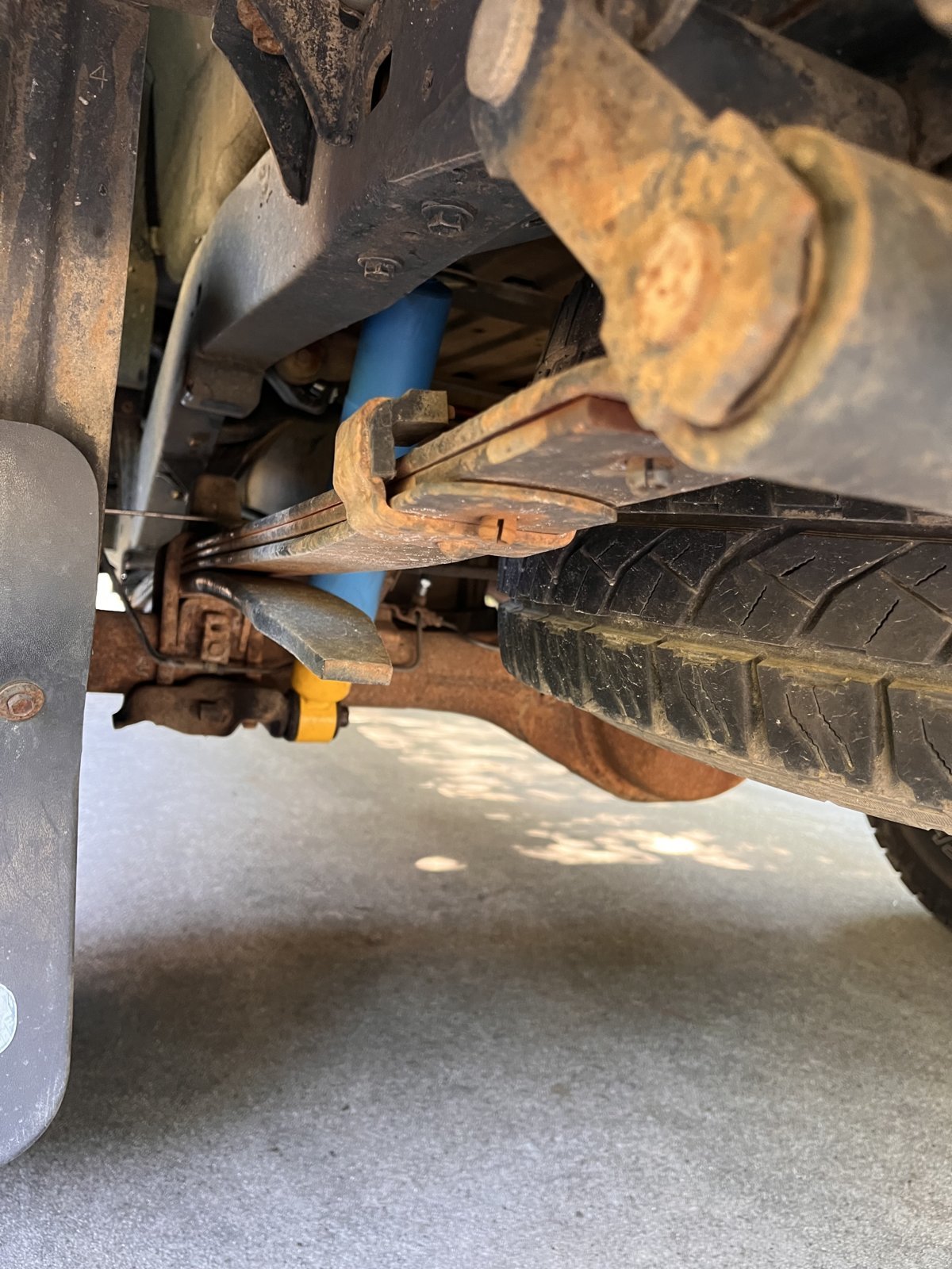

    I’ve driven it about 500 miles to let things settle out, and there is an obvious 1.5” sag in the rear. The leaf springs are original to the truck and obviously worn out and laying flat with zero load in bed. I’m assuming new leaf springs will solve this issue. What is the preferred replacement spring? This is a commuter truck, just want something good/reliable and somewhat pocket friendly.

    Most will say General Springs. But if you look at the part numbers on a site like Rock Auto and compare them, most of the rear leaf springs sold by the other typical suspects (dorman, etc..) all have the same part number. So pick whoever will ship them to you for free :notsure:
    Keep in mind, that while you are replacing the leaf springs, that you'll need some new hardware as well. U-Bolts are a must (they are single use), but just looking at your photos, you'll probably want new hanger hardware and new shackles and pins as well. Just look around for stock height replacements for that stuff, should be easily available.
