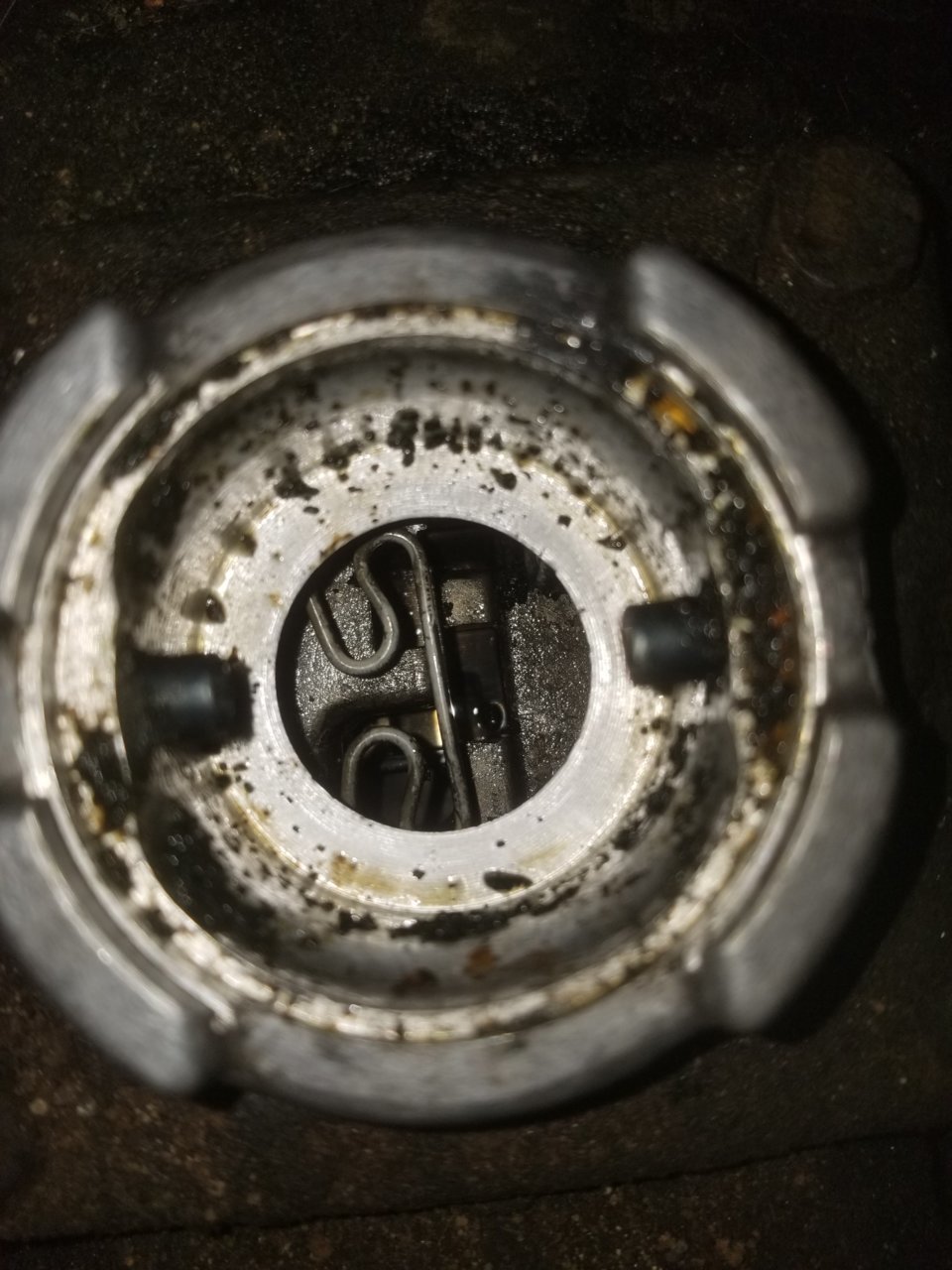

    If you can take a good picture looking down in the transfer case( shifter removed) we might be able to see something you don`t.
    It sounds like something is not physically allowing it to pull all the way into 4 High causing it to not engage making the noise.

    I was going to use a shop vac to get the loose pieces before I pull the paper towel out so I don't get a bunch of crap down in my transfer case. Give me a few and I'll post a pic after I do that. Thanks.

    Is that picture good enough?

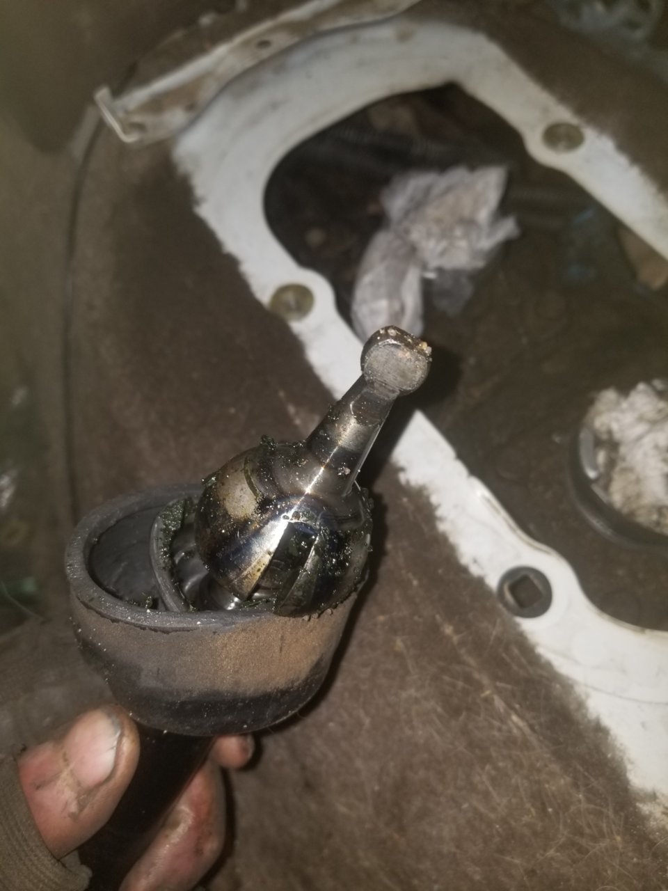

    And this is the bottom of the selector lever

    Yes it popped out ! It has been so long since I had any of those apart I need to look How it goes back together.

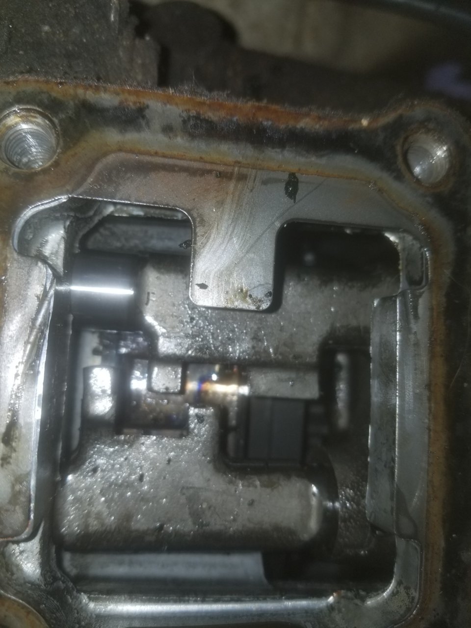

    Here's a better picture.
