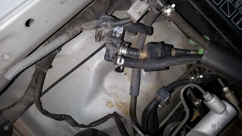

    that and the "toyota VSV tick" that sounds like a god damn rod knock
    eon_blue[QUOTED] likes this.

    If you mounted the VSV on rubber cushions do you think it would help?

    Where exactly is the VSV mounted at?
    Thanks.

    One that likes to tick (intermittently alot times) is the one for the evap system. They moves it around a but but its probably near drivers side of engine bay.

    Mine is mounted to a bracket on the drivers side inner fender well. It's already rubber mounted. Prolly why I don't hear it..

    Youd hear it if it was acting up
    Something like this
    https://youtu.be/jn1OoNB28DE
    Or
    https://youtu.be/wlLB2-VgPuM

    Hory chet. Is this the noise that has been absolutely driving me nuts but is so random? Wait a minute... I haven't noticed it anymore. It only did it at freeway speeds and during the summer. As temps outside cooled, it hasn't done it in a long time now. Crazy, really? That's the vsv? The one to the egr? I swapped in a new Aisin one over the summer. Hmmmm...
  20. Jan 12, 2017 at 6:48 PM
    #20
    cruiserguy
    cruiserguy Well-Known Member
    Jul 31, 2016
    #193416
    18,924
    Elijah
    SLC
    2000 ext cab, 2.7L, auto, 4x4
    Oops, just kept reading and now see that it might be the vsv to the evap. Huh.
