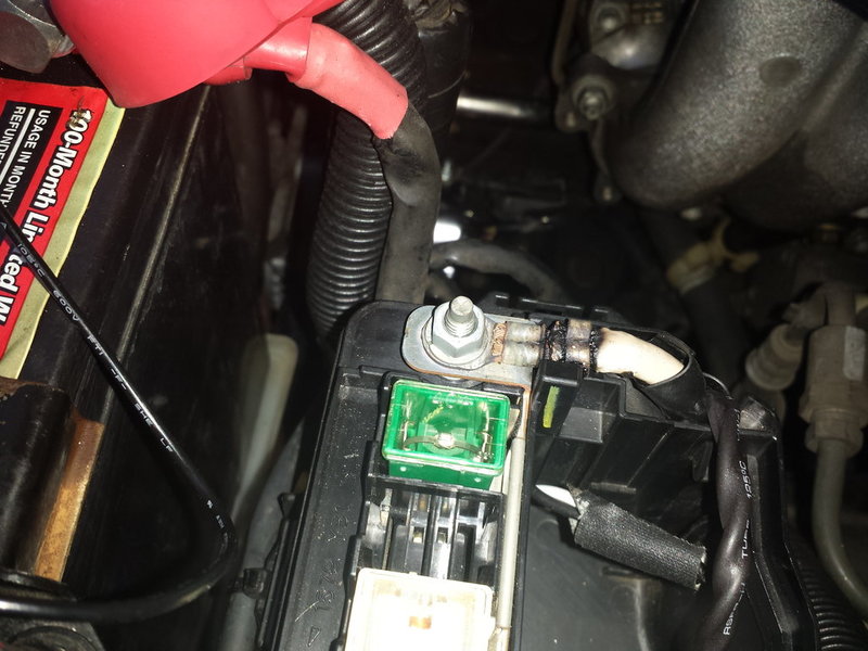

    I went through this same issue, did you do any work involving other electrical items? Check the cable that comes up the outside of the fusebox from the the large loom that includes the main B+ cable. This is the B+ main cable to the fuse box. I had this loose, and it caused the cable to arc and burn.
    Get the wiring diagram out of the FSM. That light comes on only in specific instances. You can trace what the issue is.
