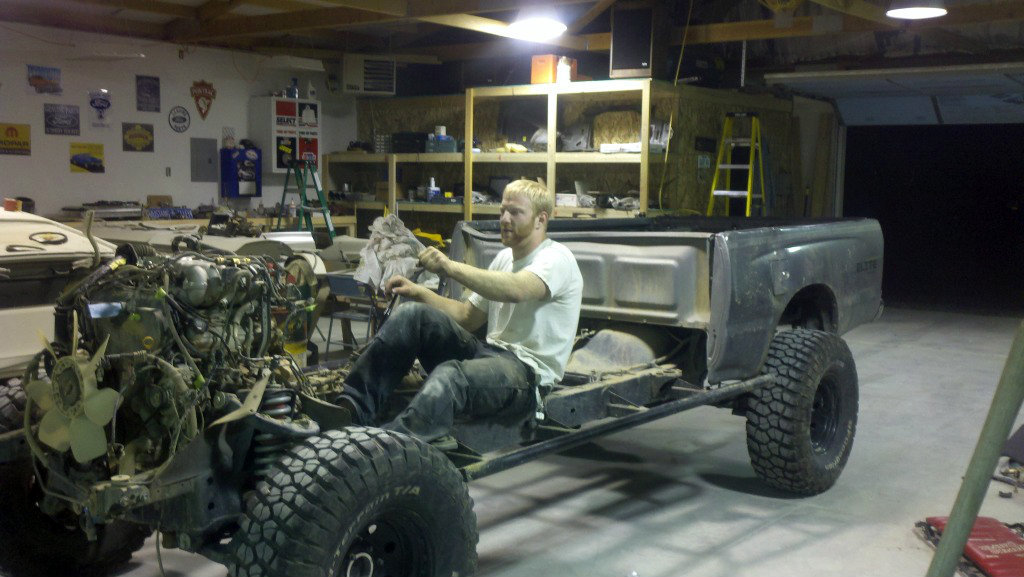

    I just want to put a seat on it and drive it like that! Maybe put some sort of a floor though so I don't get covered in junk.

    haha like this?
