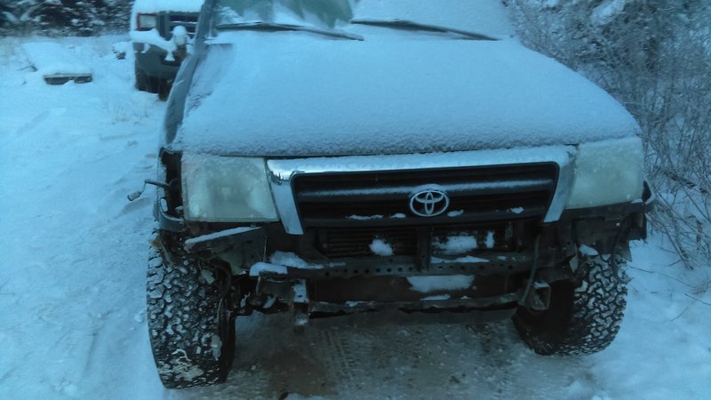

    98 Black Taco, 3.4L, Auto, 4x4 lockers, short cab

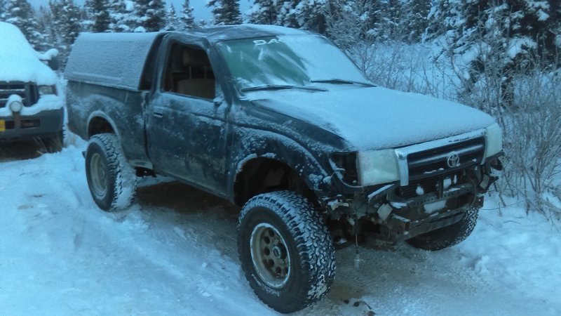

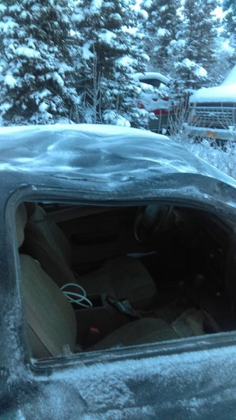

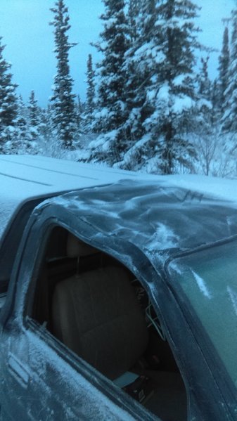

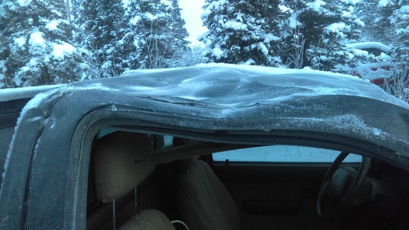

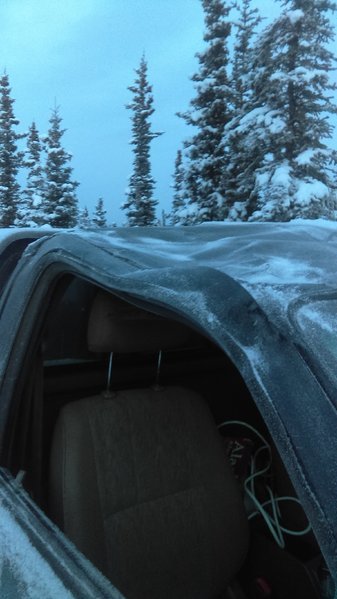

    Rebuilt entire front end steering and suspension, including welding a badly cracked passenger side strut tower. Promptly rolled it two weeks after getting it back on the road. Looking to swap cabs and possibly convert to manual. It's also on a 2 inch lift.
    Alright boys, Montana, Blackdawg. Here we go again. Rolled my black 98 3.4L 4x4 Auto taco. Crimped in the roof just enough to jam the passenger door shut. Body shops want 2K to attempt to smash the roof out and replace the door or 3.5K to swap the cab. If I can find a cab for as cheap as you did and you are willing to coach me through this I'm totally down to do the swap myself. Looking for a cab now, but I wanted to put you boys on deck. I might do a manual conversion as well if I'm going to all this trouble, that was my only complaint when I bought it.

    Ps use your trucks factory bottle jack and a few chunks of wood, you can push some roof dents out better than you may (or at least I...) expect. Just put a chunk of metal or 2x10 under the bottom of the jack to distribute the force on the cab floor. Won't be perfect but will be better. Not sure how successful you will be on the door frame though.
