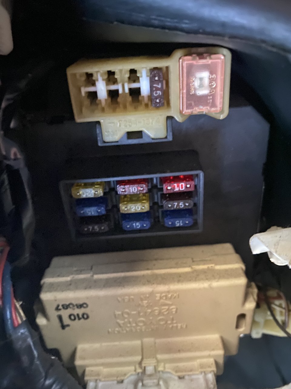

    Okay, so he’s some pics and a vid of what I got going on. I have negative terminal disconnected for an hour (excessive probably, I know) with the key in the on position. I connected the battery terminal, and immediately I hear the noise that’s in the video. I included a pic the dash fuse box too. Maybe there’s something I’m missing that y’all may see?

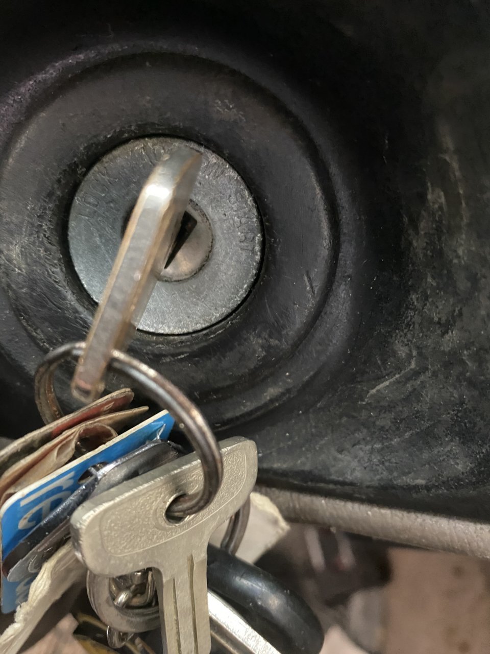

    Another additional piece of info, I’m not sure if locking then unlocking the driver door was able to reset the security system. However, my luck has it that the key only locks the door and won’t unlock it. Works perfectly fine on the passenger door, just not the driver door. Graphite spray maybe?

    That's aftermarket.
    You have to take the panel off to see what they spliced into. You'll be looking for where the wires go, and then looking for a model number on that unit.
    I'd also bet there is a bypass button hidden somewhere. Did you check out the fuse interior block?
    And your key doesn't work because either the key or the lock cylinder pins are worn.
