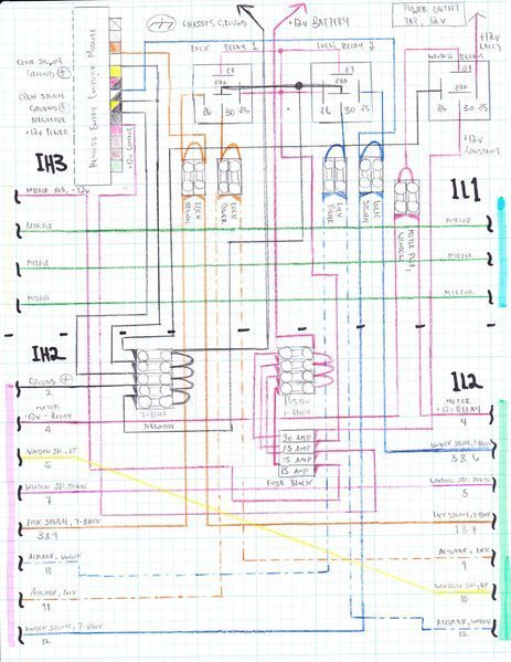

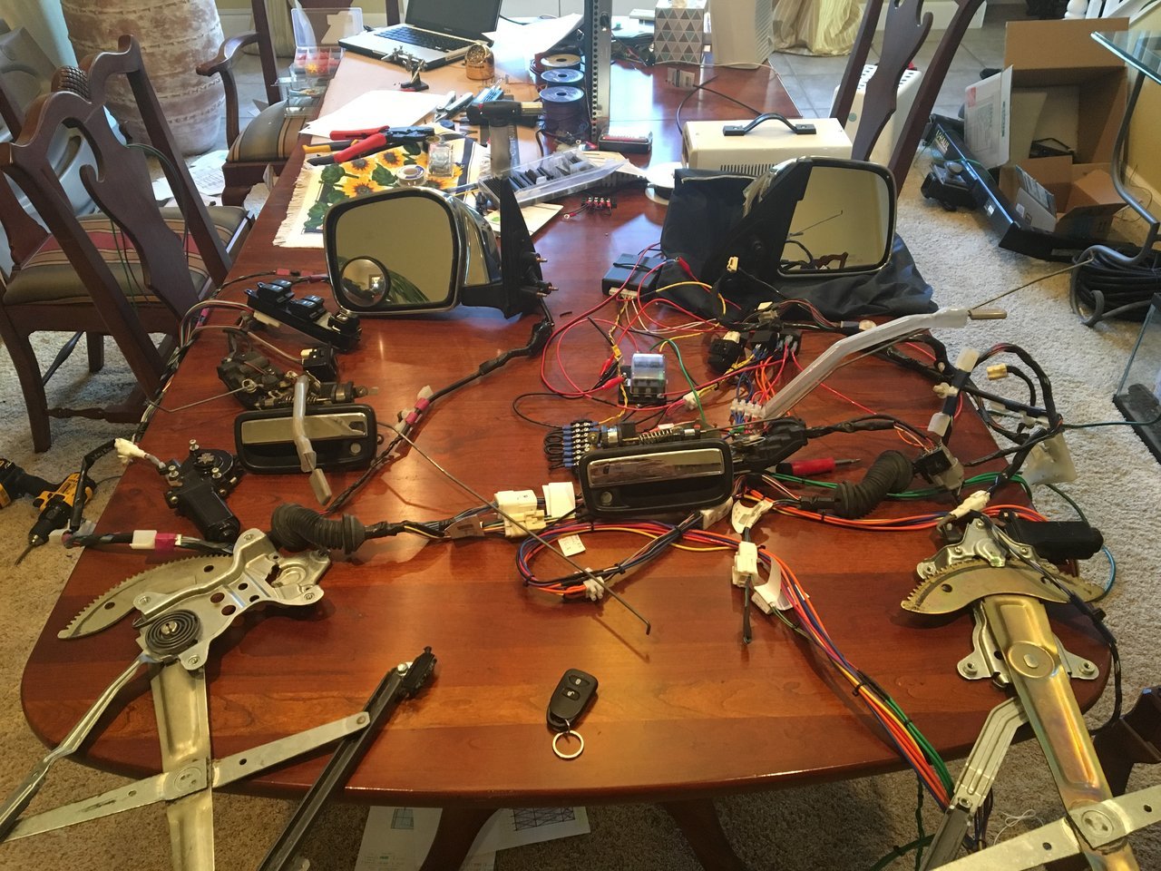

    It's a ton of work to adapt it to work with the factory harnesses. With some help I made a complete relay/power control system that adapts to the factory door harnesses. Took me months of staring at Toyota wiring diagrams, troubleshooting, and testing everything. If you wanted to do it yourself you better be good at 12v electrical. It's not for the faint of heart. Here is my build thread on how to do it.
    Here is the main wiring schematic of how my system is hooked up.

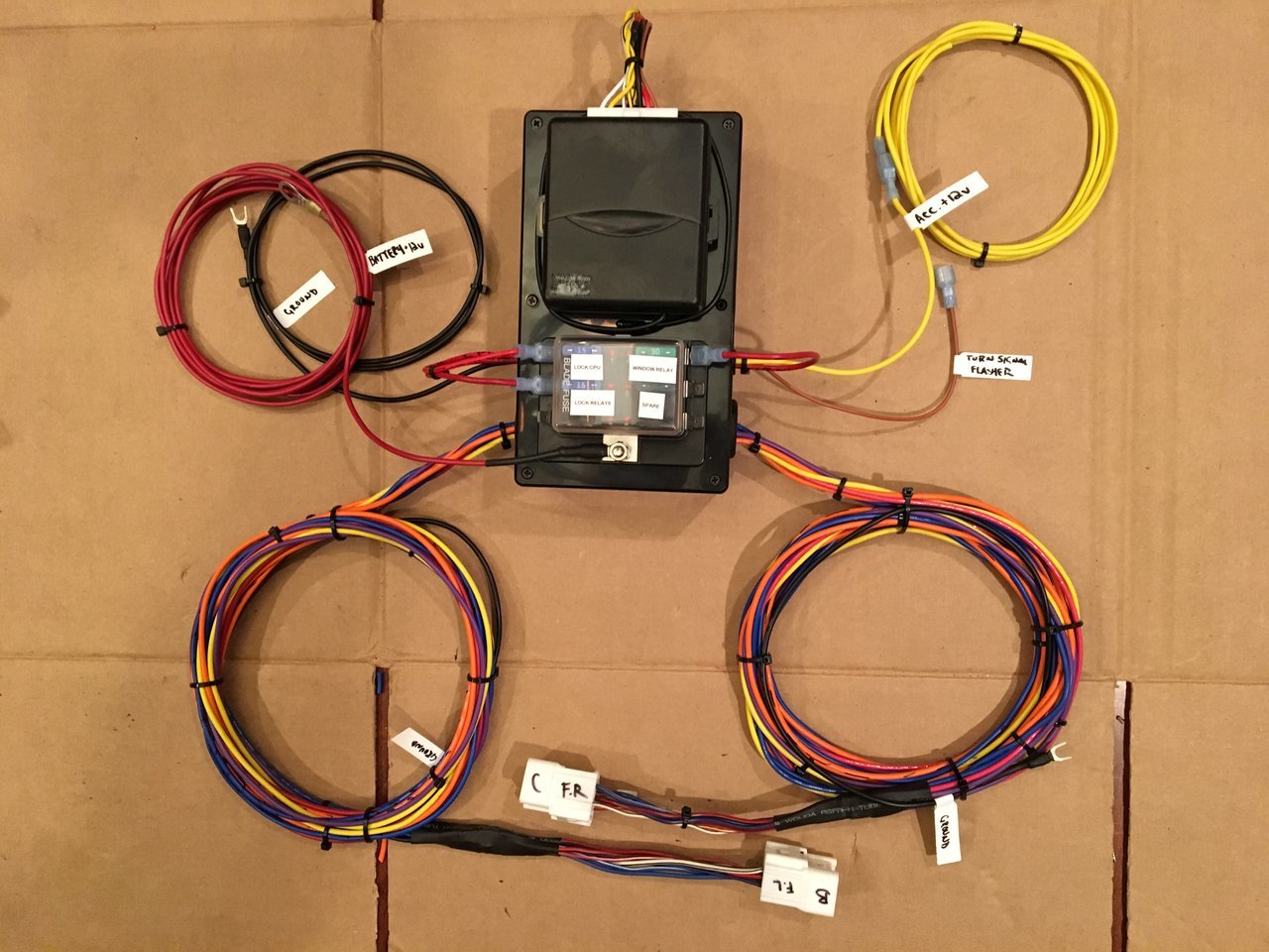

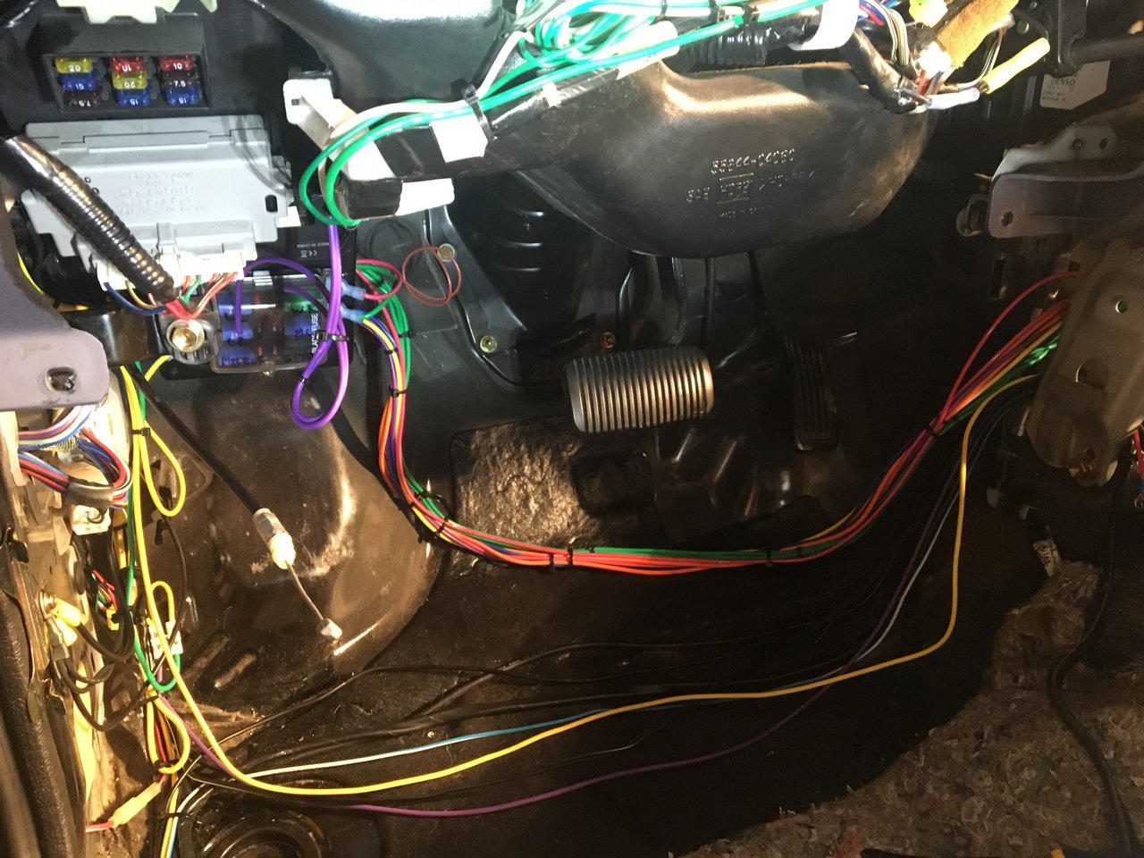

    I can make a harness, if you want. I've made a couple for some people. They plug directly into the stock door harnesses just like it would at the factory.
    The relay control box mounts where the clutch pedal assembly would go on automatic trucks.
