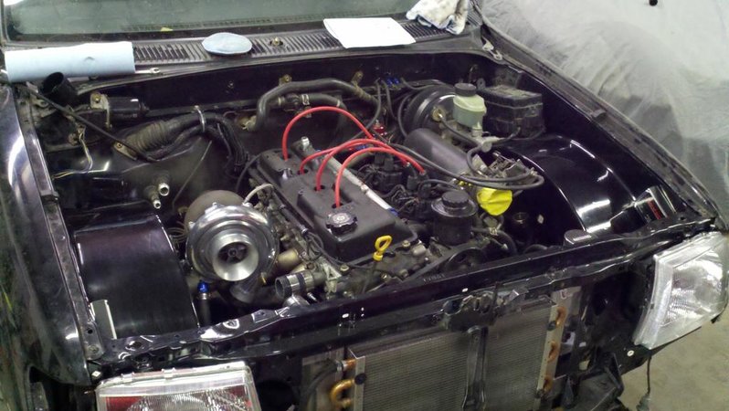

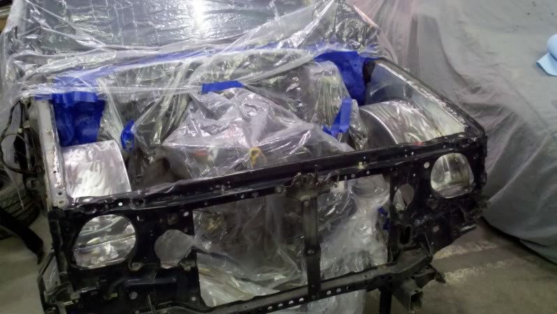

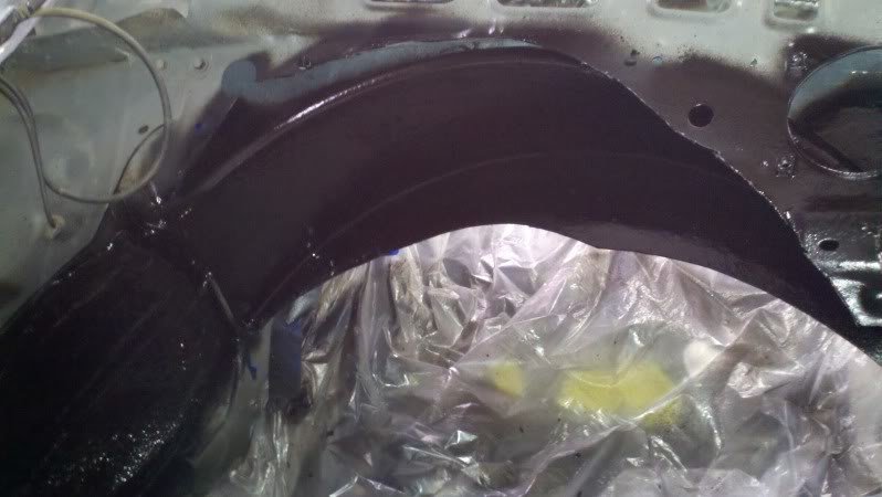

    Just finished up getting the wheel wells cut out and replaced with trailer fenders. Sprayed the underneath with a rubberized undercoating.
    Plans this week:
    spray engine bay
    install intake mani, exhaust manifold
    fab backdoor style intercooler
    finish polishing WG, Rad, catch can

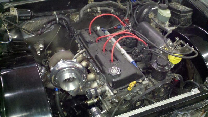

    Might as well throw up a current mod list
    Engine:
    2.4L stock block
    ARP headstuds
    Cometic MLS headgasket
    S@nt0s T4 turbo manifold
    SpeedFreek FF intake manifold
    Turbonetics 62-1 .70/.96
    Delphi 1000cc injectors
    Paradise Racing -8AN fuel rail
    Aeromotive FPR
    -8AN Braided Feed
    -6AN Braided Return
    Walbro 255
    Tial 50mm BOV
    Tial 38mm Wastegate
    -10AN Catchcan setup
    Oversize aluminum radiator
    Haltech PS 1000 engine management
    LS1 ignition coils
    MSD 8mm wires
    3" intercooler pipes
    FMIC
    Drivetrain:
    IPT valvebody
    2500rpm stall
    Upgraded clutch packs
    Ford 8.8 rearend 3.73/LSD/Disc Brakes
    SpeedFreek Trac-Bars
    Front Suspension:
    BJ Flip
    Eibach springs cut 1 coil
    All poly bushings
    Rear Supension:
    Beefed 4.5" blocks
    Middle leaf pulled
    9/16" U-bolts
    Theres a lot more, interior. etc...

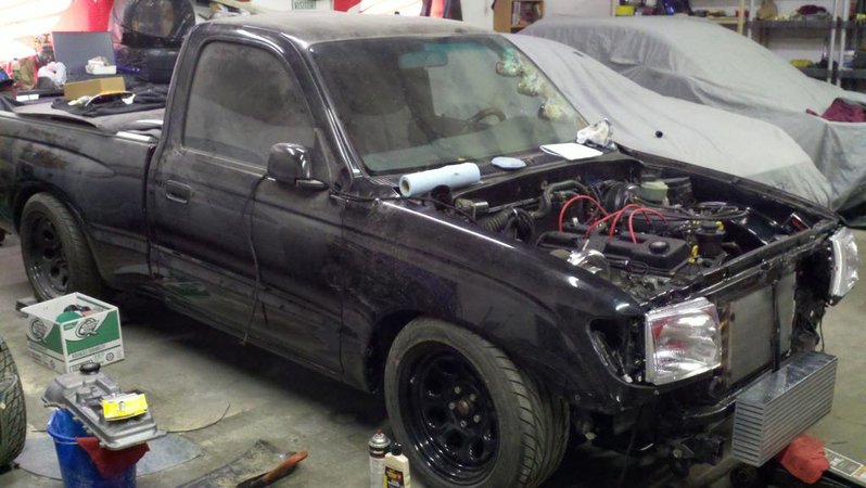

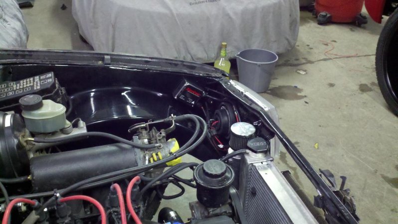

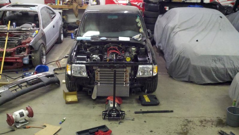

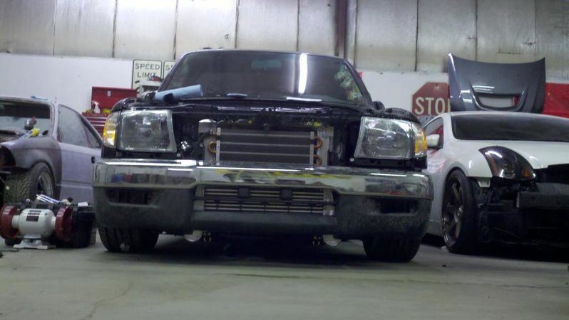

    Piecing it back together!

    Left on the list:
    Wire trans temp and fuel pressure gauge
    Finish steering wheel gauge pod
    Wire 2 grounds, fuel pump power, ignition signal
    Fabricate intercooler endtanks and intercooler piping
    Weld temp bung in rad pipe
    Weld new -10an bungs in valvecover
    Bolt down bed
    Install bumper and grill
    Install Trac-Bars

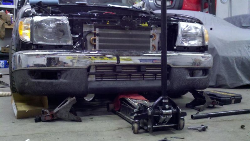

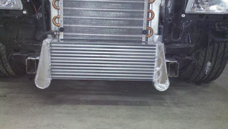

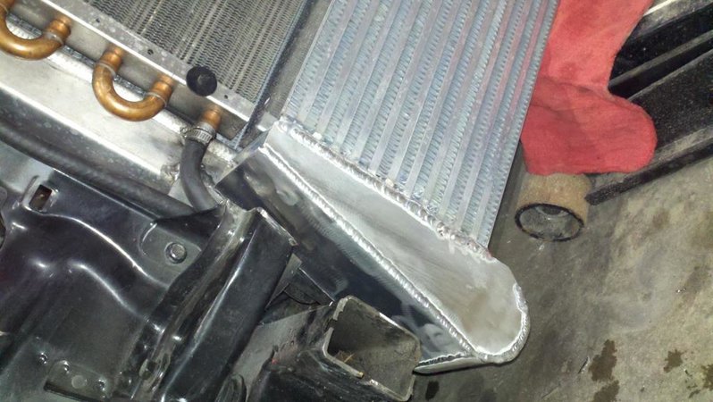

    Workin on the endtanks.

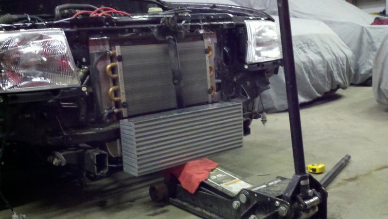

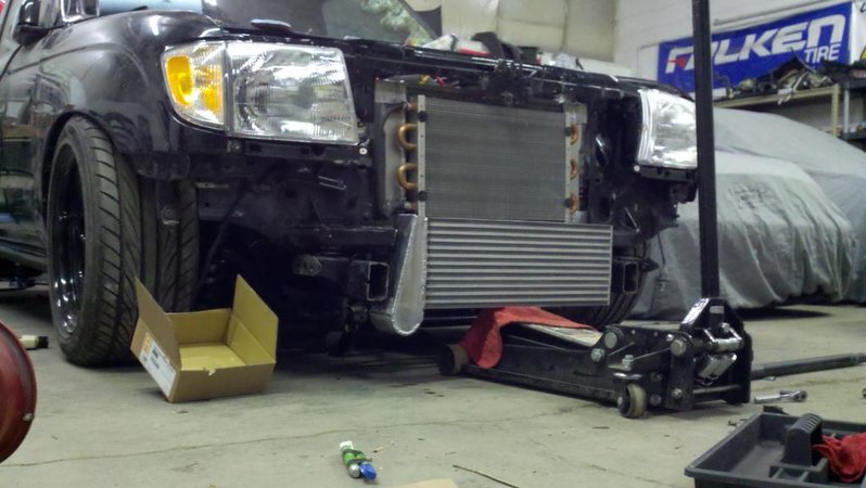

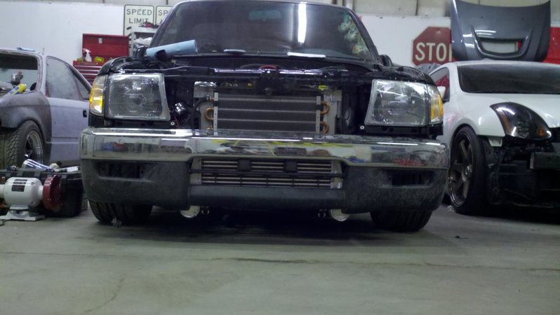

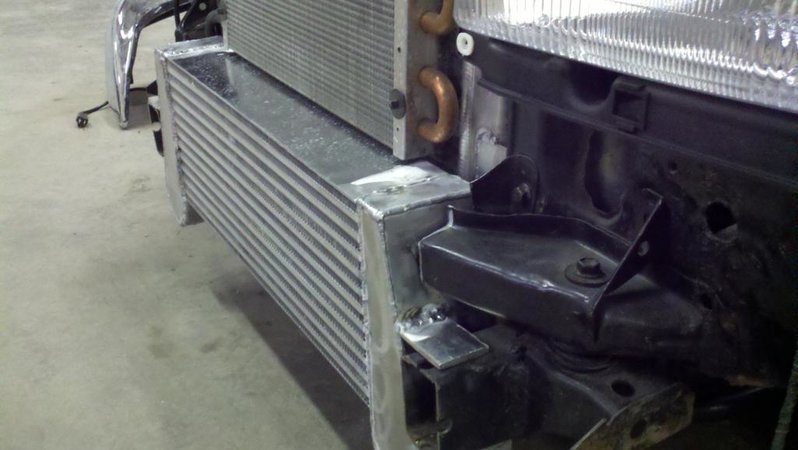

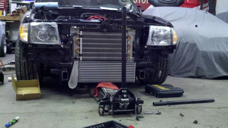

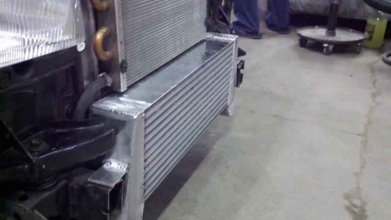

    Finished intercooler, Just need to pressure test.

    heck ya, love boosted tacos. New intercooler is a 100x cleaner work.

    Daily driver. Maybe hit up the 1/4mile once or twice this year.
    Pressure tested the intercooler and filled all pinholes. Checks out good.
