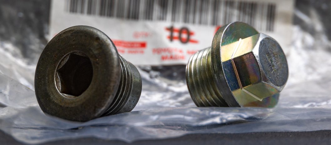

    The Amsoil bags make it soo easy and you can reuse those bags , no pumps needed,
    Don’t over fill the front diff tho, it will push out the breather valve if you put to much in.
    Be careful and don’t strip out the lower Allen drain bolt too,
    You can get an Lexus bolt head replacement instead of the Allen type
    Reney[QUOTED][OP] and turbodb like this.

    Here's the info on the Lexus drain/fill plug replacements for the front diff. These things are pretty great:
    A Front Diff Drain (and Fill) Plug that Doesn’t Suck
