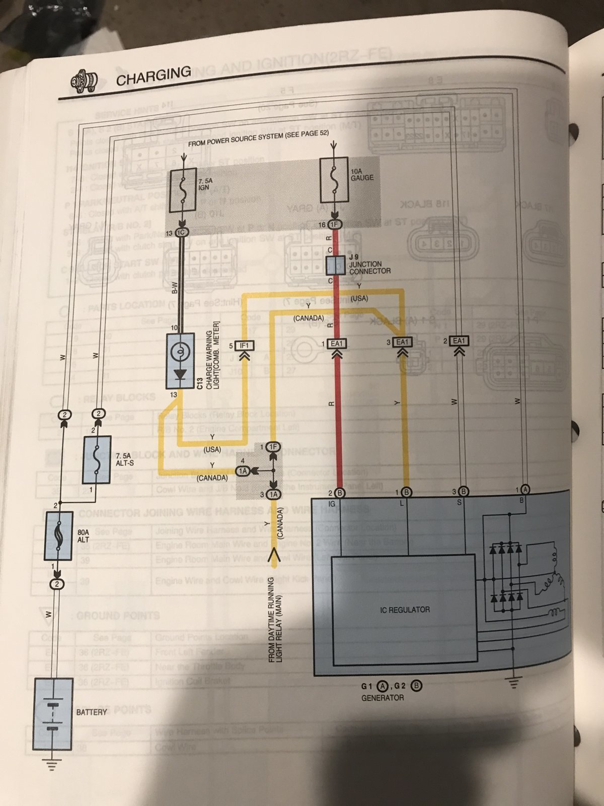

    Tabitha, attached is the charging circuit for your truck. You want to check the 2 fuses first. The 80 amp ALT fuse is in the engine compartment fuse box and is bolted in. Not to difficult of a job. The ALT-s fuse needs to be checked too. Accept my apologies in advance… do you know how to use a test light and/or a voltmeter?
