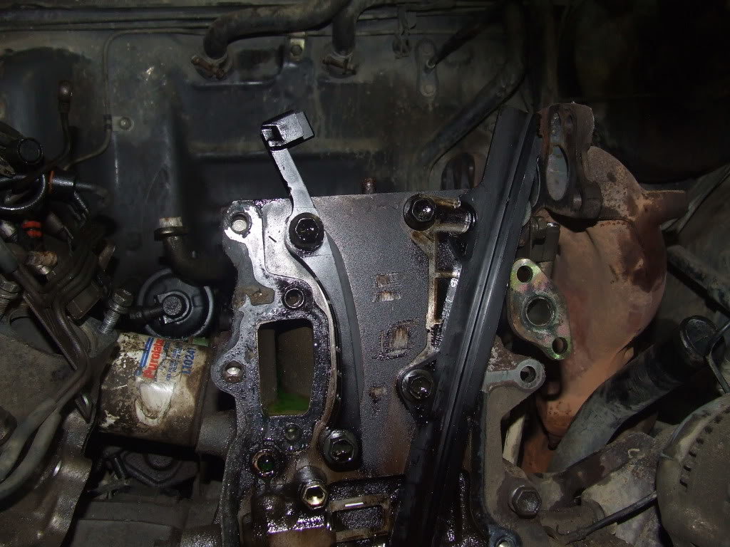

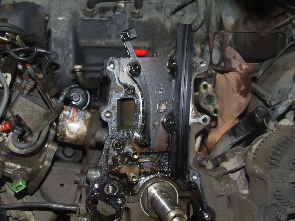

    Note the right guide. The top of it is broken and the top bolt hole is also broken.

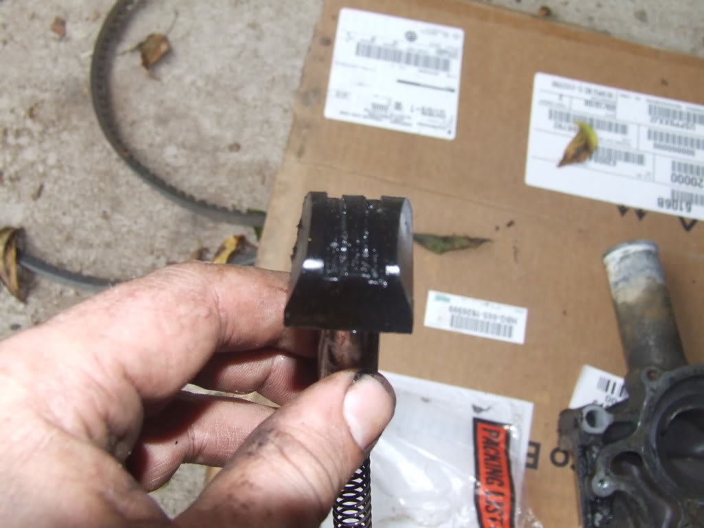

    This is the chain tensioner. Note the two grooves from the chain. Also, this is note supposed to come out of the body. The rear retainer (plastic) is broken. This truck has 127K on it. That is not bad for an 88. The chain change interval is 90k. You can go much longer but you will be flirting with disaster.

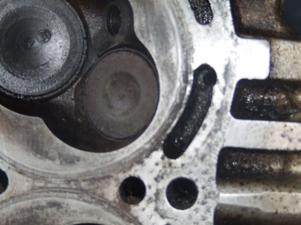

    This is the #1 cylinder of the head. The seal on all four cylinders of the gasket were cracked.

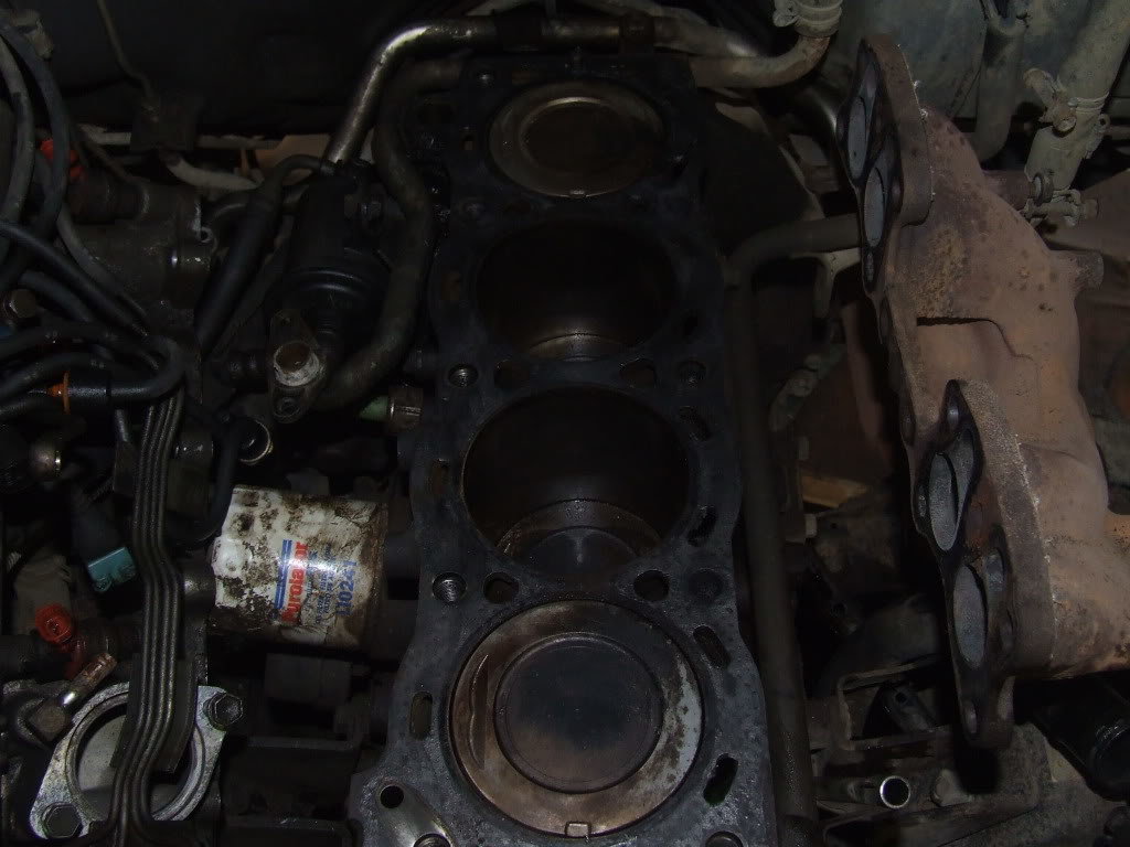

    The head is aluminum so it will need shaved and cracked tested. The last time I hade that done (10 years ago) it cost over $200. I found a bare head on ebay for $61 shipped and bearings at AA for $33. Plus I have $70 in seals, gaskets, and timing chain kit.
    These trucks are relatively cheap to rebuild if you have the knowledge.

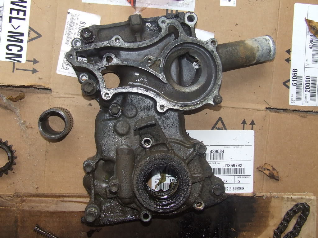

    The timing chain cover/waterpump housing.

    Wow, I think I need the clean the lens............ :eek:

    picture taking tip for the redneck in you:
    when taking pictures of something close up, change the camera to macro focus instead of normal focus.

    Would that mean take it of the "A" setting and put it on the "Flower" setting?
    :eek:

    yeah, the flower is macro.
    now go retake every pic so we can see shit, Ben! :p
