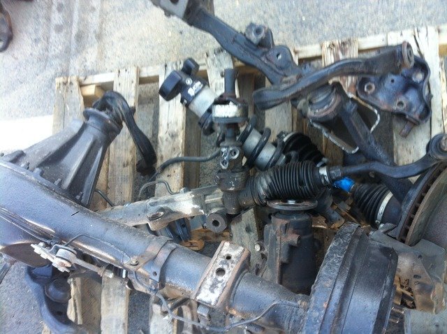

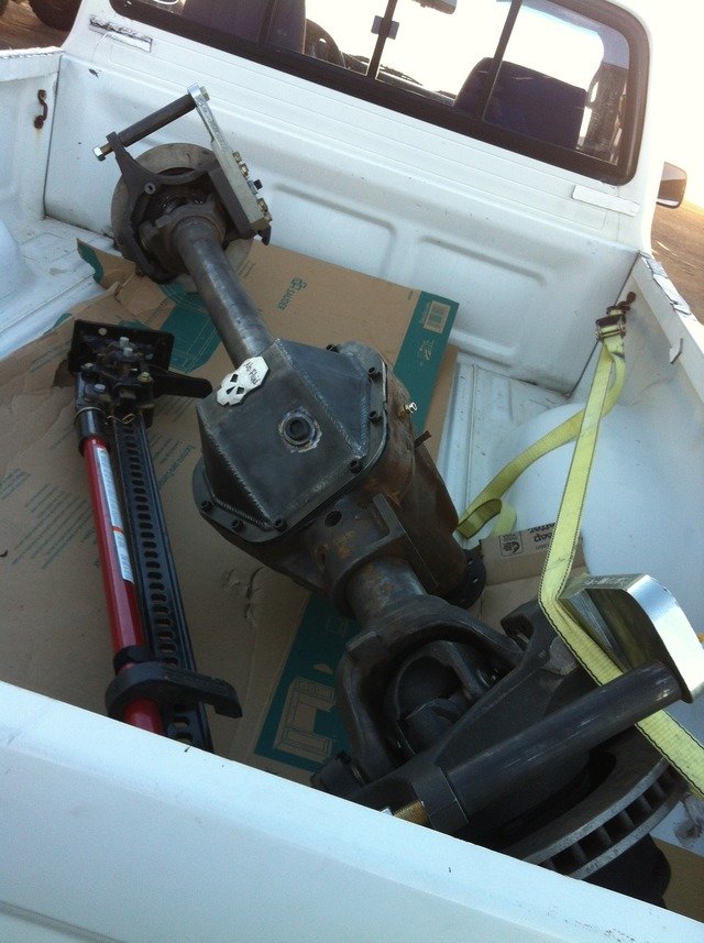

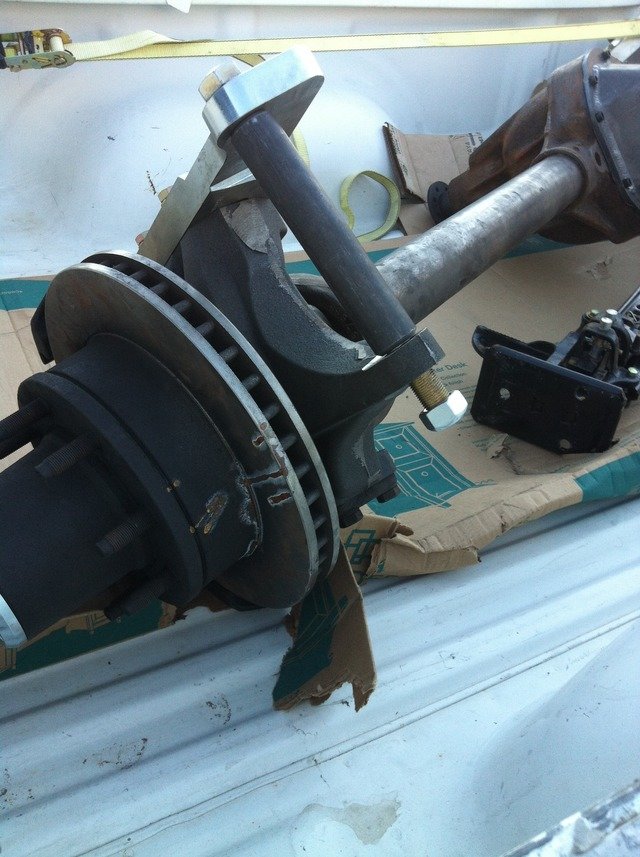

    That's a really heavy axle:eek:
    C55EC24C-5003-4DE7-B58B-69A74AD43F8F_zps_c3a0cd3e0e36828a506a1a1da15d99388b3dfacc.jpg

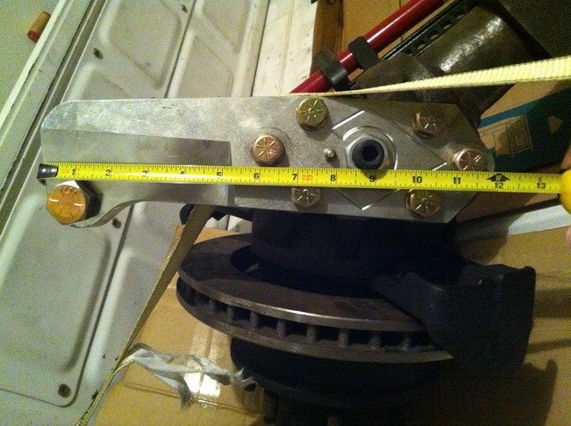

    The steering arms are massive, close to a foot long.

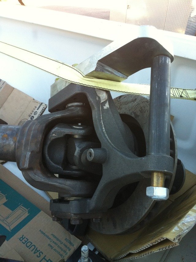

    Yukon super joints

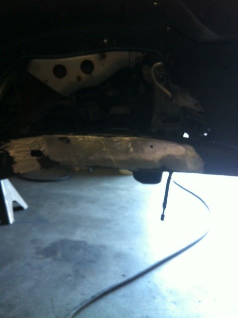

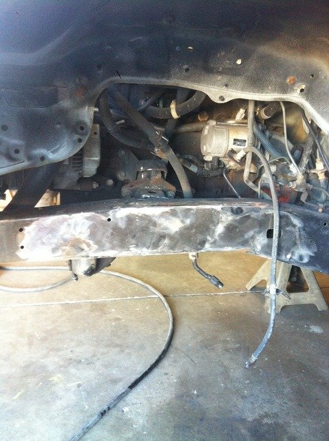

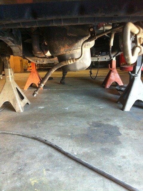

    Point of no return: IFS's gone! Oil pan conversion will be next.
    212DB738-3ED0-4371-9F47-869E79B65BE3_zps_e30f0c8582f33997b54273c064c1ad21a68a979a.jpg
    Frame driver side cleaned up

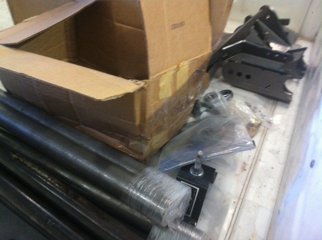

    Pile of new parts waiting to be installed: DOM tubing, brackets for link suspension, shocks, etc. The big box in the middle is the Atlas.
    ECBCFB9B-7079-4F41-AD56-F7E327332C62_zps_f2a6758b49be0767b23a08d06e2aea6488002658.jpg

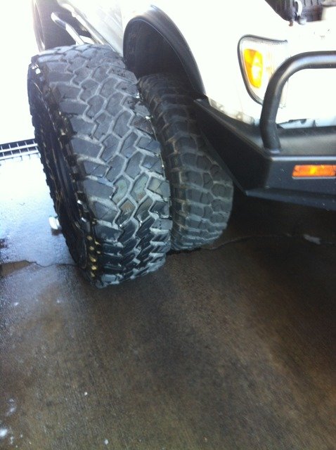

    Unmounted 40" tire next to the 33" it will be replacing:

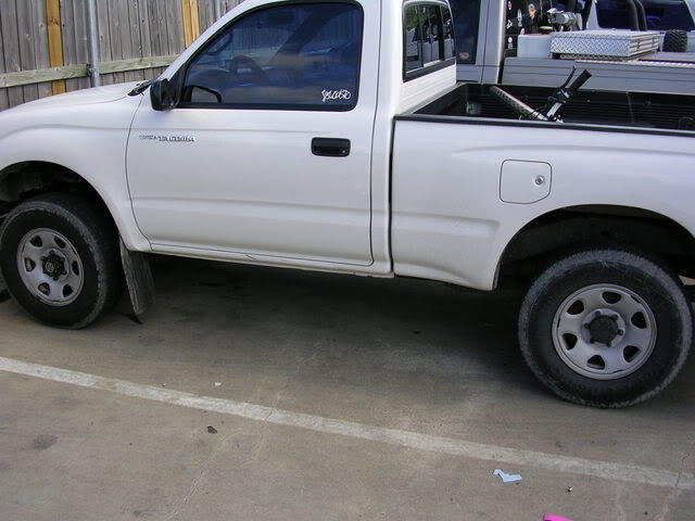

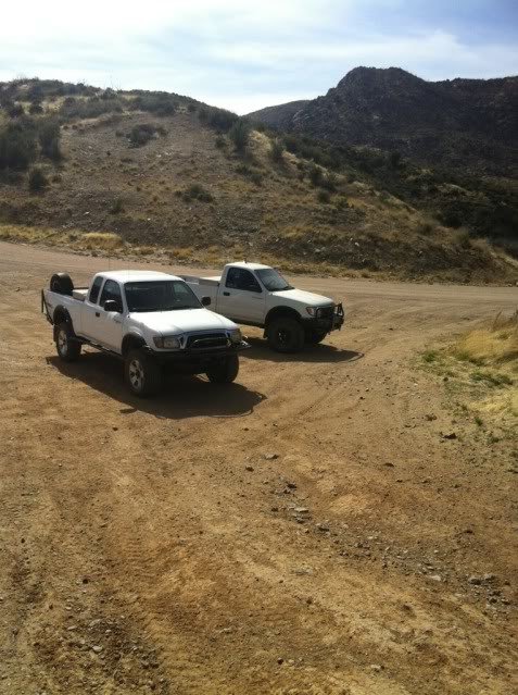

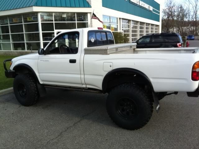

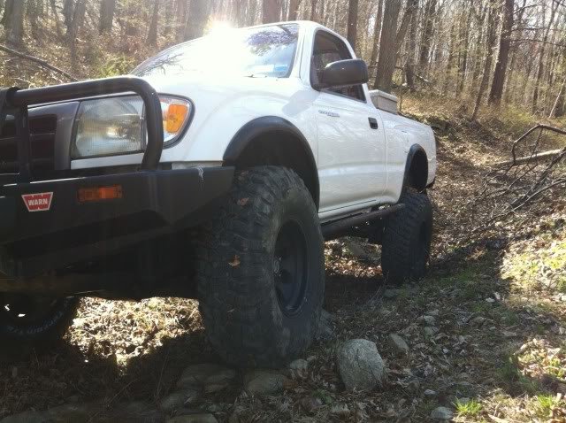

    I haven't been back to the shop to take more pics. As I wait for more updates, I decided to share a little bit of the evolution of the truck and the things that led to the SAS up to this point.
    This is how the truck looked like when I first bought it. Crappy factory suspension, little tires, fugly steel wheels, CRAPPY 3.57 gears. But it was a 4X4, so I started wheeling it like that lol:
    Then I installed a lift kit that consisted of a spacers upfront and add-a-leafs in the rear. Got alloy wheels and 32X11.50 BFG all terrains. That kit was the worst piece of shit ever and a total waste of money. Made the already crappy factory suspension stiffer and it flattened the rear springs. Also added rock sliders and a 1" body lift and regeared to 4.56. That made a HUGE difference in spite of the terrible suspension:
    Wheeled it like that for a while added a front lock right locker - since I had manual locking hubs. The rear axle remained open for a while. But it did surprisingly well with the front locked only. Then tried other variations of crappy suspension lifts (more money wasted), wheeled it for a number of years more, etc.
    Then One day I decided to man up and build the truck right finally: IVD coilovers up front with Allpro 3" leaf packs in the rear, 33" BFG KM2s. Also got an ARB front bumper and AllPro rear bumper. Man, what an incredible difference. Should have done that from the very beginning:
    Moved to the southwest because of work and realized that wheeling without a rear locker in AZ was NOT going to cut it anymore. So my good friend here in town Ken ("ZUK") installed a lock right locker for me. He also checked everything for clearances, did an overhaul and brought everything back to better than factory specs. That was one solid rear diff:
    4A7BE7A4-0FA4-4168-9E06-24A493FBB46E-125_4263a092cd004ef1d999d3d4f8ecf34fa6efe896.jpg
    1A2A75C2-E970-449E-B311-DA69C4D4060A-125_ffba4fba1fc4ea4b33f5f8b19486bfaa285cba2e.jpg
    Wheeling with front/rear lockers and manual hubs was AWESOME, and the truck had a much better stance with the right suspension components:

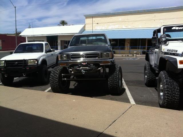

    I went on some wheeling trips with Ken. With front/rear lockers and a good suspension, now I was able to tackle more challenging trails.
    Ken's truck next to mine at Crown King, which is a very popular wheeling trail here in AZ; it's over 20 miles long. This pic is before he did his awesome SAS:
    82F76A85-1733-49B3-8C72-A0B77D792FF6-119_0cedc7fe6f2c3ed4fe36118e8c723d22a3448b20.jpg
    Besides being a pro gear installer, Ken ("ZUK") is a very experienced wheeler. Ken's truck (prior to his SAS) at Hackberry Trail near Superior, AZ. It looks significantly different now with the SAS
    My truck next to Craig's (another good friend) SAS toyota. He built his toyota with link suspensions front/rear by himself. Also did a V8 engine swap. His rig is awesome and certainly and inspiration to do my SAS. My 33"s look tiny next to his 37"s :D
    Anyway, that's the summary of the different stages the truck went through up to this point.
