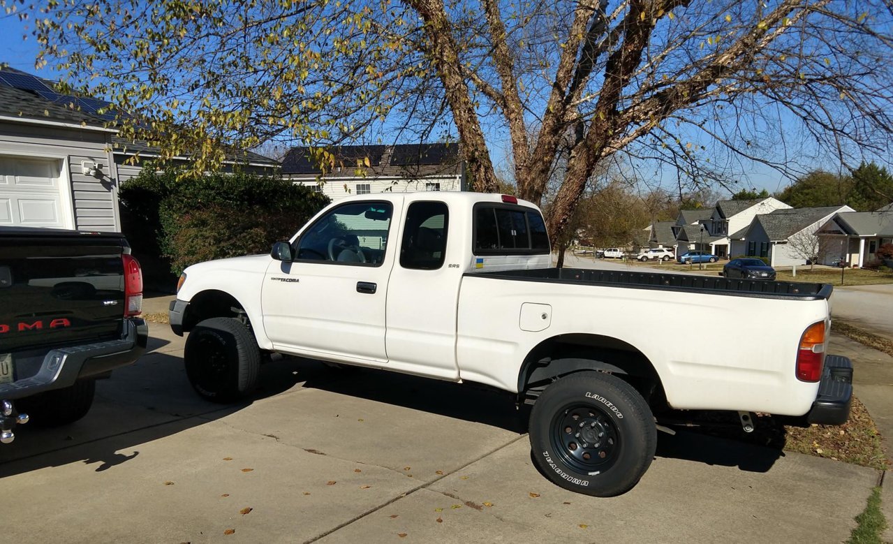

    Good information shared above. I wouldn't be too hesitant to throw a little $ into it as these Trucks/2.7 engines last a LONG TIME.
    My 96 2.7 has 415,000 trouble-free miles on it.
